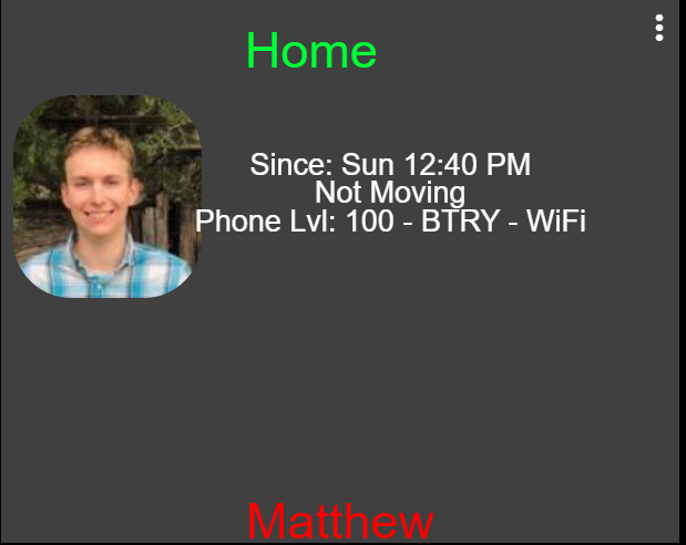

My mods...
#tile-38 .tile-title {
position: absolute;
bottom: -10px;
color: #ff0000;
font-size: 30px;
#tile-38 img, video {
border-radius: 35px;
max-width: 120%;
height: auto;
vertical-align: -139px !important;
#tile-38 .tile-primary p {
position: absolute;
margin-left: 11px;
margin-top: -26px;
line-height: 17px;
#tile-38 .tile-primary a {
font-size: 30px !important;
color: #00ff37;
position: absolute;
left: 15px;
width: 310px;
margin-left: -100px;
margin-top: -61px;
line-height: normal;

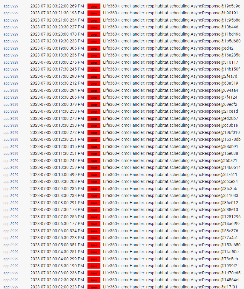

Hi Everyone,
In reviewing HE logs, l am recieving the following error messages
Life360+: cmdHandler: resp:hubitat.scheduling.AsyncResponse@c3adc1
Could someone please advise as to how to fix this error?
Thanks in advance
Me too. It happens occasionally.
It looks like it's logged when there's a connection problem fetching data:
    if(resp.getStatus() == 200 || resp.getStatus() == 207) {
        result = resp.getJson()
    } else {
        // connection error
        log.error("Life360+: cmdHandler: resp:$resp")
I could probably change the logging so it prints out the response code and any other useful details

Hi,
Have you been able to progress any further with this reported issue? If so, could you kindly suggest what we need to apply to have fixed?
I see a bunch of similar errors from 2:27 AM to 2:41 AM this morning but that's it. That would lead me to believe the Life360 service goes down from time to time (maybe even a scheduled downtime)
I wouldn't worry about it if it's not happening too frequently. This app polls the Life360 service every 30 seconds which is 2,880 checks per day.. so if most of them are working I think things are going pretty well. This isn't a public API either - the app is just pretending to be a Life360 client so I'm just hoping they don't find a way to shut it down. I don't know how the official Life360 app works -- it probably doesn't poll the API as often as we do though as it could use something else like push notifications.
I'll log more info about the error and test it out but I don't expect there to be any other kind of 'fix'
FWIW - I still haven't seen a connection failure since 6/27 @ 2:41 AM.. I made a few local code changes to see what the error code was but haven't hit it yet.
Unfortunately, I'm seeing these now every minute going back several hours at least, possibly further.

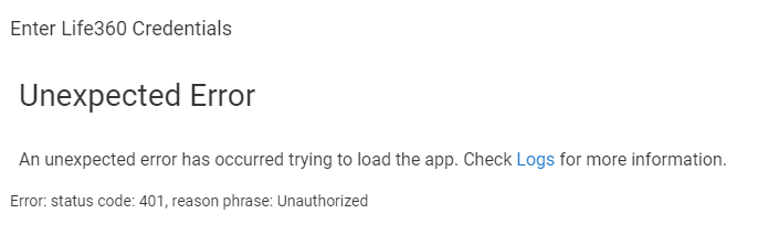

The errors continue every 30 seconds. Looks like I have the same issue that @lcw731 had. My credentials haven't changed, so maybe Life360 is blocking me now?
My next step would be to reauthenticate, but I don't have that opportunity. Is there a way to logoff and login to Life360 without removing and installing the app? If I must reinstall, is there a way to preserve the child presence devices throught that? I don't think Swap Apps will work with a child device.
I wish I could help. I went up going full nuclear, uninstalling the old app from Hubitat, plus my phone, and reinstalling everything new. ow everything works great.
I reinstalled Life360+ in Hubitat, but first created virtual instances of all the presence objects, then changed any presence-related automations to use those instead. The virtual presence objects mirror the Life360+ child devices. This way it will be much easier to grip and rip next time, or if I change presence apps.
Didn't need to do anything on phone app. All is working fine now with no authentication failures.
