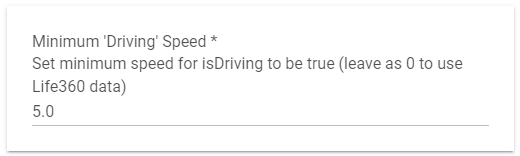

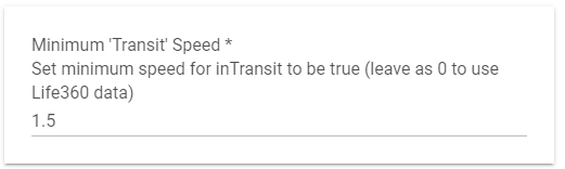

If you provide non-zero values for 'Minimum Transit Speed' and Minimum Driving Speed' in the driver's preferences it will use those to compare to the 'speed' attribute and adjust inTransit and isDriving, overriding the (always "0") values that the Life360 API provides.

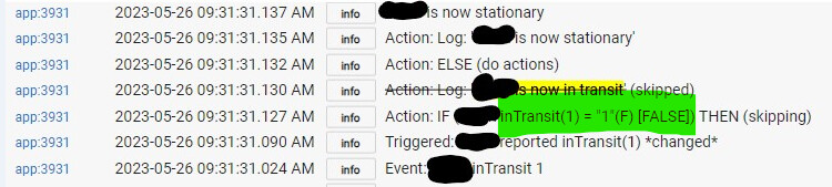

Making some progress. It seems to be working now, although I haven't yet figured out why. I commented out that if block, and I also stepped through all the settings in the Life360 app finding no discrepancies. In the process I found another possible issue with arrival not triggering properly in another rule and this gives me a lot more to look at.

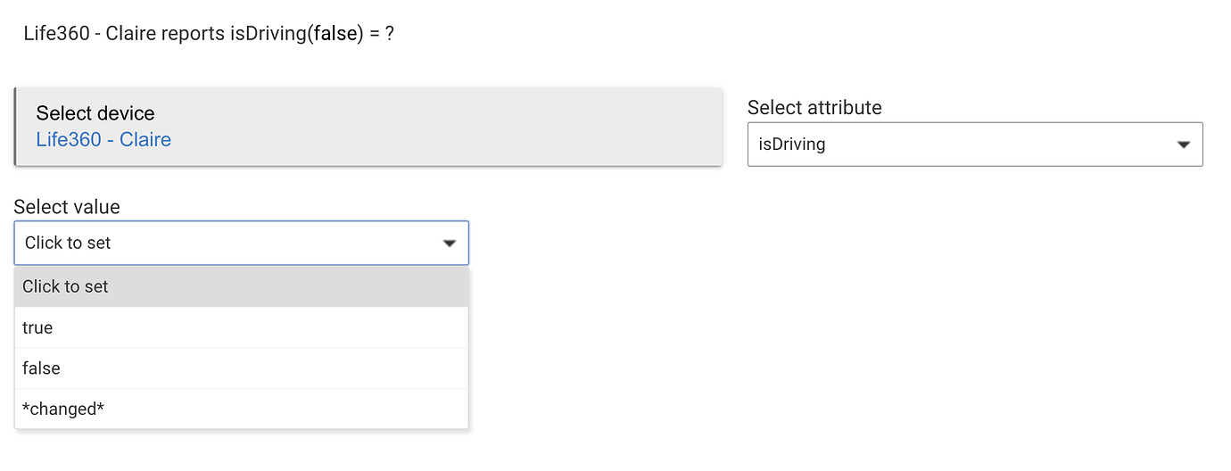

Oh, and regarding the data type of isDriving and inTransit, I had to go back to comparison to 1 rather than "1" and that part is working. I guess the text compare was literally looking for the quotes, so that way didn't work (see green highlight below)

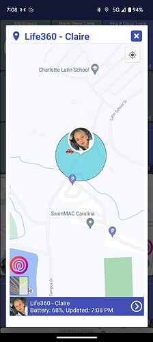

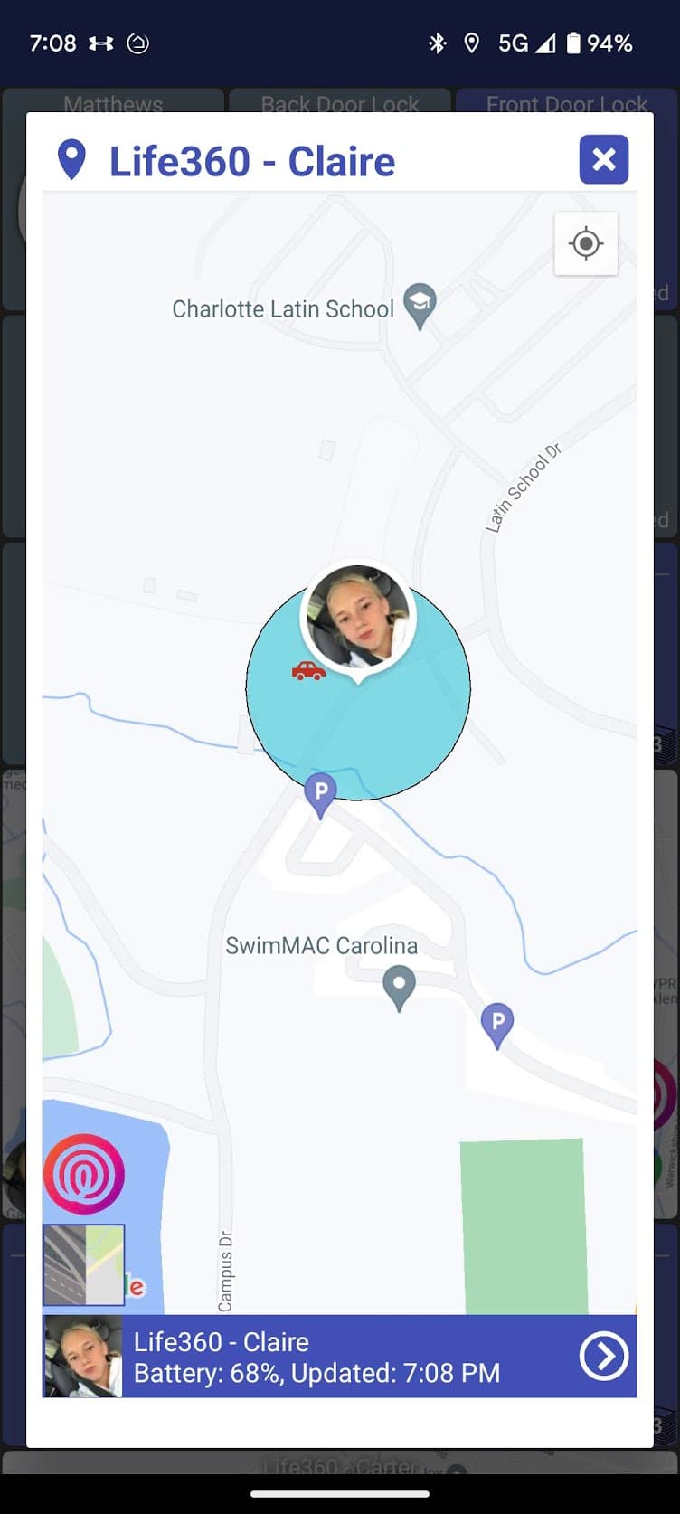

Maybe I'm missing something, but when I select the map tile in HD+ it brings up the map view showing the world map at GMT.
If I press the blue bar at the bottom, it moves to the next device, and shows the same scale but centered on the device location. FWIW, the device location is inaccurate on this screen. Seems like stale data. Shows my wife's location 10 miles off her current location.
If I long press to edit the tile, it shows a view with the life360 device in the center of maybe a 2 mile radius. Current location of each device is accurate.
It does make sense that this would be a boolean (true/false) and not a string (1/0). I'm not sure if it'd cause any problems changing it now with others though but maybe just something to think about for the future

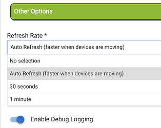

updated - 3.0.14
By default it'll do this 'auto' refresh logic so if you only want every 30 seconds or every minute (new) just open the app, change this setting and hit Done

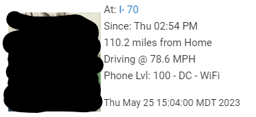

Thanks @jpage4500 for this update, I am using the html tile and it always displays Not Moving even when my kids are driving. The inTransit and isDriving fields always say false so maybe that is why. I did notice that the acceleration field does change so maybe that is a better trigger, your thoughts?
My guess is you have not opened the devices created by the app and entered values for 'Minimum Transit speed' or 'Minimum Driving Speed'. Putting values in there will override the values for inTransit and isDriving that Life360+ API provides. The problem is I have never seen the Life360+ API return anything other than 'false' for InTransit or isDriving regardless of the speed provided.
