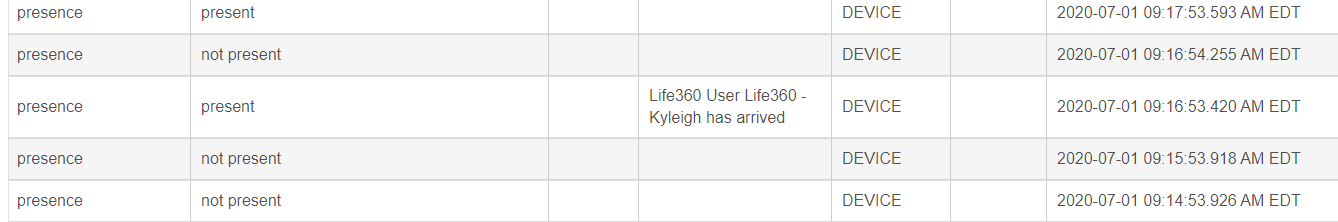

First time I'm seeing something like this:
Arrived but then immediately not present...then arrived exactly a minute after the first.
Had this exact same thing happen to two family members. Triggered arrived, then gone then arrived again. Not sure if this is Life360 side or not...but figured I'd log it here in case anyone else is seeing this. Real suspicious that the bounce was exactly a minute apart.
All the iphones on my account do the that dkubke bounce thing almost everytime. Haven't had time to figure what it is.
Maybe bouncing between cell towers when the signal drops from coming inside?
Shouldn't be. The triggers before the car even gets to the house. I have my circle pretty big, 1/8 mile maybe. I'm going to keep an eye on it.

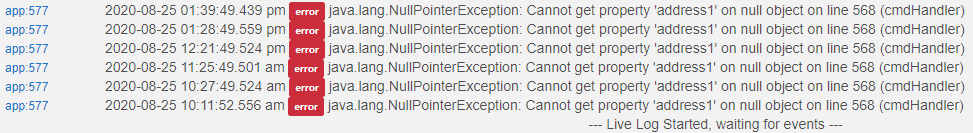

started noticing this in the logs:
Went into app and checked settings and hit done, same with each device and saved configuration.
Thoughts?
Please turn debug on and post a log leading up to the error.

New version on GitHub...
2.0.7 - 08/25/20 - Added more error catching
updated to new version...but of course it hasn't thrown the error since I updated! I'll keep the logging going.
By any chance does this help?
I've not seen the error since.
Yup, problem solved. :sunglasses:
Thanks!

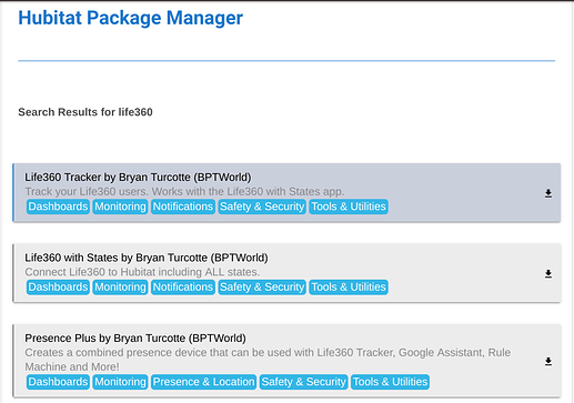

I'm not seeing the code on your Github anymore on the front page where you apps are listed. Also I'm not seeing the app after installing via HPM.. Any ideas?
Just did a quick search in HPM... It's there.
and it's most definitely still on my GitHub (in the port section) :laughing:
Yeah it shows in HPM and I installed, however it doesn't show in the apps list nor when I look under User Apps... Think I should go the manual route?
