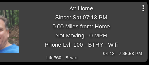

Sorry to be a pain, how could I move the last updated info on the tile slightly to the left as on mine it covers the 3 dots of the tile. Cosmetic I know :roll_eyes:
I'm confused. The 3 dots are on the top right corner and the last update in on the bottom right corner... screenshot please. :thinking:
Screenshot 2020-04-13 at 7.37.44 PM
Sorry it might be caused by the Smartly "app", this changes some of the CSS coding to be able to edit tiles etc. ([RELEASE] smartly - the hubitat dashboard skin engine)
Button
Not a huge problem if this is what caused it, I dont want you to change if other people might use it.

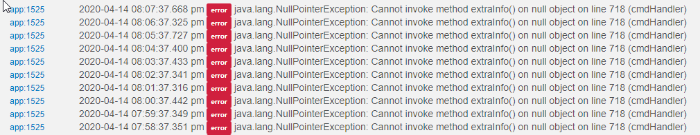

I am getting these errors in logs now after updating app/drivers code.
Looks like the last update screwed up something. I'll take a look at it tomorrow, most likely in the afternoon (eastern time zone).
I saw the same thing. I deleted the Life360 devices and then allowed the app to re-create them and that resolved the issue (no more errors and everything seems to be working). I did notice that the old devices were children of the Life360 Member container device and the new devices created were no longer in a container.
Same here
New version on Github... Very important: Please delete your current user devices before installing this update. After installing new app, go into app and click done. New devices will be made for you.
