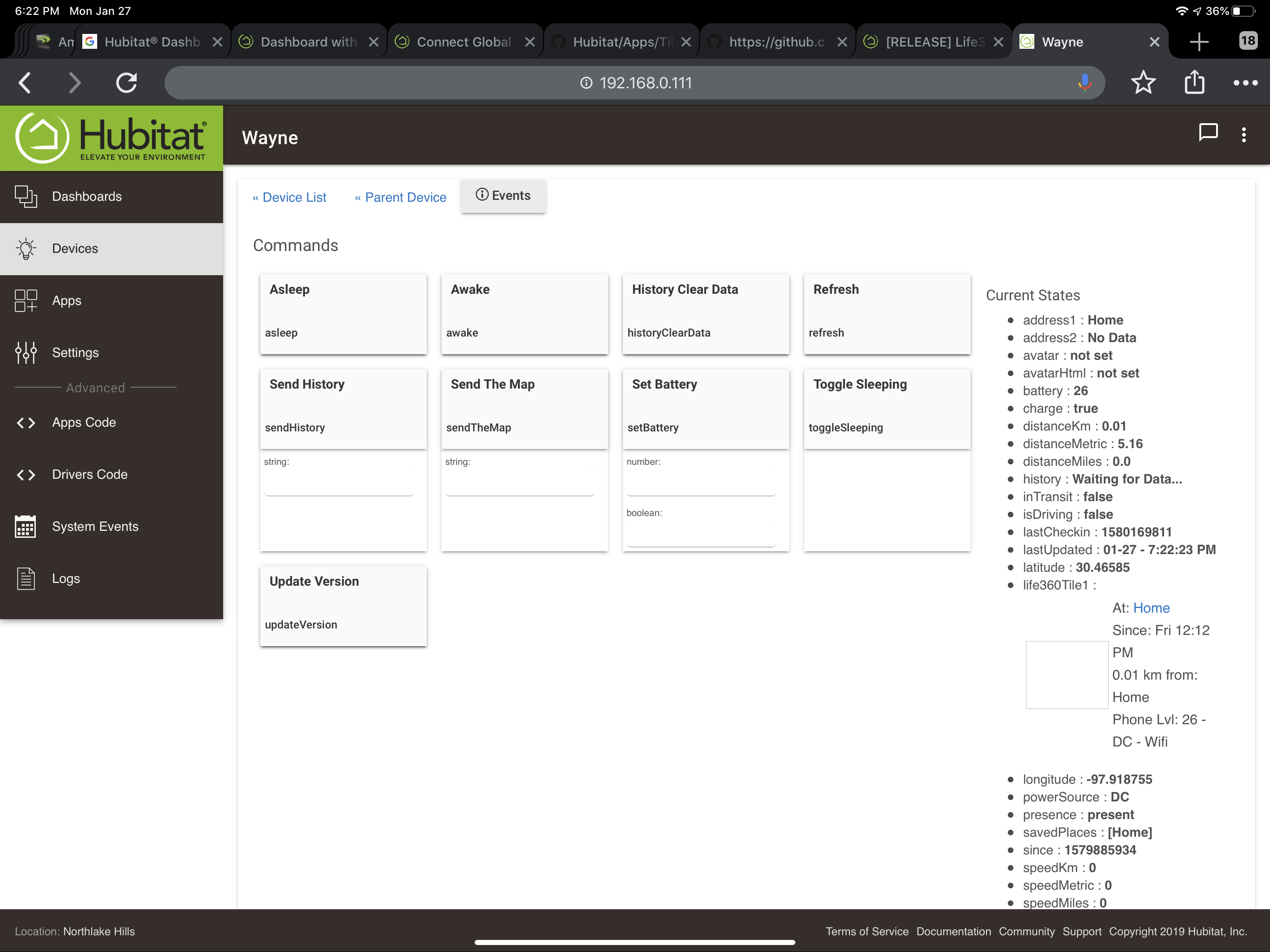

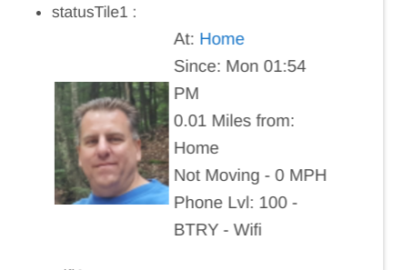

Show me your statusTile1 please
38%20PM
Where do I find that?
In the virtual device created for each user.
Hmm, don’t see that.
Okay, you have the latest released version. I was looking at an unreleased version. Sorry. :sunglasses:
You have the life360Tile1 attribute. That's the attribute that you can use on the dashboard.
Remember to close the dashboard completely, then reopen to see all attributes.
I’ve closed and reopened the dashboard a few times. Where should this attribute show up?
Feels like I am missing something with tiles and the dashboard.
Doh, I knew I would feel like a noob/tool. It’s the attribute tile!
lol, was just about to put up a screenshot of the tile setup.
Glad you got it going.
Your use of the word Attibute got me thinking. Thanks for the help.

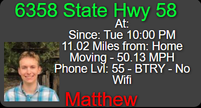

Any tips for formatting the layout of the status tile? I seem to have too much space between the lines, almost like double spacing.
I am struggling with this too, if I make the font larger with CSS the line spacing gets bigger too.
New version on GitHub...
Driver:
v1.2.1 - 01/28/20 - Added Line Height to avatar tile
Is the new version up yet, I didn't see it on your GitHub.
Nevermind...found it.
@bptworld any way to get rid of the (At:) to free up space, I tired to do it with CSS but I can't find the right CSS command.
You would have to edit the driver code and then remember to go in and change it anytime I update the code.
