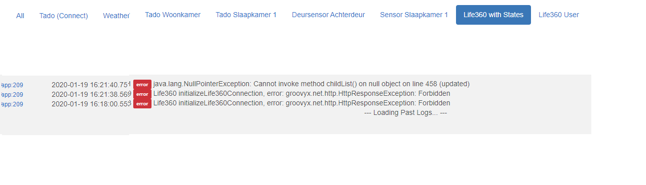

Notice is says 'connection error'. Either your internet is down or your username/password is incorrect.
Either way, it's always better to turn the debug logging on and give me some more info on what was happening when the error occurred. MUCH more helpful that just the error.
Thanks.

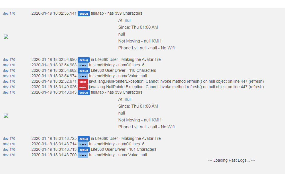

Is this better?
Yup! Still seeing that the app isn't receiving any data. Can you open the app and hit 'done'. Let's see the log for that.

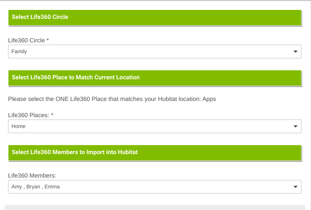

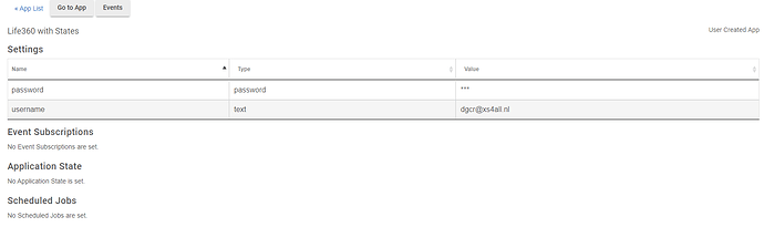

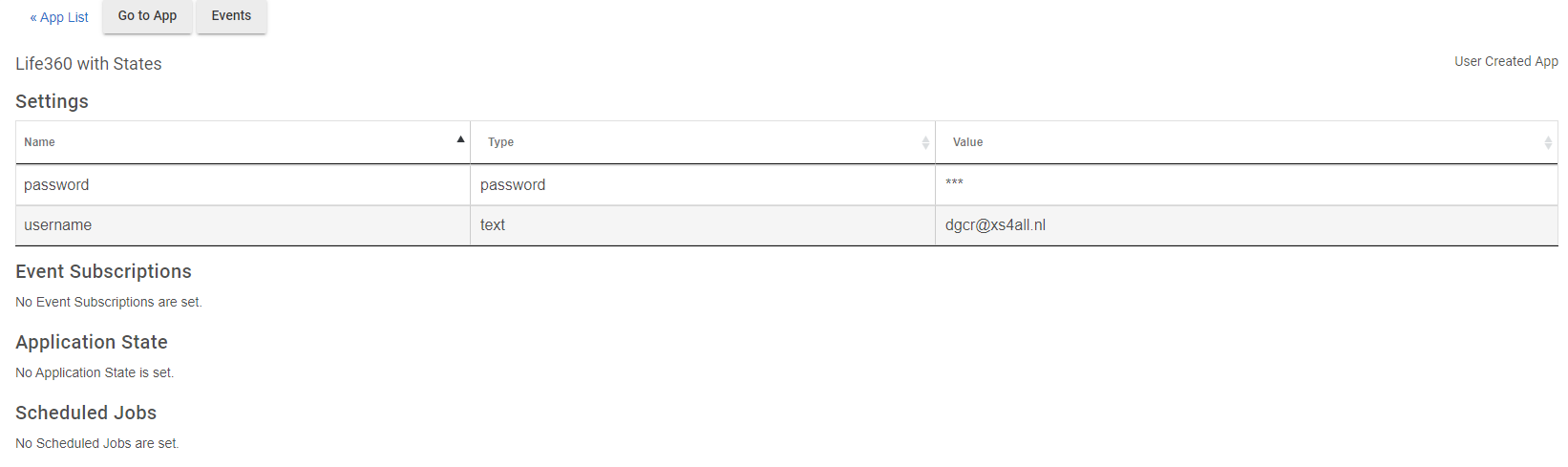

Also, could you show a screenshot of the how the app is setup?
ie.
Log after clicking done:
And the settings in the app

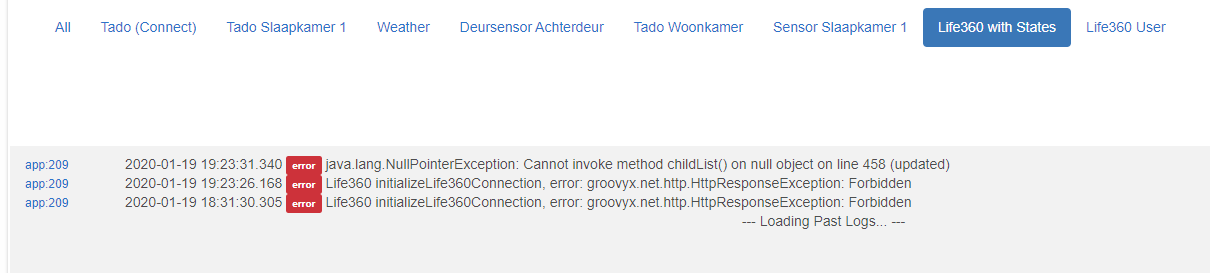

Hi, I have send you the logs last week. Do you have any idea what I am doing wrong?
do you have symbols in your Life360 password? I couldn’t get the app to load my profile in Hubitat until I changed my password to alpha/numeric only for some reason.
Sorry, but there is nothing to look into on my end. As stated before there seems to be a problem with your login.
I'd suggest you go to life360.com and check out your username and password, including resetting your password as @poelock suggested.
Yes! That did the trick. Thank you so much...
