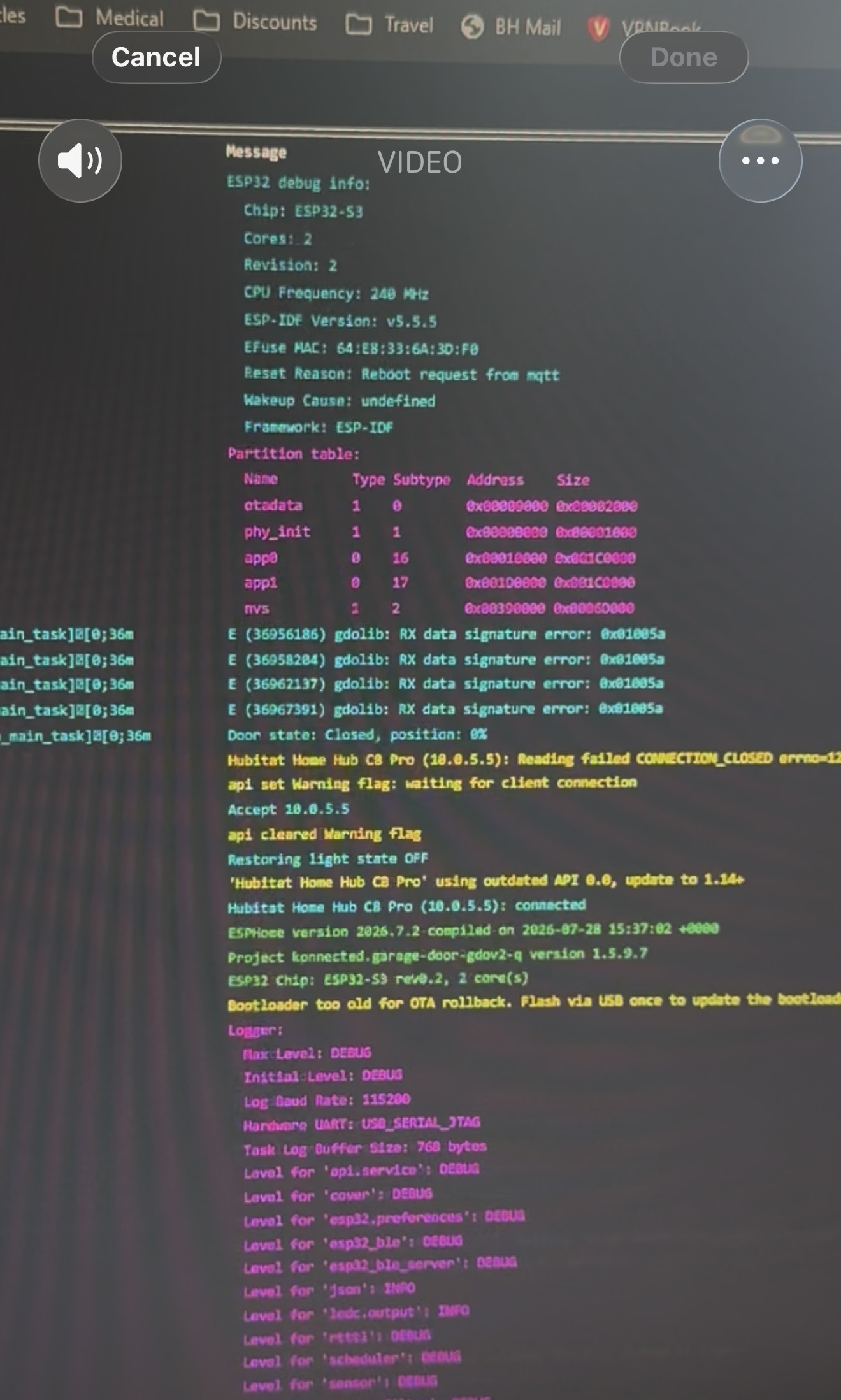

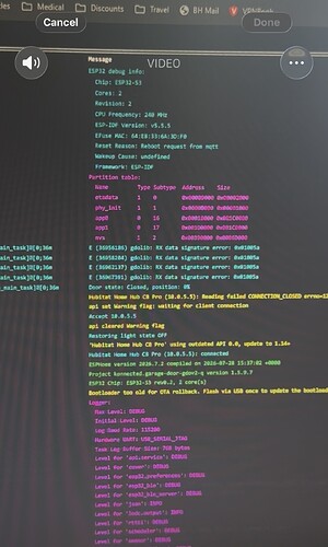

I decided to try my backup hub which is still on 2.5.0.153. When I closed the GDO this is what the log was showing
@nate I beleive this may have started after I updated the firmware to V1.5.9.7.
I thought I saw some yellow lines when I was lookig at the logs with my primary hub connected but because the logs were scrolling so fast I couldn’t read them. Sure would be nice to have a better way to see the logs in the web interface.
Check the version of the espHomeApiHelper under Libraries code. This makes it seem like the client library is too old for the firmware:

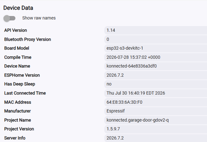

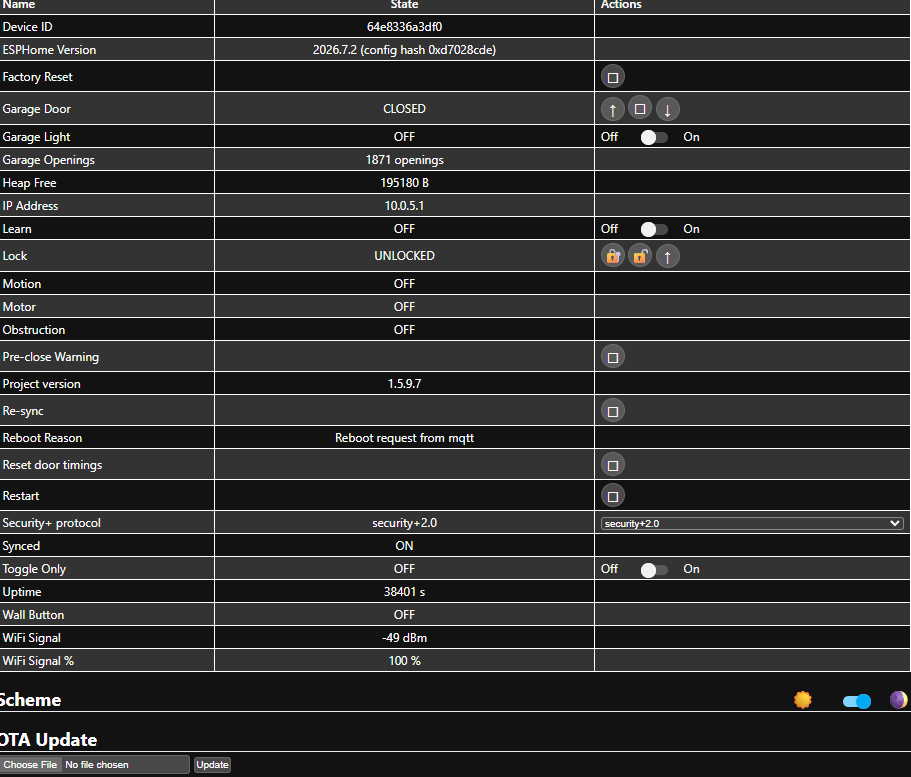

Please try to capture at some of the logs, or a screenshot. otherwise I don’t really know what’s going on. mine is working fine.
Seems odd that the log is showing API 0.0 but looking at the API Version in HE shows 1.14
It looks like the device is connected and online. I am really not sure.
Maybe try nuking the device states in hubitat and letting them repopulate.

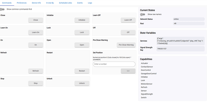

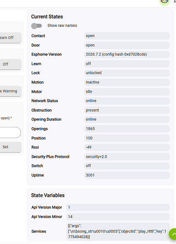

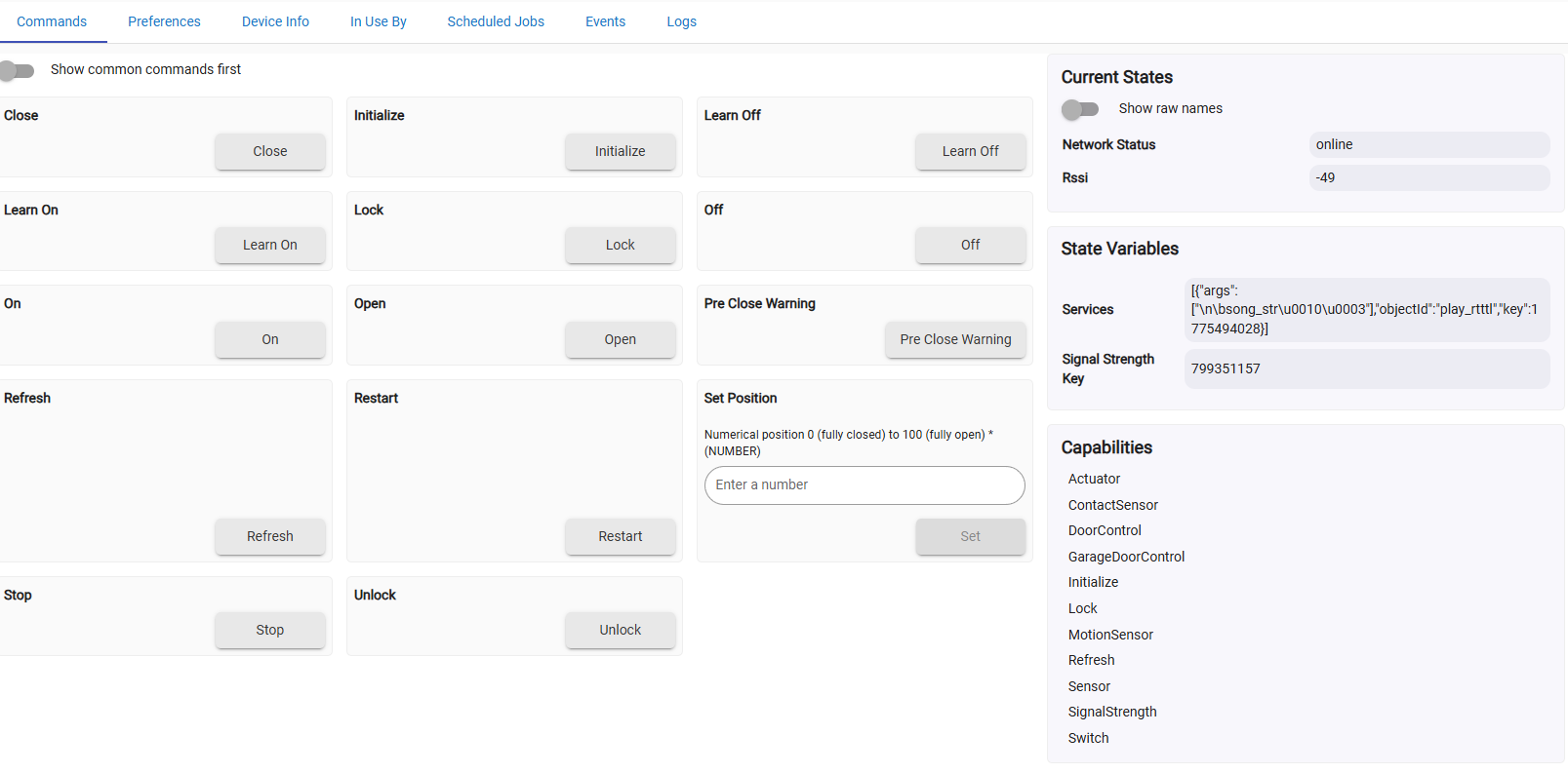

From those screenshots it looks like it’s working fine and healthy.
I haven’t seen any errors, just that API version warning but a warning is not an error. It’s an odd one though.
If you click any of the commands (Open / Close / Set) do you get an actual error in the log? What happens?

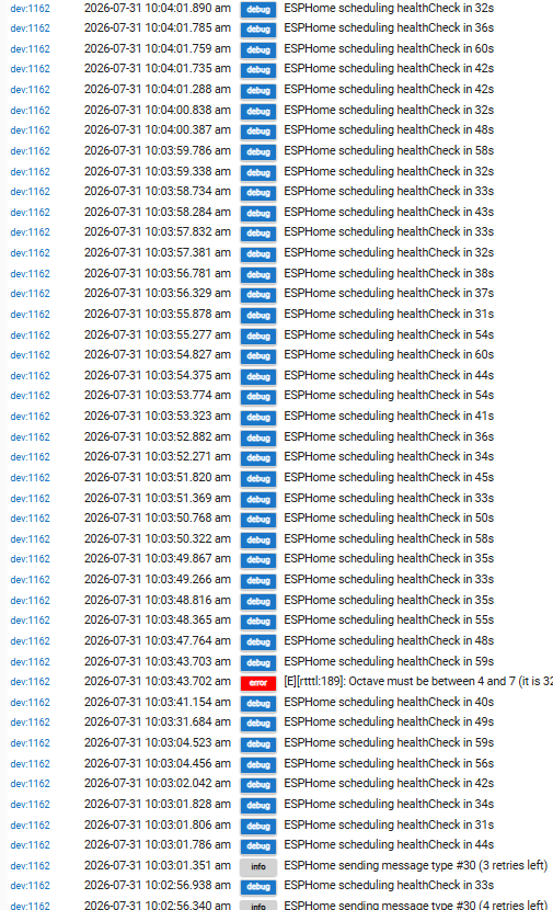

@nate, not sure if you missed this one or if you are still investigating. But the logs are getting flooded again with the debug with all logging toggled off.
Edit- I tried using Claude and got the following
Line 1103
if (settings.logEnable) { log.debug "ESPHome scheduling healthCheck in ${interval}s" }
Also suggested
Line 1095
if (settings.logEnable) { log.debug 'ESPHome ping response received — rescheduling healthCheck' }
espHomeSchedulePing()
You guys are kinda neurotic about your logs :laughing:
Looks like the additional healthCheck logging was introduced upstream. Anyway it's now gated behind logEnable in #48
