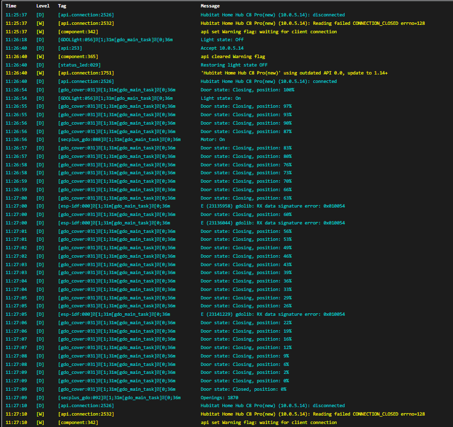

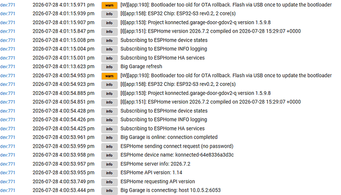

@nate Not sure what the issue is but all of a sudden both of my GDOs are no longer working with Hubitat. They both show open in HE but are closed. None of the buttons, on/off open/close do anything. The web interface is working fine. I have tried rebuild the firmware on both. I have unplugged the GDOs and the Blaq as well as shutting down HE and left them all unplugged for 30 seconds. Not sure what else I should try.
Update 7/30 - I have repaired the driver in hubitat package manager (You should add an additional note in the driver code showing which version it is) no change.
I decided to try my backup hub which is still on 2.5.0.153. When I closed the GDO this is what the log was showing
