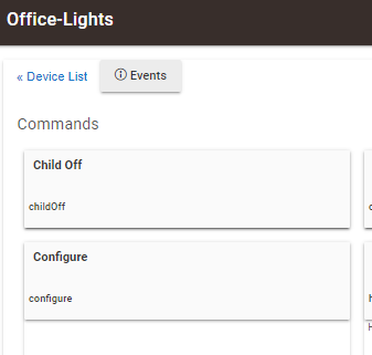

Whenever you make a change to another driver or some of the setting on the page I usually go with the "Configure" button to send the updates to the device:

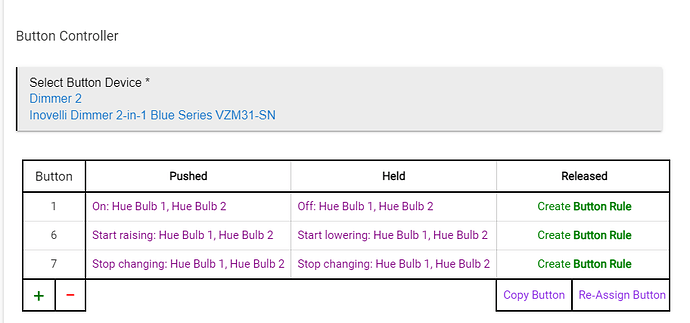

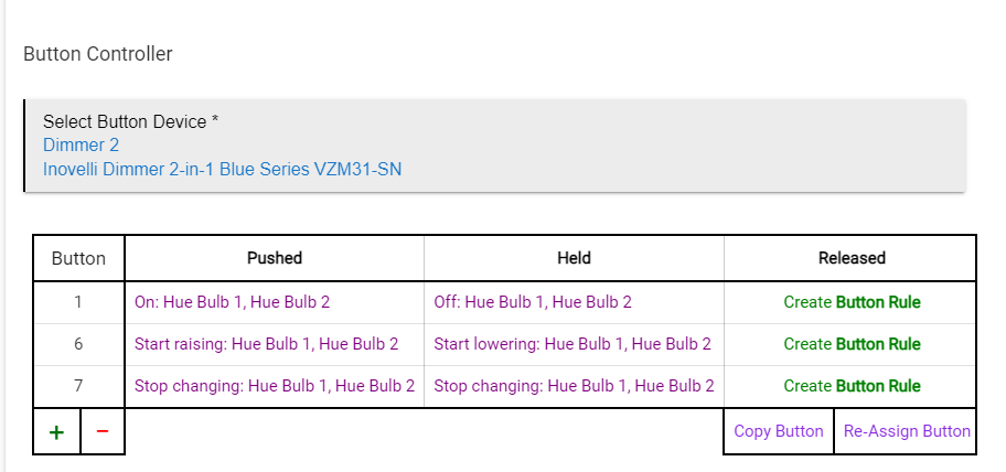

Hi - I've just installed a red series dimmer on a circuit that has both regular LED track lights and hue ceiling bulbs. I'd like to dim the hue bulbs via the switch (via hubitat of course). I'm not clear on the difference between two driver options: Disable local load control and enable smart bulb mode. Presumably the first one does just what it says so the power is always on to the circuit. But then what does Smart Bulb mode do that is different? (Also - is there actual documentation on the driver settings?)
Smart bulb mode makes it so that the load will always output at 100%. You probably want to enable that. Then, you can use "Button Controller" to control the hue bulbs. Here is an example of how to set that up:
This is for the blue series, but it should be the same on the red series.
For info on the parameters and settings I think this might be the best place to look:
Thanks - so if you disable local load control but DON'T enable smart bulb mode - what does that do? Is the difference that you could still turn the power off via the hub if smart bulb mode is not enabled?
Yep, exactly. You can still turn the load off via the hub.
