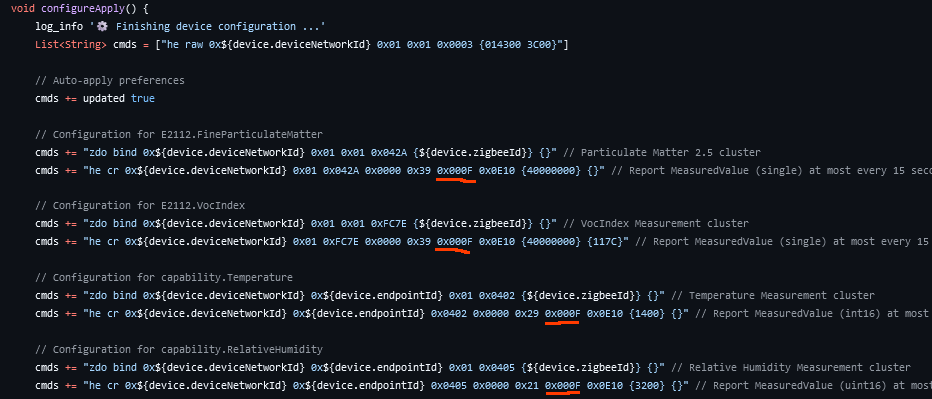

Right now the minimum reporting interval is set to 15 seconds (0x000F in hexadecimal = 15 in decimal ). This does not mean that the device is reporting every 15 seconds; it will not report value changes more frequently than every 15 seconds (if the value changed).
You can adjust this minimum reporting interval in the driver code here:
To report at most once every 1 minute, you need to change 15 to 60 (0x003C in hexadecimal). I use this site to do the base conversions.
After you edit and save the driver code, you need to run the "Configure" command in the device details page, to commit the setting to the device.

At my experience level, your step by step instructions were perfect - particularly including the link for base conversions! Both of my Vindstyrka are now showing data once every 5 minutes in the log and providing much needed repeater functionallity.
