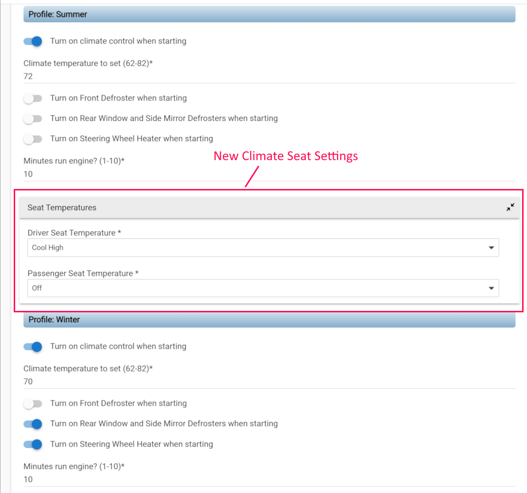

A new Beta drop is available for testing. This drop is feature complete for this release and will become the Release Candidate if there are no issues found. The highlights of this release were previously outlined by @corinuss (who is responsible for these enhancements) in a previous post:
Here is a screenshot of part of the profiles page from the app, showing the new seat settings:

The new seat temperature controls that were pushed out in 1.1.0 (for the US app) now reads what your car supports from your vehicle data reported by Bluelink and exposes those options to the climate page, so if Bluelink does ever add that support, this app will be ready. But until then, there's not anything we can do about it. :frowning:

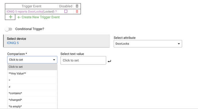

Can I ask a stupid question? I have set up a virtual lock and a rule to allow me to control the Santa Fe's door locks. That works fine. The problem I am having and I'm afraid I'm over-complicating things so thought I'd ask.
I want to synchronize the actual status of the DoorLocks actuator of the Hyundai device to the lock. But unlike a physical lock where I can determine if actions taken on the lock were physical or virtual, I can't with a virtual only device.
If I run a routine to only run when my presence sensor is "home", and then say every hour (until the crime rates go back up, then maybe every 30 mins :slight_smile: ) and I refresh the Bluelink device and set the virtual lock to reflect the actual status, it triggers my Bluelink DoorLock routine.
Is there a more streamlined or better method I can't visualize? Thanks!

I have two rules. One rule to unlock/lock the car based on a virtual lock. Another rule that tries to keep the Virtual Lock device synchronized to the physical state of the car.
I have a virtual lock that has its own status--I am trying to mirror the status of the Bluelink connected car...so if the car says "Doors Locked" = "true" I want the virtual lock to show locked.
My rule uses the virtual lock--to detect when the lock status changes. So when changed, if locked, send the lock command to the car, etc.
The problem is that the virtual lock needs to be updated with the actual status of the car. I had a routine that would check every hour and if the Virtual Lock status wasn't correct, it would update it to reflect the actual car's status:
My rule simply ran every hour, sent a refresh to the Bluelink device, waited 15 seconds, then read the Doors Lock attribute and sets the Virtual Lock to that status. That way the Virtual Lock would--within time--be synchronized to the physical car.
The problem is that I now have a rule that detects when the virtual lock status changes (I tell Alexa to unlock the car). The virtual lock will change its status to unlocked after sending the unlock command through Bluelink. The car, however, if unattended for more than ten minutes will lock itself back (unless a door is opened, etc.). Then the Virtual Lock no longer reflects the actual status of the car. It is unlocked. But the car is now locked.
The synchronize rule is fine, but now when the rule runs and changes the lock status when updating, it causes my lock/unlock rule to trigger because of the changed status update.
With a physical lock, they stay in sync because I can detect if the changed status is triggered physically or virtually through a rule. A virtual lock device can only be changed "virtually".
I tried setting a boolean variable, then a global variable to be set when its the synchronization rule that caused the Virtual Lock to change so that my lock/unlock Bluelink rule would ignore the changed status altogether. That was the only way I could figure it out.
