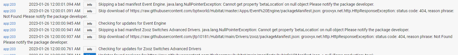

I was just reviewing my logs and noticed these messages. I thought I would post them here for the developers. I am running 1.8.8 version of the Manager.
The BPTworld packages he moved to his own Bundles app and removed from HPM, you need to use "Unmatch" in HPM to remove them from HPM. Install his other app if you want to get updates.
For my Zooz driver, I moved the manifest a while ago, you need to unmatch then run matchup again to pair it up with the correct file.
