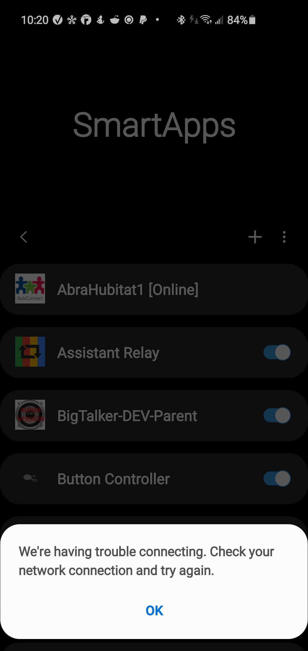

I'm getting a connection error in the ST HubConnect app when I hit done after selecting devices to be included, etc.
ALso, the ST app tells me I'm connected, but on the Hubitat side I'm getting an error:
I don't see any devices on the Hubitat when I look at my devices page (other than Hue devices I've already added via normal HUE bridge device add in Hubitat.
All apps on both Hubitat and ST have OAuth enabled, and I've pasted the key into the ST HubConnect app.
This is the 2.x RC I'm installing - says "{major=2, minor=0, build=9700, platform=Hubitat}" on the Hubitat app server status page. Smartapp in ST IDE code says "Map getAppVersion() {[platform: "SmartThings", major: 2, minor: 0, build: 9700]}".
Both Hubitat and ST hubs are on the same subnet (same VLAN, actually). When I was discovering the ST hub from the HubConnect app on the Hubitat it did not find the ST hub automatically, I had to enter the IP address of the ST hub. After I did that the connection was verified in the HubConnect app on the Hubitat. However, the ST app was giving the error above so I returned to the Hubitat Hubconnect server app and since then when I try to verify the connection I always get the error above.
ok, a couple of questions..
Are you using the Classic ST App or the new one?? I understand that the new one does work, but all of my experience is via the classic app.
Installing HubConnect really has to follow a two major step process. You shouldn't try to select devices to be 'mirrored' until the first step is successful. I use a metaphor of 'highway' vs 'cars and trucks'.
Getting the hub(s) interconnected is similar to building a highway. Pairs of hubs are interconnected and the resulting array of connections makes up your HubConnect Highway. Can't drive cars and trucks of an incomplete highway.
You're still on the build-a-bear, umm highway, stage.
I'm sure you're more familiar with ST's App process than I am anymore. You have to use the IDE to add in the code, then in Classic App, use MarketPlace to install the App.. then use Automation to configure the App, including adding the Key.
It's HubConnect Remote Client for SmartThings under SmartApps in the IDE with OAuth and at least HubConnect Remote Hub for SmartThings Driver under Device Handler in the IDE.
Once the 'highway' is built (online) then you can install appropriate drivers for the devices you wish to 'mirror'. After that, you can make your device selections. Be sure to review the driver list when you complete the selection process. You must be certain all the drivers in the list are on the 'other' hub before clicking Done. If you don't, the other end can't create the 'mirrored devices'.
Thanks, @csteele!
I have removed everything and am starting over...the driver part was something that I didn't see at first, the need to install all the drivers as well.
I'll try your suggestion to use the Classic app to set up the ST app. I have created the ST app (many times now ) in the IDE, but haven't used the classic app to add the key, been doing it all in the new app.
Onward! (I hope...)
