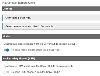

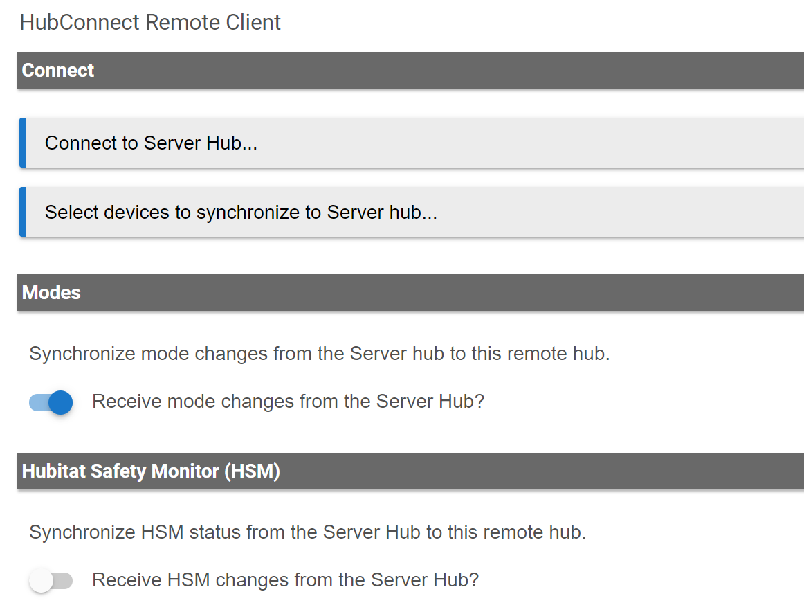

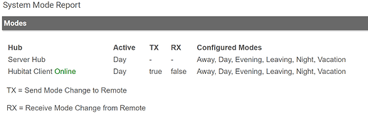

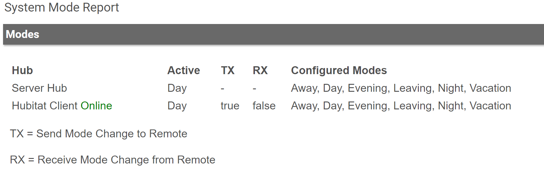

I have an issue with modes.
Server Hub
Remote Hub
I'm not sure why the server hub is receiving mode changes. In fact, there is nothing on the remote hub that would change the mode (except HubConnect).
On the server hub, I cant seem to find where to select "send mode changes to remote". I can find receive mode changes from client (again on server hub).
If you are using EventSocket then mode is included.. no special need to enable it. It's the receive that needs to be selected: yea or nay ... track what comes in or ignore.
The "error" is simply saying it's ignoring. I think "Error" is a bit over the top. It's more in the "Info" realm to me.
Thanks @csteele. Makes sense.

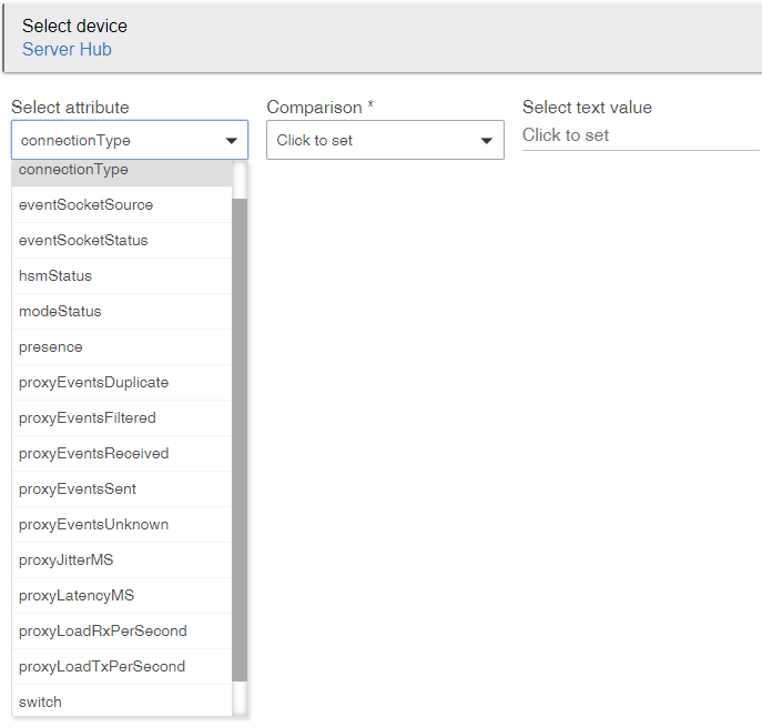

I would like to have a rule run when the Hub connects. Is there something that could be selected as a trigger when it occurs?
There must be an attribute from the Hub Connect device that changes...?
The available attributes that I have access to are:
Would anyone know if one would work? And what would be value I should be looking for?
EDIT: I did some testing and found that when a re-connect is initiated (Ex.: By toggling "Send connection key and automatically configure the remote hub?" from the "Connect to Remote Hub..." screen on the server hub) the "switch" attribute will toggle off and on.
Tried it and confirmed that it does trigger my rule. :smiley:
Edit 2: I just noticed that on the server hub, the "switch" is set to "off" in the HubConnect Remote Hub device that points to my other hub. Is that normal? Shouldn't it be set to "On"? Does anyone know what would cause it to be set to "Off?

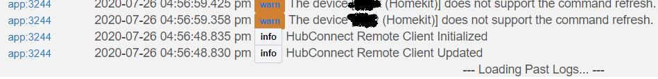

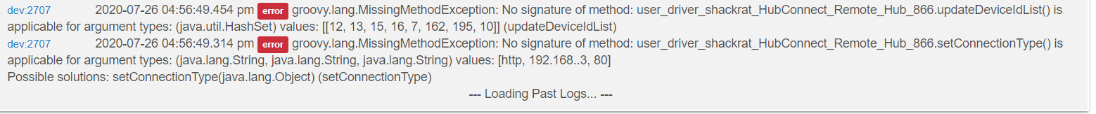

@csteele any idea what this error means? It's in the logs of a client hubitat hub, from the server hub device.
Not sure if it has something to do with these devices I just added (log from the client hub's server app instance):
Thanks for any insight.
Edit: should probably have mentioned I'm still using v 1.6 of HubConnect.
