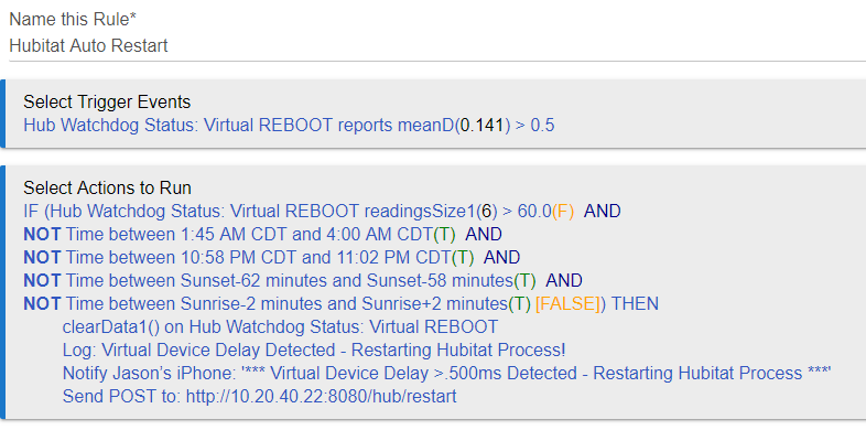

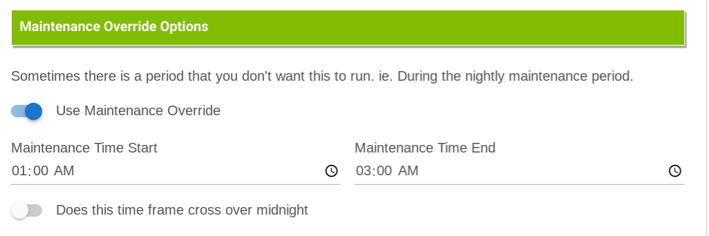

I use this app to trigger a process restart for Hubitat when thresholds are exceeded (to prevent system slowness problems) using the rule indicated below. I would like to see the ability to exclude a timeframe to run my interval checks for this particular child so the maintenance window is excluded e.g. 2-3am. This time period can greatly skew the overall results of hub performance (mean.)
Thoughts?
added to the list
New version on GitHub...
Child:
1.1.0 - 07/10/20 - Added Maintenance Override Options
You rock!
Updated and implemented, looks great!

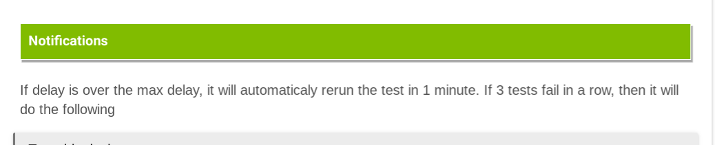

You know what might be helpful for this is to be able to set a threshold of the number of times in a row a device exceeds the threshold before executing a rule. Or perhaps the number of times over a given time period that it exceeds threshold before executing a rule. Use case would obviously be that I could execute a rule only after a certain number or exceeds to restart the process. Sometimes it only exceeds once due to activity which happens to be running at that instant but then ends and the hub performance goes back to normal.
What do you think?
LJ
Yes that is sort of what I am saying, but does that just apply to notifications or does it also apply to running rules? It also seems to only cover a 3 min period
Also, what I was envisioning was a user setting which would trigger a rule after that number of regular scheduled tests. This would show that the problem is more ongoing than just three minutes.
both, changed the wording in app
added
Still will rerun after 1 minute, but will do it for as long as you set the max number of fails to, instead of just 3.
