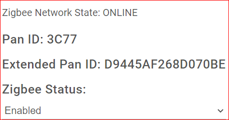

The /hub/zigbeeInfo page html should have string <h4>Zigbee Network State: ONLINE</h4>
Do a preg match for '$<h4>Zigbee Network State: *([^<]+)</h4>$' then set the status as captured result[1]

Disabled Zigbee, did a HIA update and configure, Hub Information Driver out of sync with Zigbee status page
Doesn't let me update an attribute to null so you're getting the last valid channel, but give me about 2 minutes and I'll get you a version that has a zigbeeStatus attirbute (enabled/disabled)

Should be in HPM now, values are enabled and disabled
Thank you, installed latest version, something's is wrong
Fat fingered the check in the Configure area, would have corrected on the next poll, but if you don't mind doing a Repair the updated code is out there now.
Repair done, still showing disabled.
