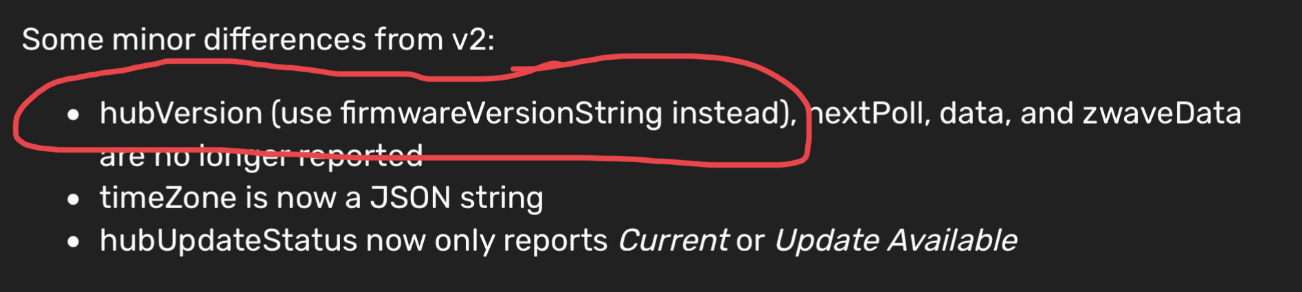

This might be a user error/understanding, but I thought I post it to be sure. The app is reporting my hub version as 2.3.4.130
But in actuality, it is 2.3.4.132
The firmwareVersionString shows correctly...
Are these different data points or are they the same?
It’s in the release notes
Thanks!!
So it's depreciated but still shows in the app or is it something that I did wrong when I installed the version 3 app?
Thank you very much!
Hit Remove Unused and it should delete those.

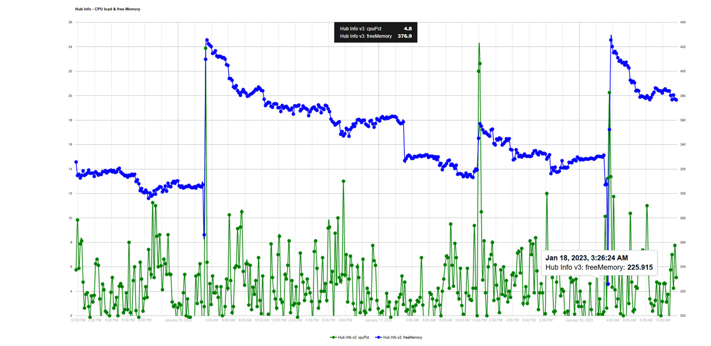

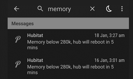

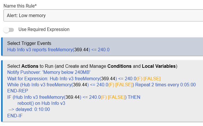

It seems a bit weird that the memory for the hub went below 280MB on two occasions at around 3am when there is no activity?
Graph
Pushover message (NB: changed text from 280k to 280MB now)
Any idea how I can diagnose this?

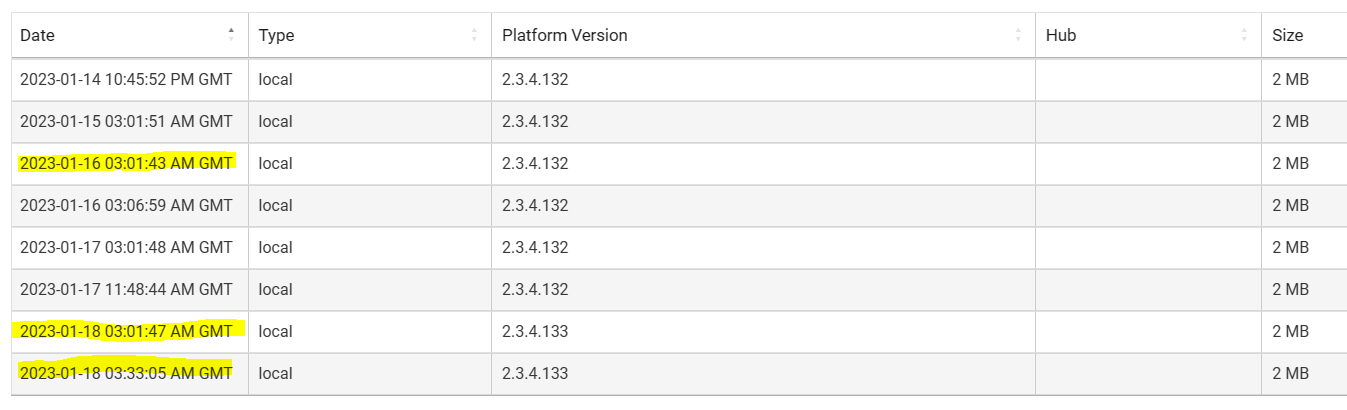

Check your backup times...
Ah, yes, it seems to be around the time automated backup occurred.
Not sure why there is two backups on the 18th, will change the reboot time from 5mins to 30mins.
Summary
May not have had time to record the fact that it had finished the first backup so it rescheduled. May want to check for 2 concurrent readings below your bottom threshold as the hub should recover most, if not all, of the memory from backup processing.

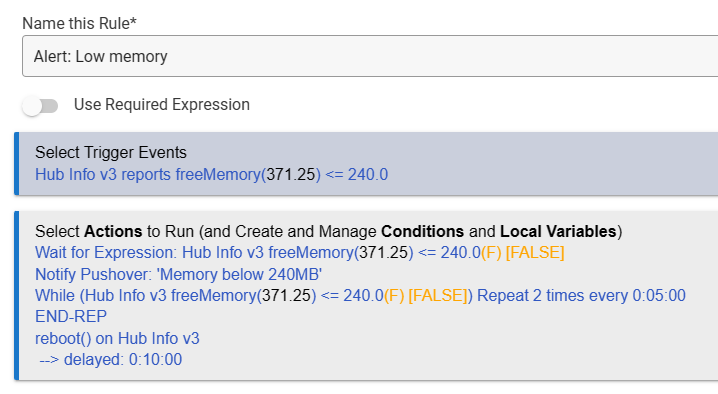

Thanks for the feedback.
I've not used repeat functions before, would the rule below work?
Summary

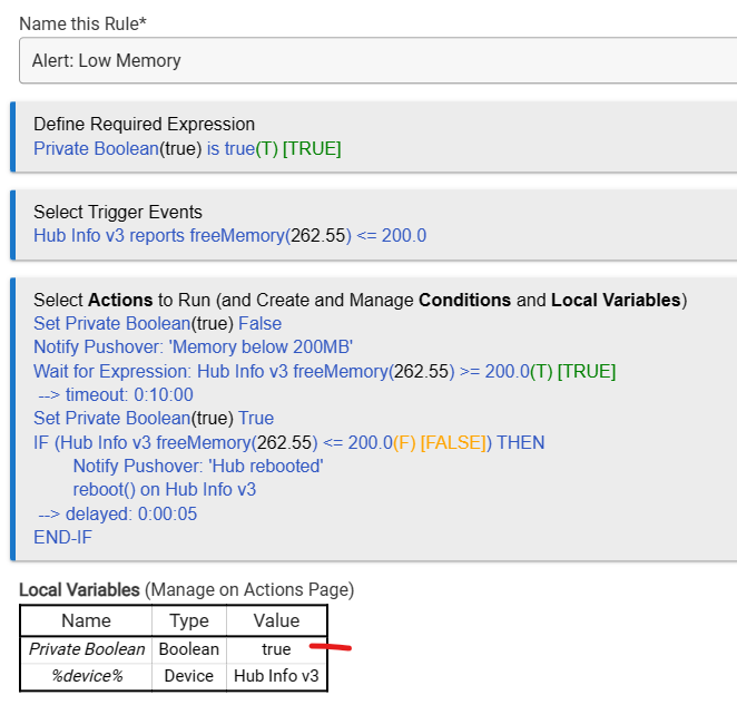

If I'm reading that right it is still going to reboot even if the memory recovers. Can you add a condition to the reboot that it only reboots if still below your minimum desired?
Sure, hope the below will do the trick:
Summary
Can do this several ways. I'm still on the old Hub Info but the logic would be the same. Using the trigger as you have it I'd do it with these actions:
So basically triggering on the low memory and then waiting for it to go back over 240 for 10 minutes. Then it either did go over 240 or the 10 minutes expired. So we test and if it's under 240 we do the reboot otherwise it will simply exit. Also not sure but you may need some logic to be sure the rule doesn't keep triggering if the memory keeps shrinking. Like using the Boolean variable and setting it as you are beginning the wait. So something like:
Even if you keep it as you have it now consider the Boolean addition to keep it from potentially running the logic over and over if the memory keeps ticking down.
Excellent, thanks for this @tivomaniac!
EDIT: working rule after further discussions with @tivomaniac.
Note: manually set PB to true under local variables once the rule has been setup.
