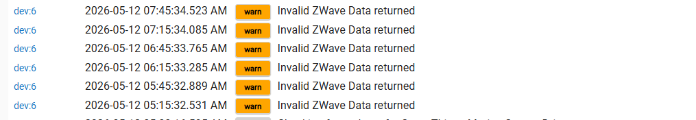

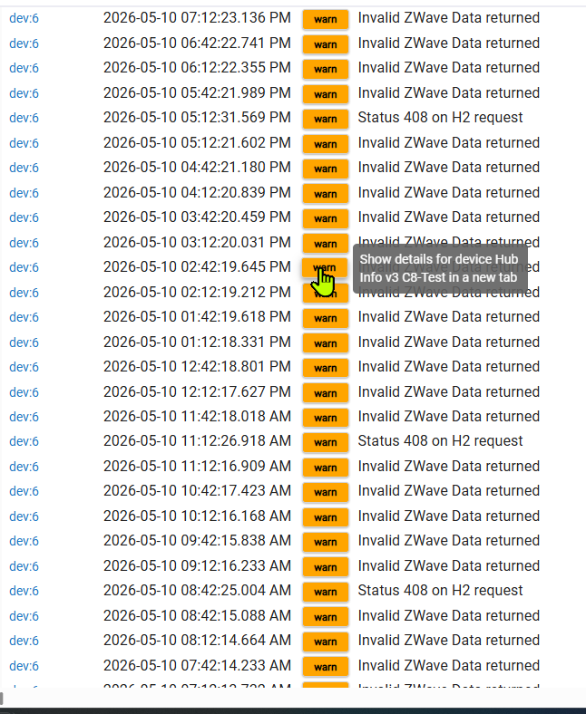

Getting a funny error on a C8...

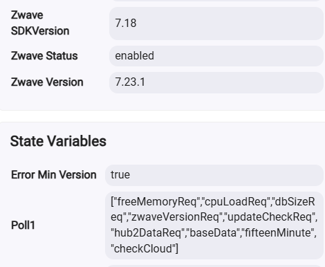

Minimum version error is interesting... What firmware version is it on?
Record breaking. Shattering. :scream: :rofl:
2.5.0.136.

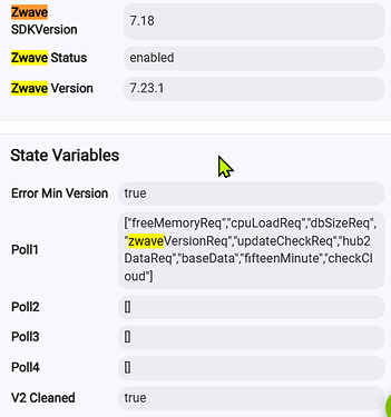

Hmm, what does http:\\<hubIpAddr>/hub/zwaveVersion return for you?
7.23
Is your zwaveJS attribute showing true ?
It's a C8 so I'm running ZipGateway on it.
Should be returning something like this then:
VersionReport(zWaveLibraryType:7, zWaveProtocolVersion:7, zWaveProtocolSubVersion:23, firmware0Version:7, firmware0SubVersion:23, hardwareVersion:1, firmwareTargets:1, targetVersions:[[target:1, version:7, subVersion:18]])
Which would agree with what your Zwave Version attribute is showing (so the last time it successfully queried the value you were on gateway), but the response you're getting now is the typical ZwaveJS response.
On the Invalid Zwave Data message, what is the length reported?
Oh weird...I am on Z-WaveJS on the C8! I swear I switched that back to ZipGateway a couple weeks back, as I had only had it on Z-WaveJS. My bad, sorry about the inaccurate Z-Wave version report.
I don't get any length info w/the WARN message, just what you see above in my first post on this...

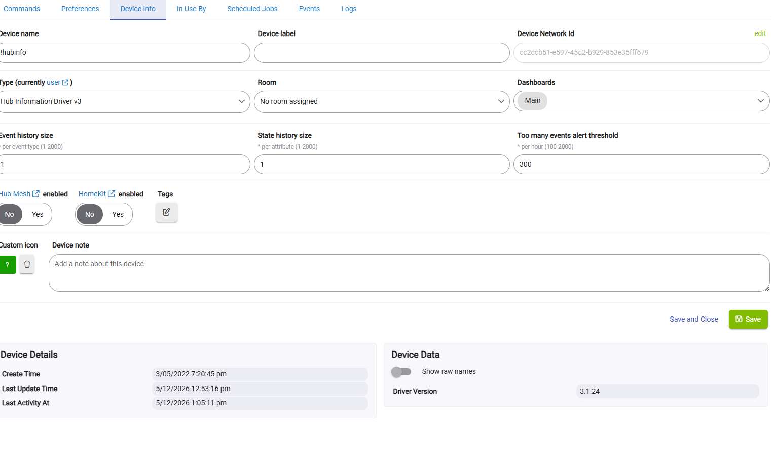

What version of the driver are you showing?
Interesting...version "I'm not telling!" Didn't notice that.

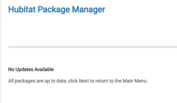

Odd. I'm thinking maybe I installed from your GitHub and didn't ever tell HPM (which runs auto nightly) so the app never got updated after initial install.
Woah! I've discovered a dinosaur.

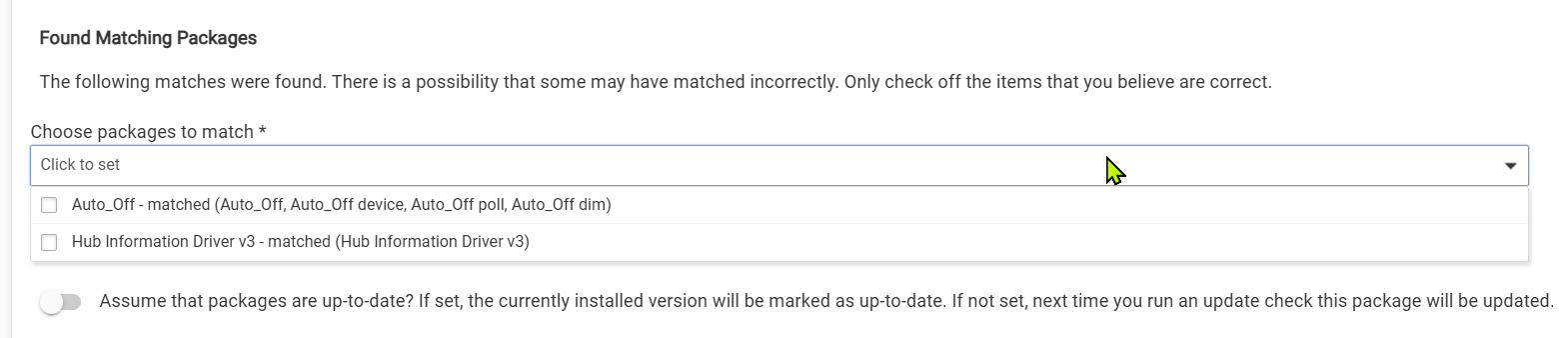

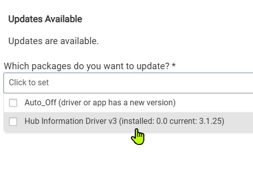

I did a match-up to get HPM to see your driver, then it offered an udpate (from 0.0). :slight_smile:
