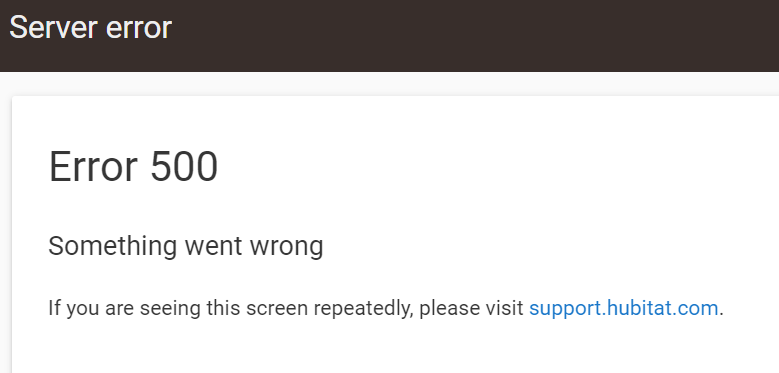

Hello,
I am recently getting 'null' for html attribute too. I tried all items posted here no success. Also, if I save preferences I am getting:
Any guidance appreciated.
