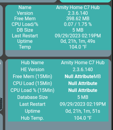

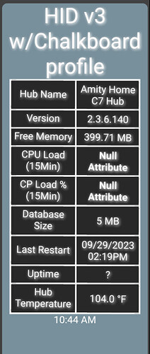

@thebearmay As I was working through my desire today - I stumbled again - your driver offers a FreeMem15, a CPULoad15 and CPULoad%15 which I take to be low impact attributes to use in my tile.
All three do not show in Current states on my device itself and show on my custom tile as 'Null attribute'. Seen below, the HTML from your device used in a tile and my reproduction tile WIP below it.

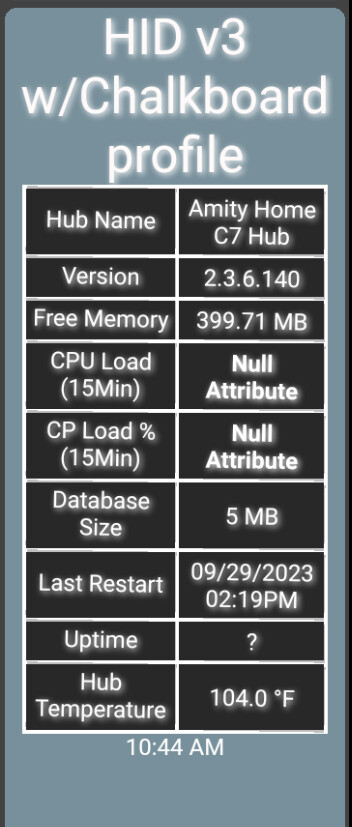

edit @garyjmilne has embedded in his amazing tile builder app the ability to have styles. You can save them, share them with your friends etc. devs no longer have to build the HTML tile! Here, with a single click I converted my tile work product to a pre-canned 'Chalkboard'.
Sounds like you don’t have the 15 Minute Averages preference set to an active poll queue.
it sounds so obvious when you say it! bingo. you fixed me. I/O error - inputting operator.

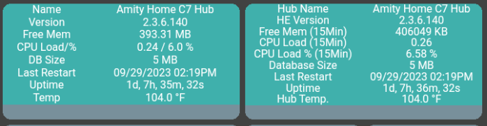

sorry to bother - @thebearmay - the free mem kb/mb applies only to the free mem, not the free mem 15 value? In the image below I'm appending the KB letters - but the preference switch seems to have no impact. Maybe someday you can have the pref switch work for both?
Thanks for this incredible tool. I use it daily.

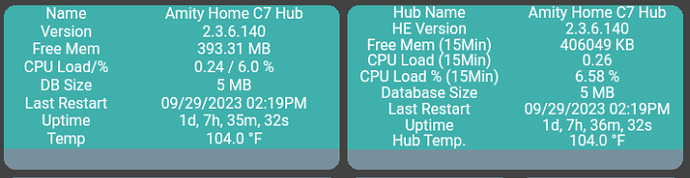

For interested parties - here's my HID Tile from the original and my Tile Builder version. I wanted to prove I could simulate exactly (well. close anyway). now to go have fun with it so it looks consistent with my other tiles.

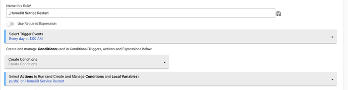

@thebearmay is there any possibility of adding the option to restart the HomeKit service?
I find the hourly restart annoying, and would love to just schedule a service restart every 24hrs with RM instead.
I'll look at it...
Cheers, much appreciated.

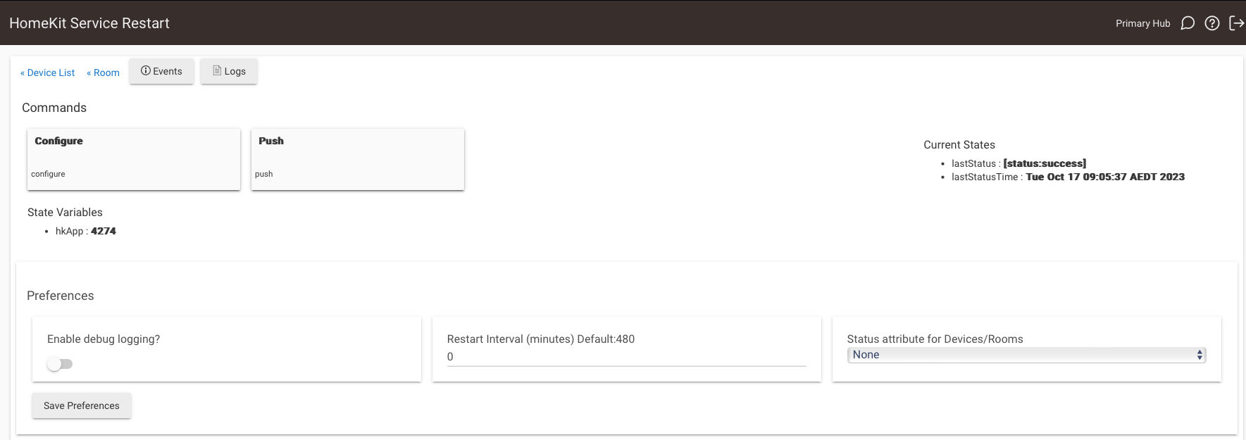

@dJOS See if https://raw.githubusercontent.com/thebearmay/hubitat/main/hkRestart.groovy does what you want. Should be able to configure it to do an interval restart or use it as a momentary button and use RM to issue a push command.
Legend, I’ll have a look say it today.
Lovely work sir! I think I have it working - although I cant figure out how to see the HK service restart in the logs. :thinking:
Anyhoo, I set the interval to zero (which I assumes disables the driver schedule) and created a rule to restart it everyday at 1am. Hopefully this is all correct?
Sounds right.

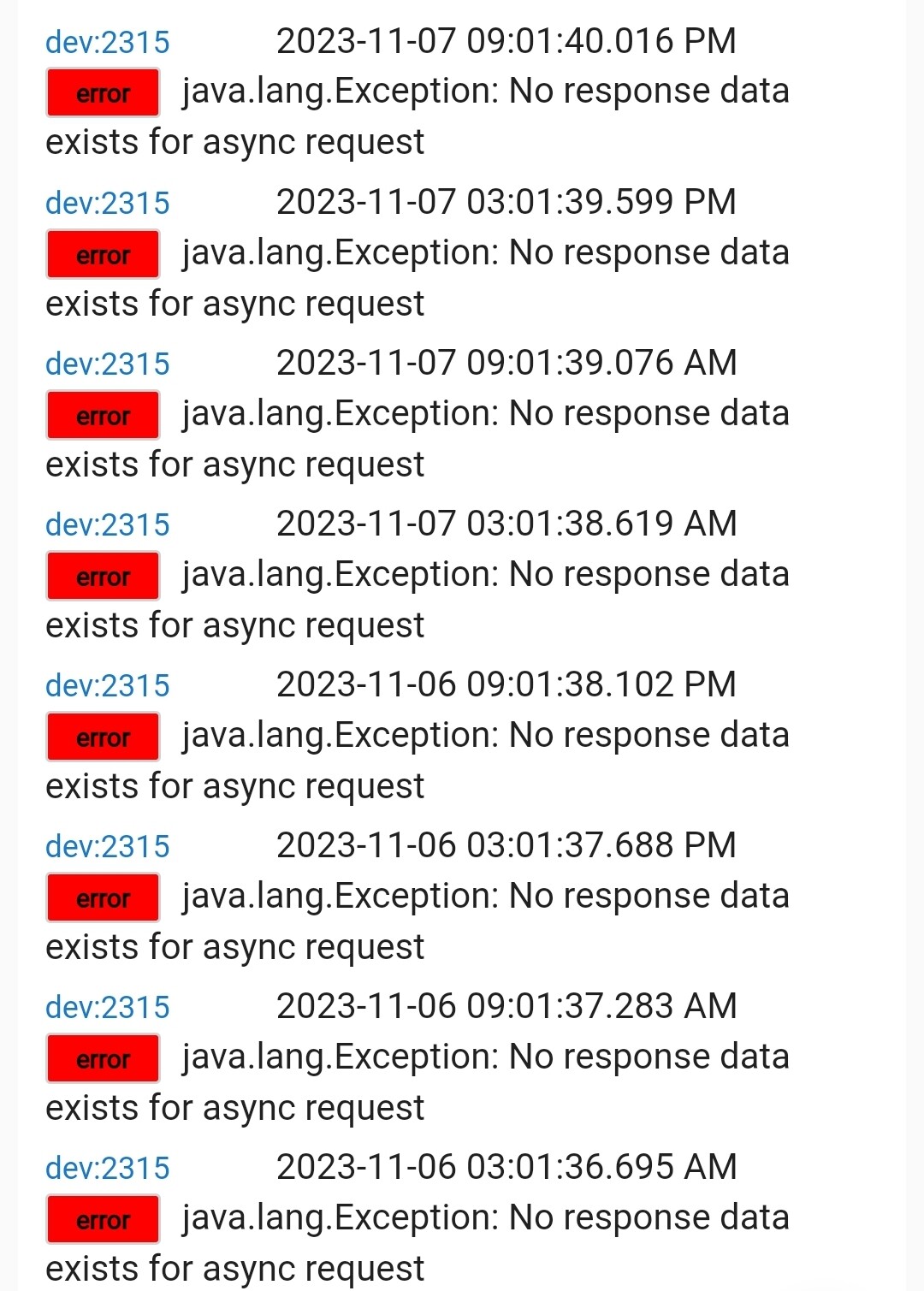

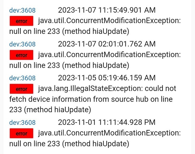

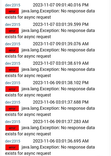

Checked the logs and found that these two are happening...
Both in logs on Main Hub

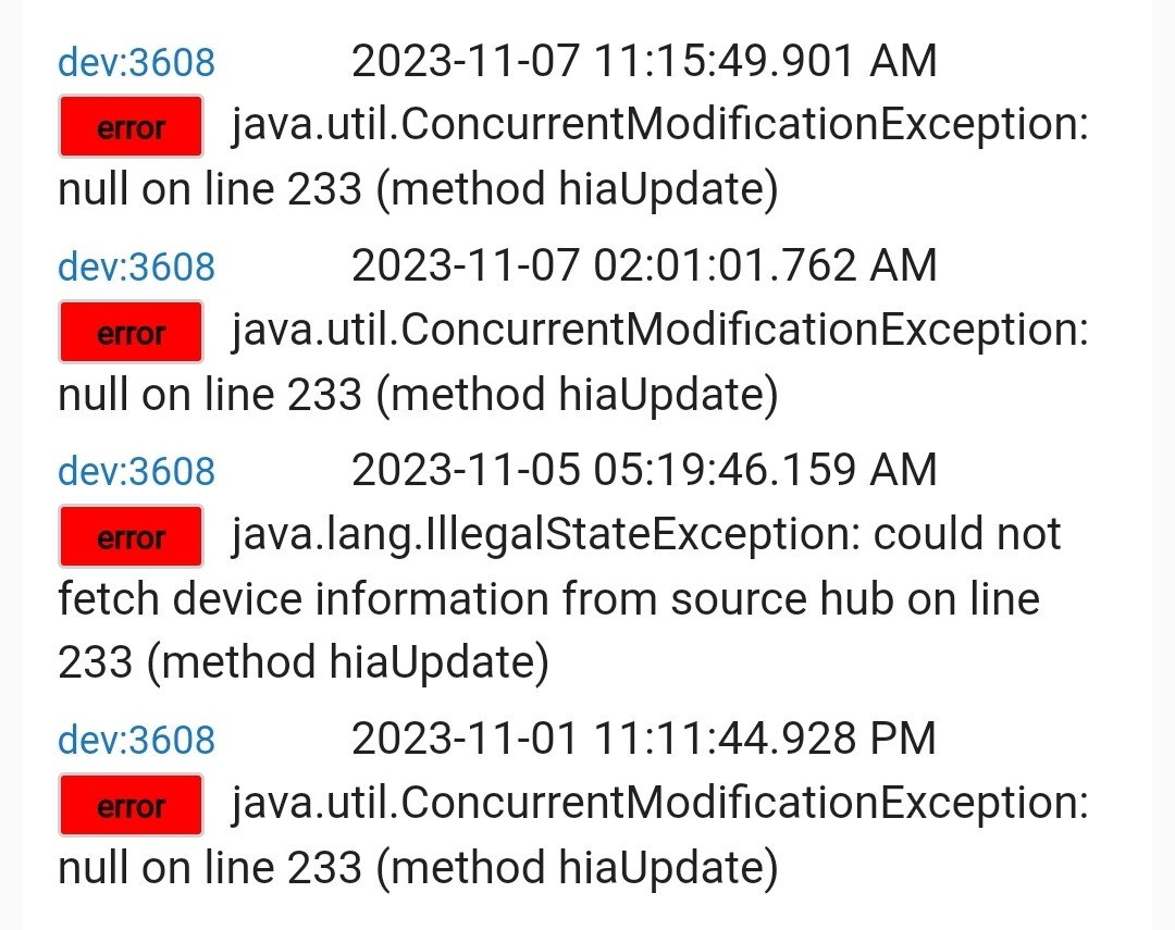

3608 is LAN hub info via hub mesh
2315 is Main Hub info
What version of the driver and what version of HE are you running?
Oh well I saw the errors apparently before updating to latest driver.
I'm on latest everything now and haven't seen any new errors
