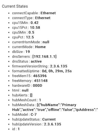

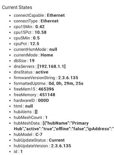

Hi @thebearmay Im having an issue, after upgrading to 2.3.6.135 on one of my hubs, the html attribute shows null. The other hub html works fine, any ideas?
Try hitting Configure, if that doesn’t fix it check to make sure your template file is still in the File Manager.
First thing I tried. :frowning:
