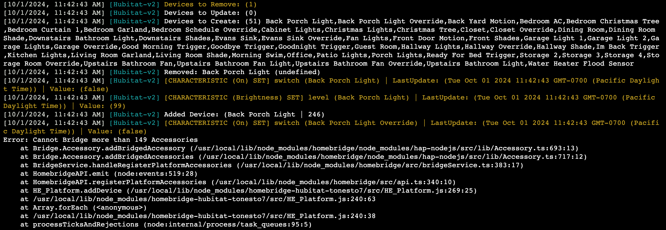

Hello, looking for some support with this error Error: Cannot Bridge more than 149 Accessories. I've cut down my number of devices to 51 as seen in the stack trace below, but I'm still running into this issue. I have it running on it's own child bridge in Homebridge so no other plugins should be conflicting with it. Do I need to limit the number of capabilities each device has or something? Any help appreciated, thanks!
This is a HomeKit issue as it cannot have more than 149 devices per accessory. I searched for that error and found a ton of posts online. Net of the issue is the cache within HomeKit/Homebridge may be full even though you cut down teh accessories. This one offers some advice:
Go into Homebridge Web UI > Settings > Remove Single Accessory
From there, remove any cached devices that you are not longer sharing.
If it is way out of sync you may just want to use the options to remove the entire cache, although not sure if that will have any other side effects.
@ritchierich @jtp10181 Thanks for your help!
Removing all the cached accessories specific to the homebridge-hubitat integration worked. I didn't want to delete all cached accessories since I have a few other integrations so I did it one by one like @jtp10181 suggested. For anyone else with this issue, I first had to uninstall the plugin because it was adding them back as I deleted them despite having disabled it.
