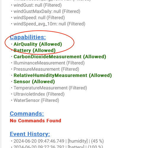

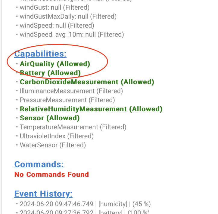

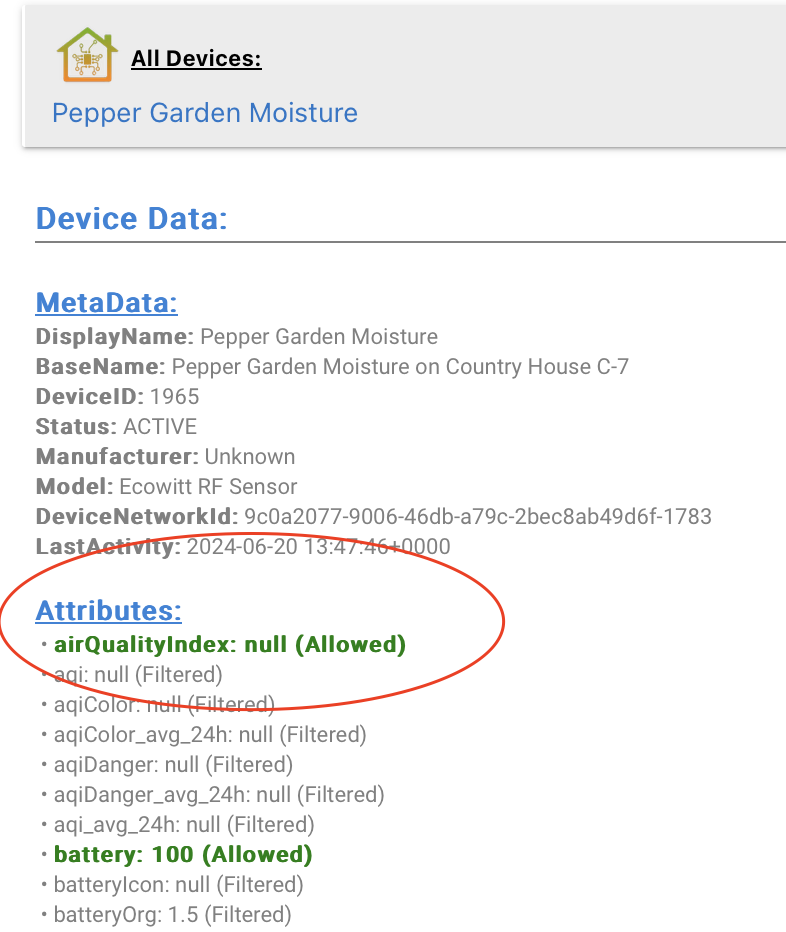

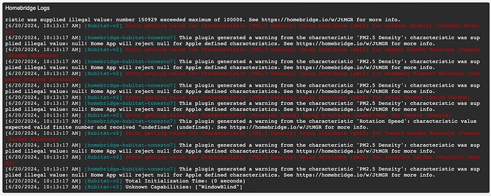

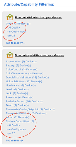

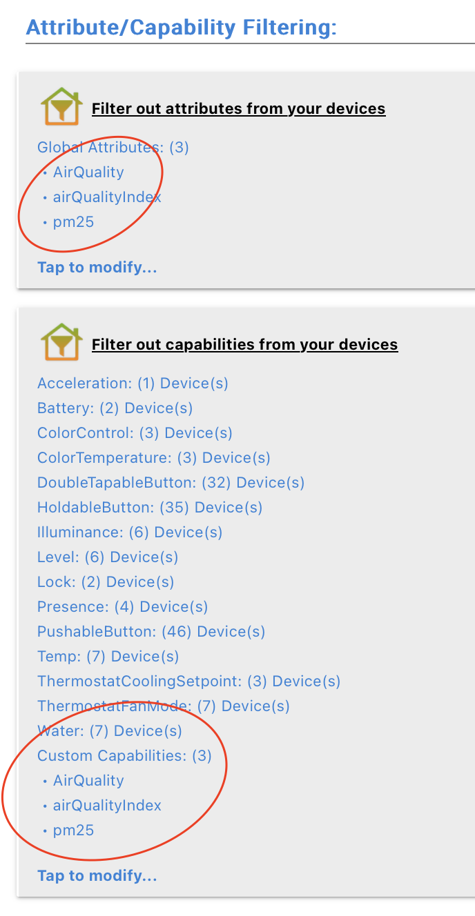

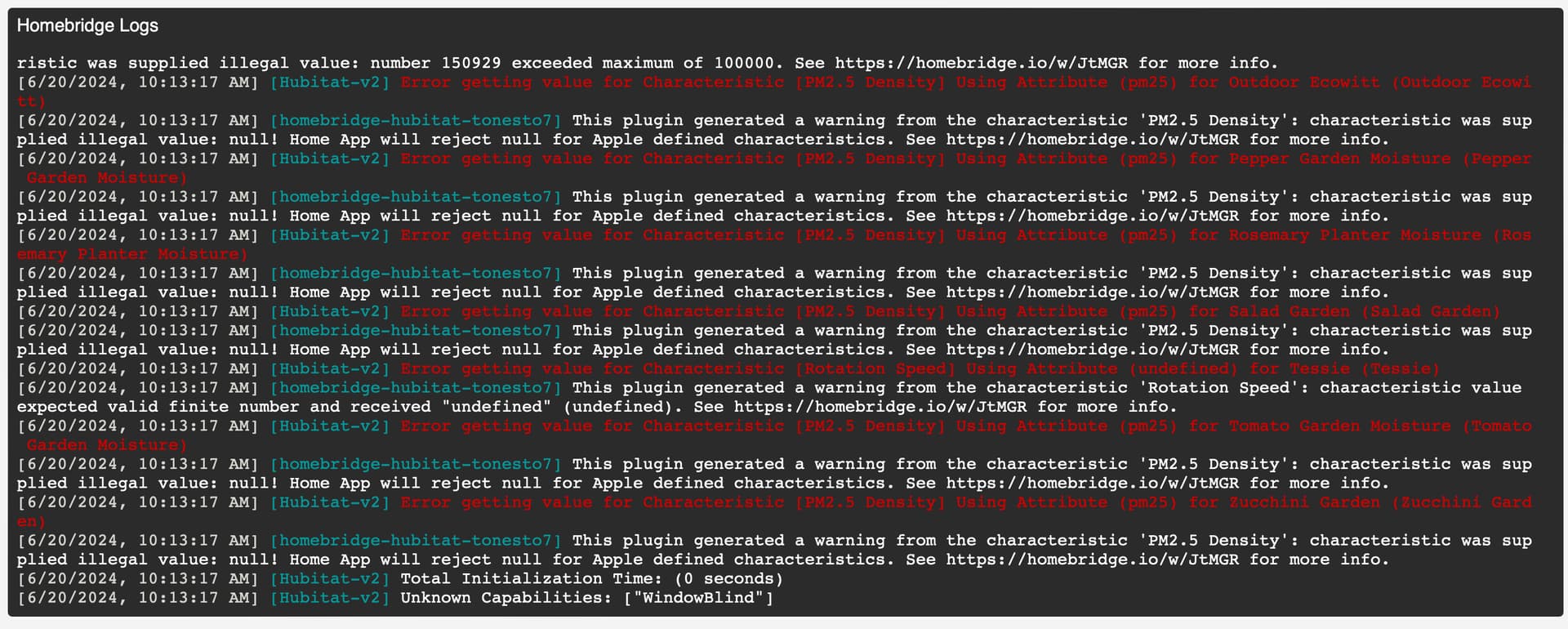

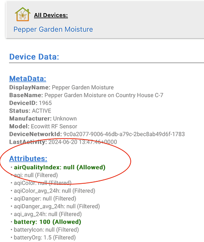

Looking to get some help with attribute and capability filtering. I have some garden soil sensors that I have added to HHv2. They come with extra capabilities (all I need is moisture), and I'm able to filter most of these out with the standard filters (water, illuminance, etc.), but there's no standard filter for Air Quality, which is still showing up in HomeKit. So per the instructions, I viewed the debug data (shown below) and found the Air Quality parameters. I have added these globally to both capability and attribute filtering (shown below), but Air Quality still get sent to HomeKit (I realize that I have added the attributes and capabilities to both sections, but this was just my second attempt to get them to work, in case they needed to be in both sections). I'm also getting Homebridge log errors for PM 2.5 (shown below), which I have also tried to filter out, but that also still produces errors with filtering applied.
I've never been able to get custom filters to work. I tried in the past and gave up. But I've had enough! :grinning:. Any help would be greatly appreciated. Sure I'm missing something stupid.
Sample Device Debug Data
Summary

pm25 Log Errors
Summary
