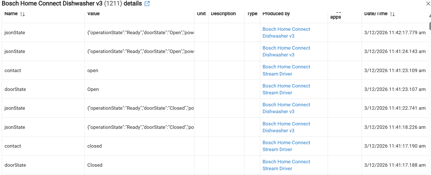

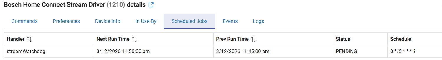

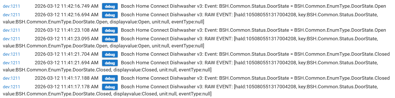

Scheduled job appeared:

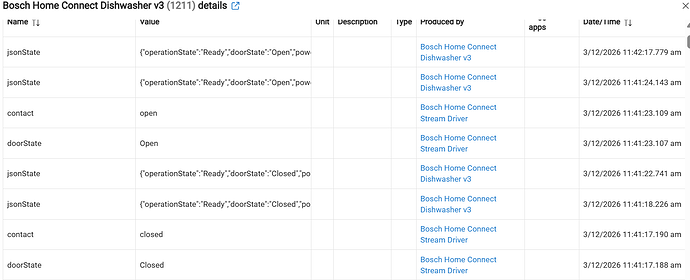

And I'm getting Open/Close events as noted...below is starting from open state, close, wait 5s, then open.

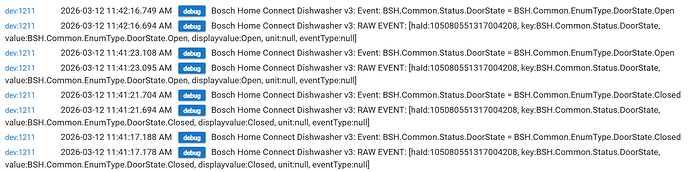

And from device events:

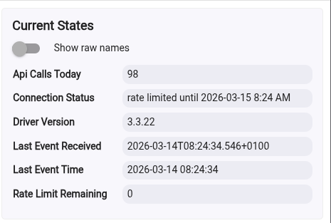

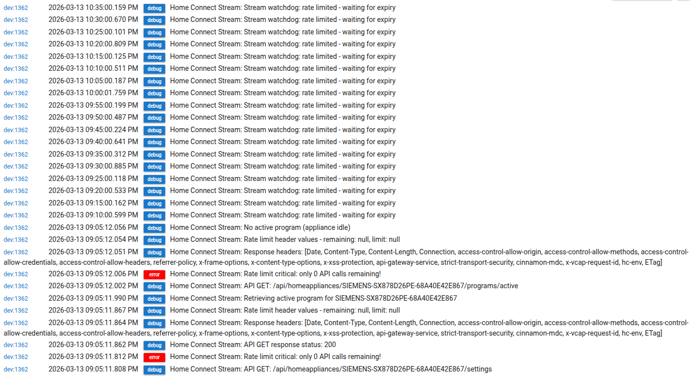

@craigde Something seems to be wrong with my installation, but I don't know why or what.
Still no luck with my status updates.
Interestingly (on a bad way) my connection status doesn't show connected. Now it says the following:
Furthermore it looks like my installation is too chatty?

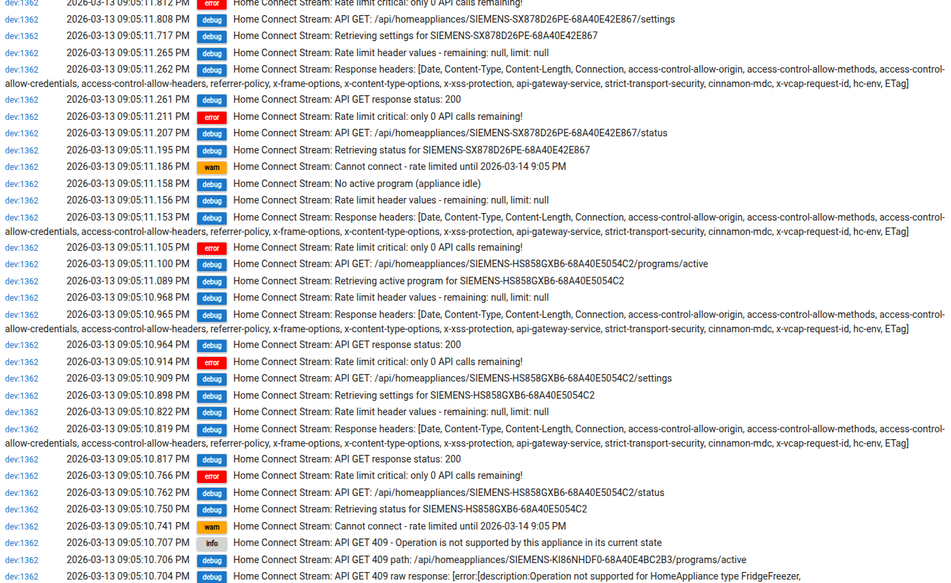

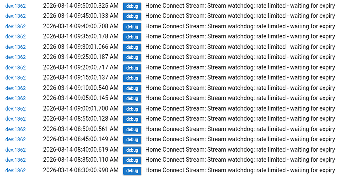

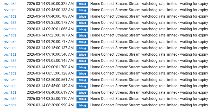

Here some logs from my stream driver, hopefully that helps you

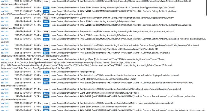

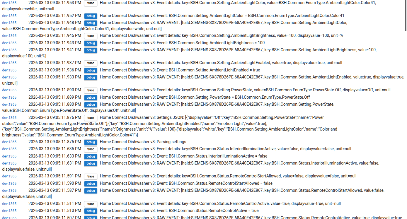

In addition some logings from my dishwasher
Hopefully that helps to get an idea what's going on or wrong with my installation.
Thanks in advance for your support
Hi @jb1 Looking at your logs I think I see what's happening. The rate limit expires, the driver reconnects, and then it immediately fires off 9 API calls (status + settings + programs for each of your 3 appliances) to refresh device state. Those calls are hitting Home Connect's rolling 24-hour window before it's fully reset, which triggers a brand new 24-hour rate limit. You're stuck in a loop.

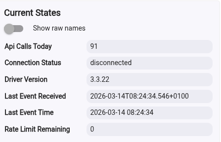

@craigde Firstly thanks for your support.
I followed your description. After hitting Clear rate limit and waiting a couple of minutes I pressed Initialize. The status shortly changed to connected than to disconnected.
Is it good or bad, I have no clue :slight_smile:

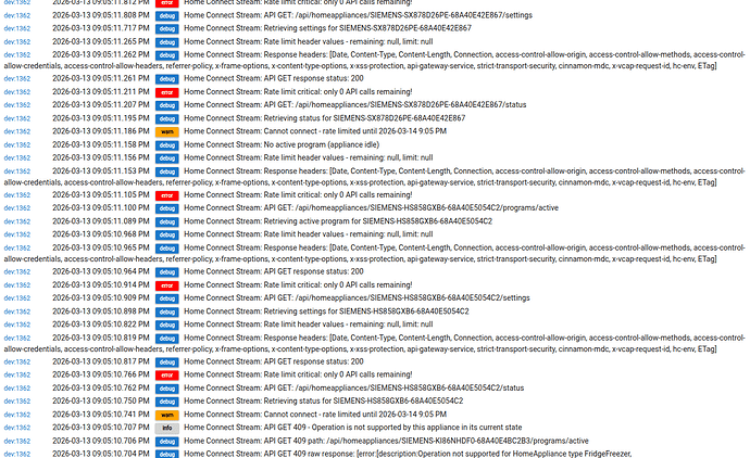

@jb1 Thanks for the logs and device screenshot. I just pushed an HPM update to 3.3.23 for you
What's happening: Home Connect's server is still rate-limiting your account (likely for 24 hours). When you cleared the rate limit and clicked Initialize, the stream briefly connected but Home Connect immediately sent a rate limit error back through the SSE stream, re-setting the local rate limit. The v3.3.22 code had a bug where the disconnect event then overwrote the "rate limited until..." status with just "disconnected", hiding the actual rate limit from you.
What the fix does (already pushed):
  • Connection status will now correctly show "rate limited until [time]" instead of misleading "disconnected"
  • Watchdog logs will show the actual expiry time and minutes remaining
  • Brief connection bounces won't trigger API calls that would worsen the rate limit
What to do now: Install the update. Wait for the server-side rate limit to fully expire (the updated driver will show you exactly when), then the watchdog will auto-reconnect. Don't click Initialize until then.

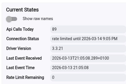

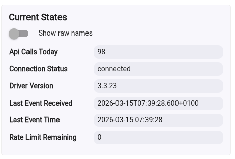

After an update of the driver to v3.3.23 I now see the exact time instead of disconnect. Will wait until 8.24 am tomorrow morning before doing anything. Will see what happens at 8.24 am tomorrow morning. As I understood correctly I need to press Initialize afterwards.
Fingers crossed all is going back to normal.
Again thanks a lot for all your time and support. Your are really outstanding........
