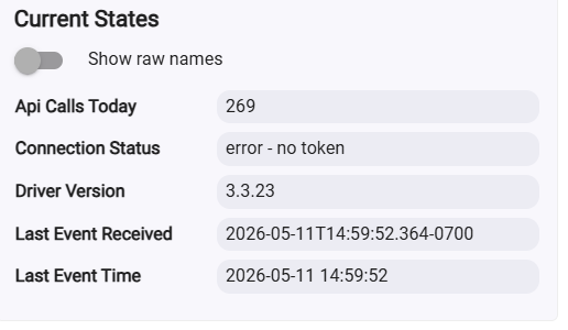

Something up this AM...just me, or? TL;DR: Stream device showed no OAuth token in Connection Status, errors in logs. Had to re-auth using Parent app and then use Refresh in Stream device to go from "error - no token" > "disconnected" > "connected."
I'm on the most recent HE platform beta (2.5.0.141), but nothing in there I'm aware of that would affect Home Connect...

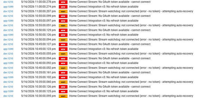

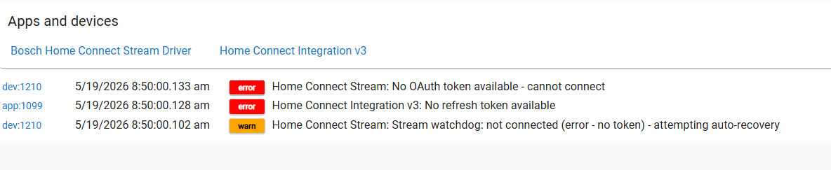

Looking at logs, I only go back to the 16th, but it's been this way since at least then...
I re-authenticated via the parent app, but that didn't help, still getting the "no token" errors...

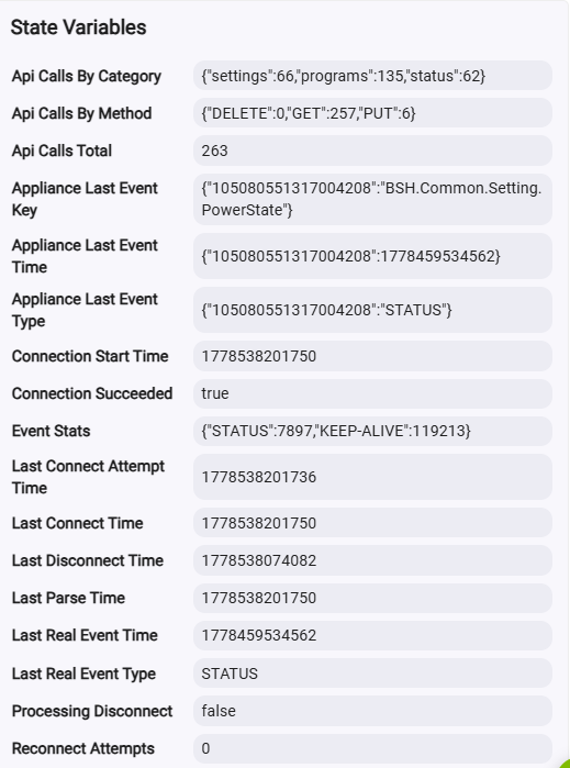

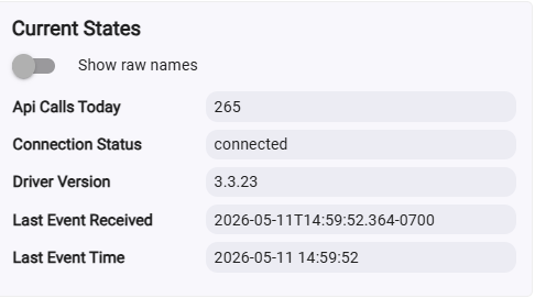

Ah....I went back into the Connect Stream Driver device and hit Refresh (had done this earlier before re-authing to no avail) and this time it updated to Disconnected and then changed to Connected.
Any thoughts on why I had to re-auth?
I saw the same thing at the same time. I suspect something on the back end HC side was changed that invalidated all the tokens.
Cool, good to know it wasn't something I'd done to mess things up somehow. :slight_smile:
Nice of them to release a breaking change...with no warning. :wink:
