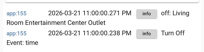

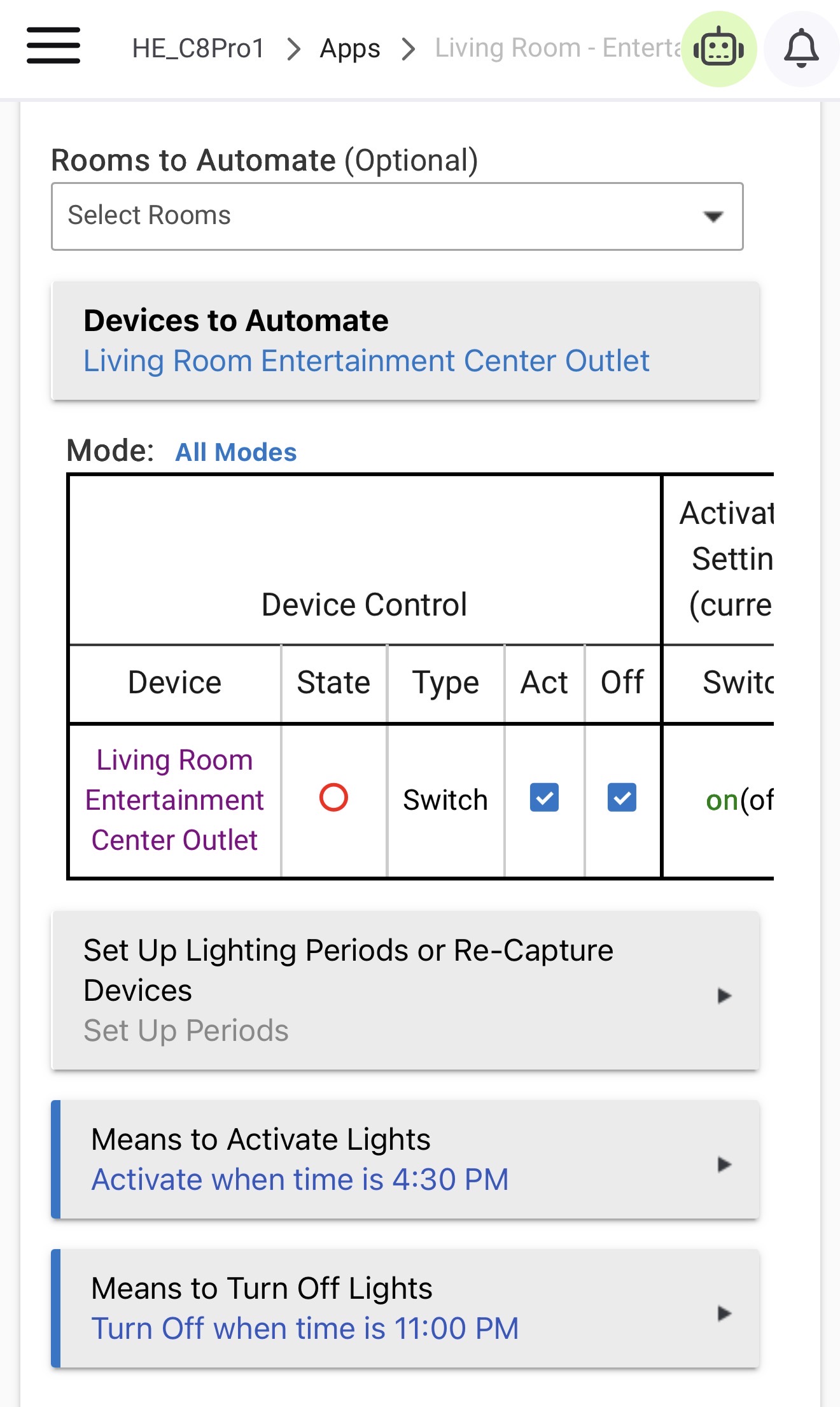

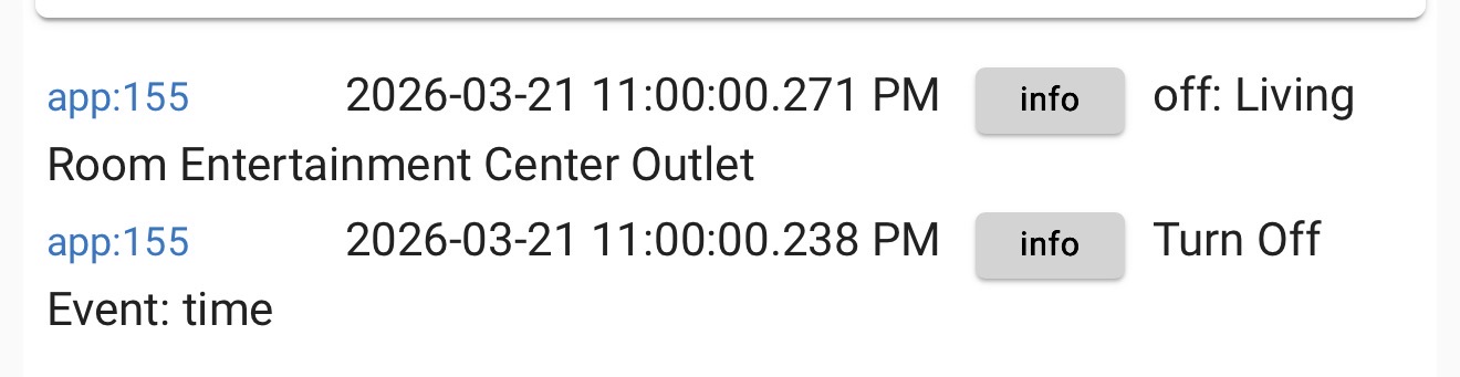

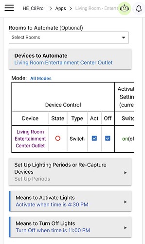

I have a two zwave plus devices and a zigbee device (all outlets) that have connected in home assistant and being brought into HE through this plugin. For these three devices I have simple room lighting rules setup to turn the outlets on at one time and off the next time. There is no day restriction or mode restriction on the rule.
The issue is that while the rule turns on successfully, the turn off is not and often these outlets are still in a β€œon” state even when logs in HE show that the run ran successfully. Clarification, it’s random that the device switches off successfully when the rule fires off. More time then not it’s not successful but occasionally it is.
I don’t know where else to look but it’s making me think that the command is t being passed to HA for some reason even though HE says it fires off.
I doubt this is related to HADB. Nonetheless, these logs only show the simple room app. In order to see what is hapening on HADB you need to enable debug logging and info logging on the HADB driver. Optionnally you can also enable those on the component switch itself.
This will show what command is received by HADB and what what the response from HA.
