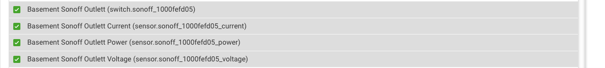

I have configured one Outlet device as such:
But only the voltage & power show up as child devices of the bridge device:
Any idea what I am missing? I turned on Debug in case you need any logging.
Child devices only appear if Home Assistant sends a status update for the Attribute in question. Try turning the HA outlet on/off and you should see a Child Switch device appear on Hubitat.
That did it, thank you.
