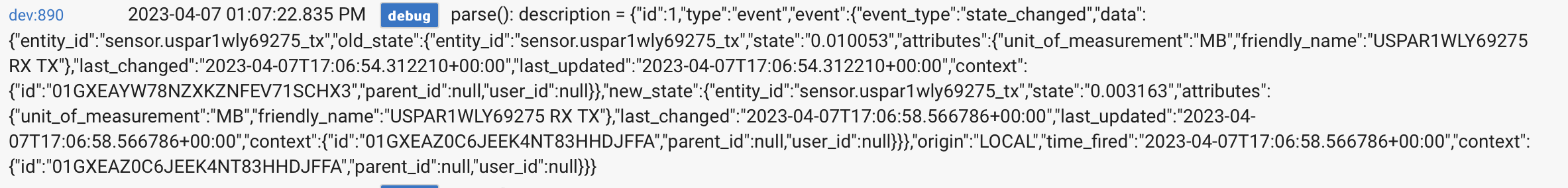

I don't know if this is related but my hub has been complaining about severe load since I installed the bridge.
I'm also getting lots of debug messages but debug is not turned on. I turning it on and off but still getting lots of messages.
43863665 ms is over 12 hours... obviously something is very wrong.
That device 890 is reporting transmit data in MB. Probably your router. Is there entries in your log that pertain to other devices to show us?
I only selected two devices - both Abode sensors. I then disabled one and the other one caused the same crazy amount of traffic. So I de-selected both of them and still high traffic. I will try reinstalling it.
If you want us to help you troubleshoot, we need to see some logs.
The amount of traffic does not depend on the number of devices selected: All events from all your devices will be processed no matter what you have selected. (the log you showed us is an example: you did not selected the router but its reporting gets through the bridge anyway).

As best as I can tell it is repeating the snippet I posted above for every entity in HA and doing it continuously. I went through the logs and I don't (yet) see one entity more than any other.
Yes, all event messages will look similar. Still, the info they are giving should be a clue to what is happening.
