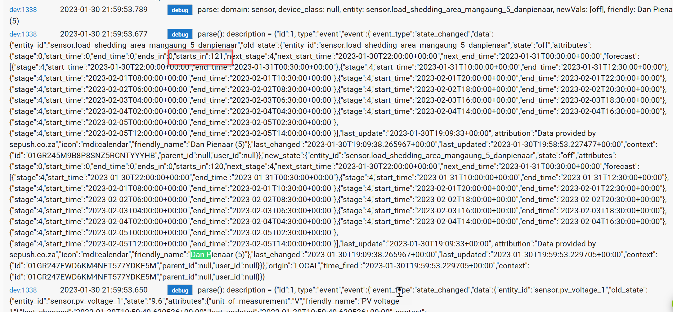

Does this help?
(I have changed from Cape Town to my local area, in case you are wondering why it is now Dan Pienaar and not Cape Town)

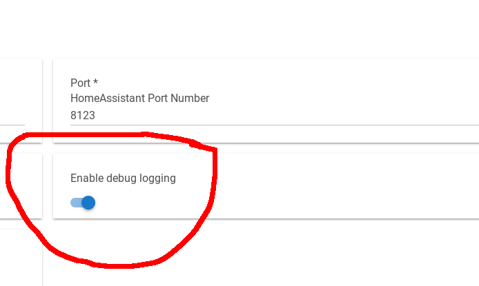

Nop, You need to enable debug logging:
It will give you entries like this in the log:
It is the log for the parent device that we need, not the one from the specific entity.
Sorry, I had the wrong device. Think I've got it now. Sorry about that.
dev:13382023-01-30 21:59:53.789debugparse: domain: sensor, device_class: null, entity: sensor.load_shedding_area_mangaung_5_danpienaar, newVals: [off], friendly: Dan Pienaar (5)
dev:13382023-01-30 21:59:53.677debugparse(): description = {"id":1,"type":"event","event":{"event_type":"state_changed","data":{"entity_id":"sensor.load_shedding_area_mangaung_5_danpienaar","old_state":{"entity_id":"sensor.load_shedding_area_mangaung_5_danpienaar","state":"off","attributes":{"stage":0,"start_time":0,"end_time":0,"ends_in":0,"starts_in":121,"next_stage":4,"next_start_time":"2023-01-30T22:00:00+00:00","next_end_time":"2023-01-31T00:30:00+00:00","forecast":[{"stage":4,"start_time":"2023-01-30T22:00:00+00:00","end_time":"2023-01-31T00:30:00+00:00"},{"stage":4,"start_time":"2023-01-31T10:00:00+00:00","end_time":"2023-01-31T12:30:00+00:00"},{"stage":4,"start_time":"2023-02-01T08:00:00+00:00","end_time":"2023-02-01T10:30:00+00:00"},{"stage":4,"start_time":"2023-02-01T20:00:00+00:00","end_time":"2023-02-01T22:30:00+00:00"},{"stage":4,"start_time":"2023-02-02T06:00:00+00:00","end_time":"2023-02-02T08:30:00+00:00"},{"stage":4,"start_time":"2023-02-02T18:00:00+00:00","end_time":"2023-02-02T20:30:00+00:00"},{"stage":4,"start_time":"2023-02-03T04:00:00+00:00","end_time":"2023-02-03T06:30:00+00:00"},{"stage":4,"start_time":"2023-02-03T16:00:00+00:00","end_time":"2023-02-03T18:30:00+00:00"},{"stage":4,"start_time":"2023-02-04T02:00:00+00:00","end_time":"2023-02-04T04:30:00+00:00"},{"stage":4,"start_time":"2023-02-04T14:00:00+00:00","end_time":"2023-02-04T16:30:00+00:00"},{"stage":4,"start_time":"2023-02-05T00:00:00+00:00","end_time":"2023-02-05T02:30:00+00:00"},{"stage":4,"start_time":"2023-02-05T12:00:00+00:00","end_time":"2023-02-05T14:00:00+00:00"}],"last_update":"2023-01-30T19:09:33+00:00","attribution":"Data provided by sepush.co.za","icon":"mdi:calendar","friendly_name":"Dan Pienaar (5)"},"last_changed":"2023-01-30T19:09:38.265967+00:00","last_updated":"2023-01-30T19:58:53.227477+00:00","context":{"id":"01GR245M9B8P8SNZ5RCNTYYYHB","parent_id":null,"user_id":null}},"new_state":{"entity_id":"sensor.load_shedding_area_mangaung_5_danpienaar","state":"off","attributes":{"stage":0,"start_time":0,"end_time":0,"ends_in":0,"starts_in":120,"next_stage":4,"next_start_time":"2023-01-30T22:00:00+00:00","next_end_time":"2023-01-31T00:30:00+00:00","forecast":[{"stage":4,"start_time":"2023-01-30T22:00:00+00:00","end_time":"2023-01-31T00:30:00+00:00"},{"stage":4,"start_time":"2023-01-31T10:00:00+00:00","end_time":"2023-01-31T12:30:00+00:00"},{"stage":4,"start_time":"2023-02-01T08:00:00+00:00","end_time":"2023-02-01T10:30:00+00:00"},{"stage":4,"start_time":"2023-02-01T20:00:00+00:00","end_time":"2023-02-01T22:30:00+00:00"},{"stage":4,"start_time":"2023-02-02T06:00:00+00:00","end_time":"2023-02-02T08:30:00+00:00"},{"stage":4,"start_time":"2023-02-02T18:00:00+00:00","end_time":"2023-02-02T20:30:00+00:00"},{"stage":4,"start_time":"2023-02-03T04:00:00+00:00","end_time":"2023-02-03T06:30:00+00:00"},{"stage":4,"start_time":"2023-02-03T16:00:00+00:00","end_time":"2023-02-03T18:30:00+00:00"},{"stage":4,"start_time":"2023-02-04T02:00:00+00:00","end_time":"2023-02-04T04:30:00+00:00"},{"stage":4,"start_time":"2023-02-04T14:00:00+00:00","end_time":"2023-02-04T16:30:00+00:00"},{"stage":4,"start_time":"2023-02-05T00:00:00+00:00","end_time":"2023-02-05T02:30:00+00:00"},{"stage":4,"start_time":"2023-02-05T12:00:00+00:00","end_time":"2023-02-05T14:00:00+00:00"}],"last_update":"2023-01-30T19:09:33+00:00","attribution":"Data provided by sepush.co.za","icon":"mdi:calendar","friendly_name":"Dan Pienaar (5)"},"last_changed":"2023-01-30T19:09:38.265967+00:00","last_updated":"2023-01-30T19:59:53.229705+00:00","context":{"id":"01GR247EWD6KM4NFT577YDKE5M","parent_id":null,"user_id":null}}},"origin":"LOCAL","time_fired":"2023-01-30T19:59:53.229705+00:00","context":{"id":"01GR247EWD6KM4NFT577YDKE5M","parent_id":null,"user_id":null}}}
The Start_In is the data I would like to have in HE. It indicates the time before the next black out starts.
