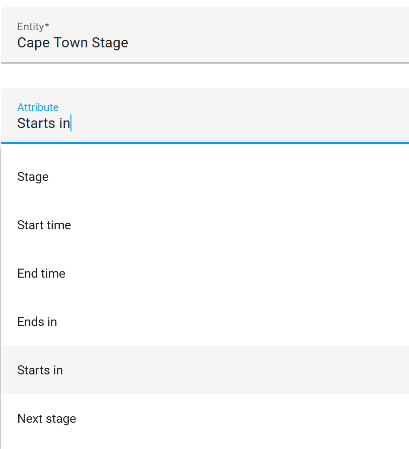

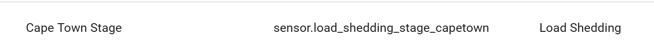

There's an add-on available for Home Assistant that pulls the schedules into HA from the internet. I set up HA in the hope that with the help of that add-on, I can access that information in HE. One of the entities the HA add-on creates, has an attribute "Starts In" which contains the time before the blackout starts (in minutes, e.g. "183"). I want to use this info to set up a rule in webCore that tests if my solar batteries' state of charge is high enough to last through the blackout, say, an hour before the scheduled blackout begins. If the state of charge is too low to last the 2.5 hour blackout, I want to change the solar inverter settings to draw power from the grid to charge the batteries so they have enough capacity to last for the duration of the black out. (I can change the inverter's settings from HE for this.)
The device where the information is stored in HA pulls through to HE with HADB, but unfortunately, not the attribute containing the information I need. (The Device Type assigned in HE is Generic Component Unknown Sensor
