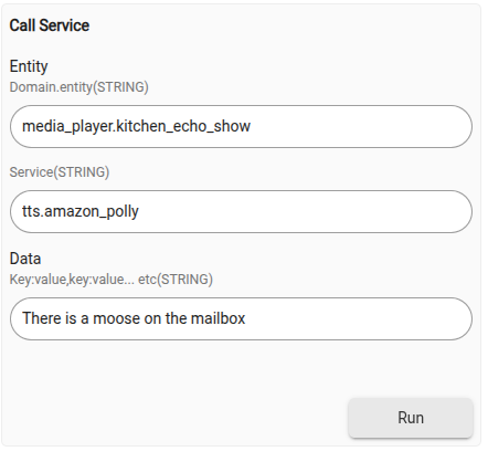

Not having any alexa device, I can only guess your entities.
TTS still not working. I'll send you a PM with details to keep it out of the thread (because I think it is HA and not HADB).
If HADB brought over the notify._speak and notify._announce entities, those could get mapped to component devices with a capability "Notification" and invoke the callService directly. They'd just be directly usable in HE anywhere notification was wanted.
I created a pull request to implement this change.
With this change, if you import from HA the Alexa _speak and/or _announce entities, you can just sent notifications to them from the regular notification selection. E.g.,
(this sends a push to my app, an email via the new built-in mail notifier, and makes an announcement (with a ding) on my Echo Show. The "on Net" is because HADB devices are connected to my main hub via HubMesh).
Just to note: this does not use the HA Alexa Skill, but instead just the (free) Alexa Devices integration (Alexa Devices - Home Assistant).

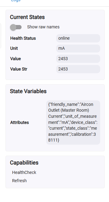

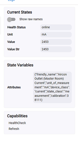

How do I get the Current (Amperage) value of my tuya wifi smart plug?
It is current registered as Generic Component Unknown Sensor
I can see the current readings in Value but I only have access to Health Status value in my dashboard.
Thanks in advance
HADB does not specifically support "current class sensors". This why it falls under unknown sensor but it could be easely added.
As for showing in easy dashboard, I think it does not support custom attributes (not sure about that one).
Version 2.27:
  • Add support for current sensor entities.
@KuehDadar Since your device is allready created, you should manually replace the device driver with the new "HADB Generic Component Current Meter" driver.
As for the Easy Dashboard, it doesn't seems to support that capability either.
Updated to new driver.
I am using watchtower and was able to monitor and display Amperage on its dashboard.
Thank you for the quick fix.

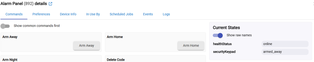

This driver would not work with HADB.
"Alarm Control Panel" in HA and "Alarm" in HE do not refer to the same thing. "Alarm" in HE is closer to "Siren" in HA (which is somewhat allready supported by HADB).
HA "Alarm Control Panel" is similar to HE "Security Keypad".
Gotcha. I have no alarms in HA to have any idea what entities are exposed, so I guessed it would be alarm capability based on the terms being used in the post.
So, maybe AI can write a driver for a Security Keypad? I really have no idea what entities are exposed in HA for this, or how HADB would translate them, so maybe not. I was just offering a quick example showing that AI could possibly write the driver.

@user920 are those commands the only one you are interesting in?
command "armAway"
command "armHome"
command "disarm"
I messaged you links for testing.
Version 2.28:
  • Add partial support for alarm_control_panel entities. thanks to @user920 for testing.
