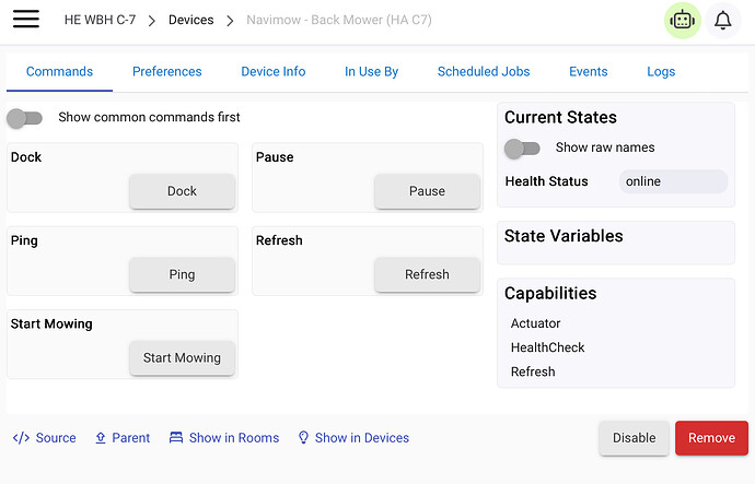

So far, so good. Child devices were properly created for both my X315 and i215 mowers and all the commands appear to work from the device page

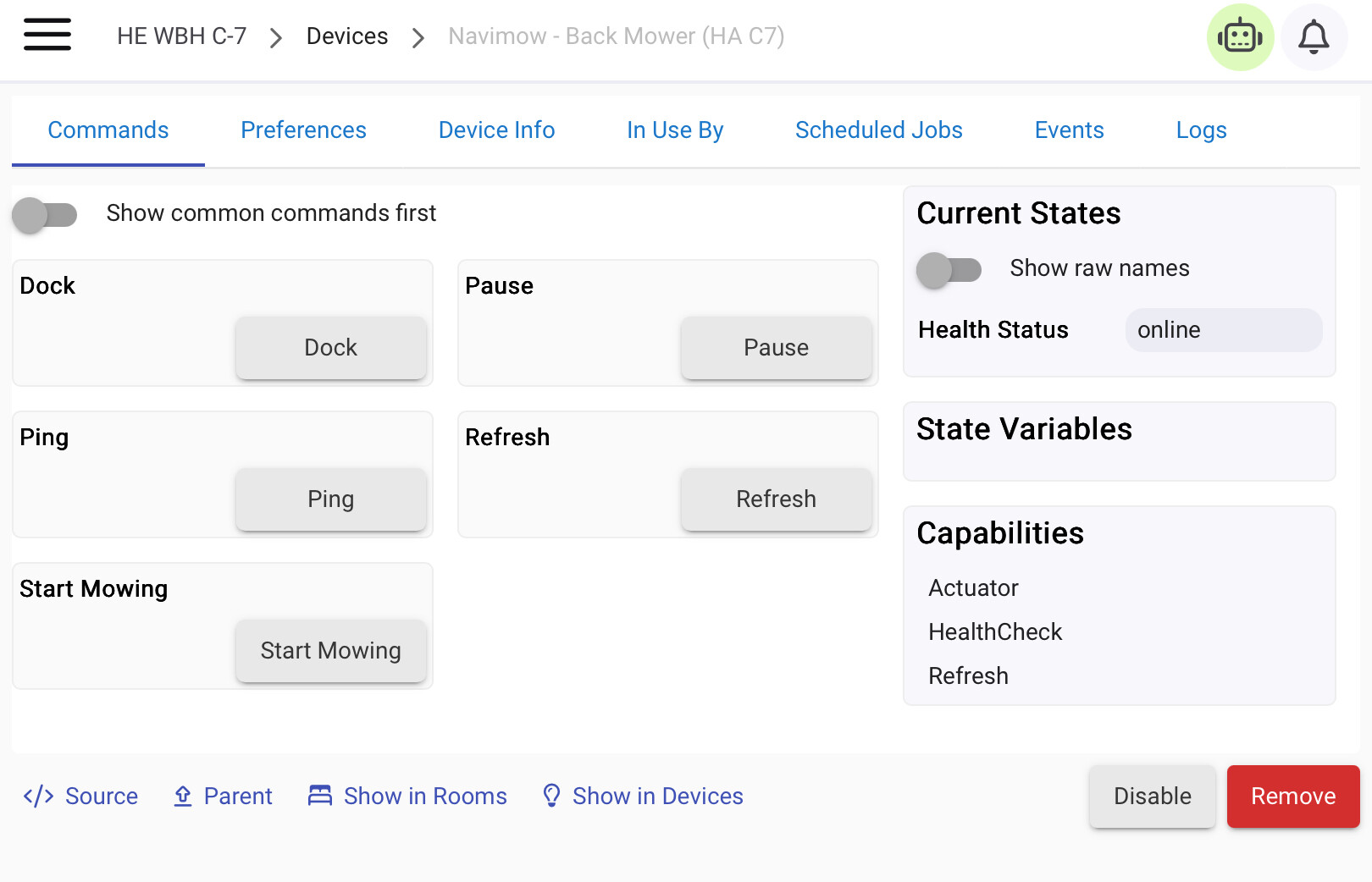

There seems to be an issue with the Lawn Mower Current State attribute displaying consistently. It periodically disappears from the Command tab leaving only “Health Status”. It seems to briefly reappear when I either send a new command (other than refresh or ping) or the Home Assistant integration possibly polls the Navimow API every few minutes.

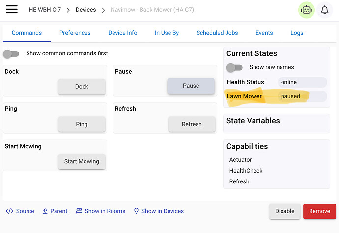

There was a typo in the LawnMower attribute name. You can redownload the component driver. It should stick now.
Updated driver now properly reflects the LawnMower attribute.
Everything seems to be working as expected. Thanks for the help! This is a great addition and saved me from needing to go down the virtual switch route. Much appreciated

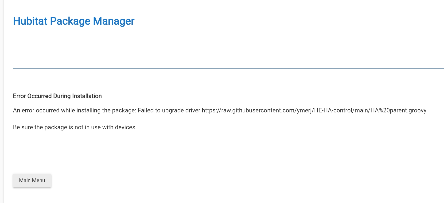

Hi im getting an error when trying to update in package manager to
2.29
Error Occurred During Installation
An error occurred while installing the package: Failed to upgrade driver https://raw.githubusercontent.com/ymerj/HE-HA-control/main/HA%20parent.groovy.
Be sure the package is not in use with devices.

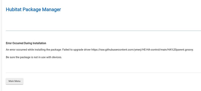

Confirming I get the same error
Trying repair results in the same error
Yes i did the same.
I received the same error. It appears to have updated the HADB app, but then failed on the parent device driver. Just mentioning to confirm the same error, but also pointing out it leaves the app upgraded, but not the drivers. I don't know if that will cause problems.
Error fixed...
