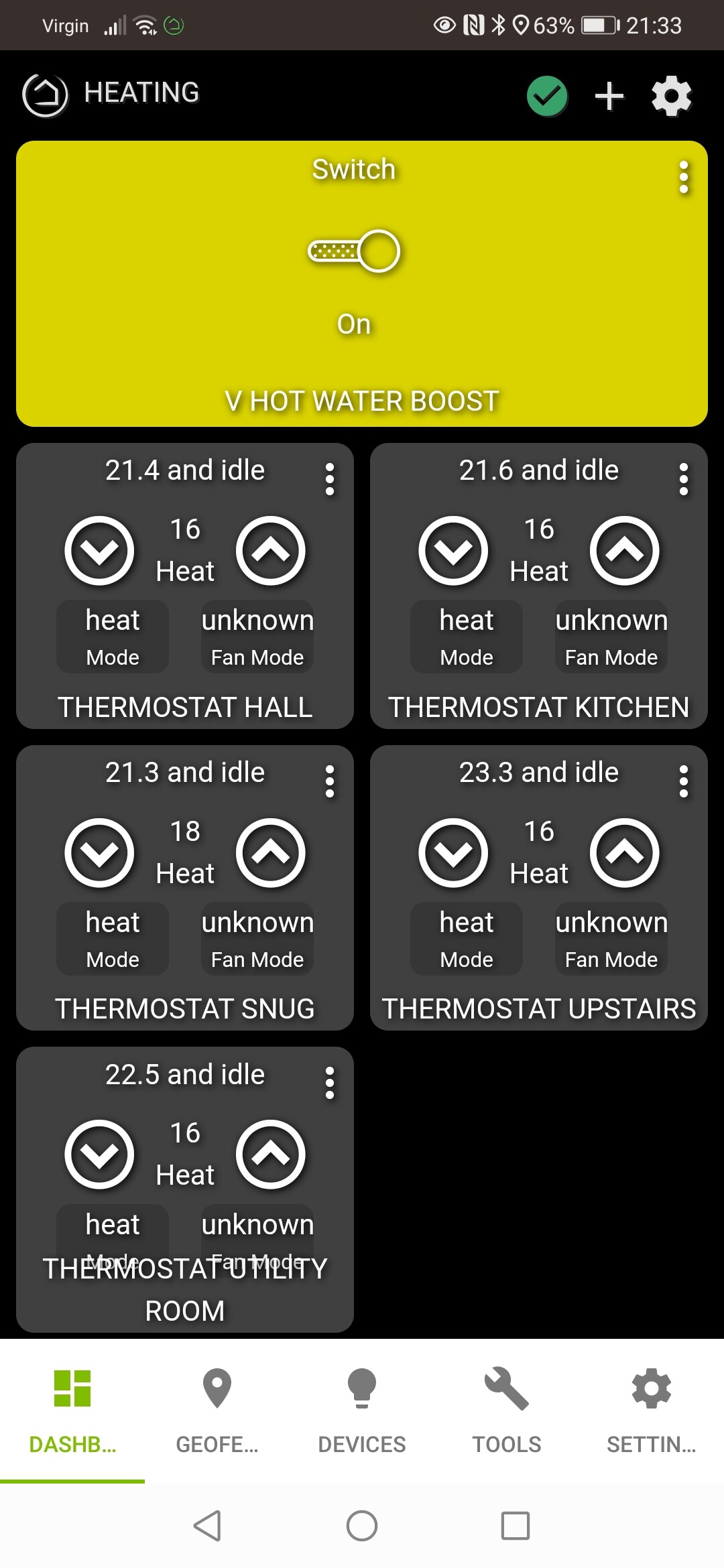

Hi guys, I'm getting to grips with this app and it's really helped me with some cool automations so thanks @cjcharles once again. Just one question, is there a way to set the thermostats to recognise the 0.5 decimal setpoint. Mine only seems to work with whole numbers. For example, if I alter my Heatmiser thermostat on the wall to 20.5 degrees. My dashboard tile will only change to 20 degrees. It appears to round down each time
Conversely, my tile, won't increment in 0.5s. If I hit the up chevron, it tries to go to 20.5 for example but then rounds itself back down to 20 degrees. It will only accept whole numbers so 21 degrees would be the next step.
Oddly heatmiser only allowed incremental changes of whole numbers until a year ago when they updated their software to accept 0.5 increases.
Any thoughts out there guys. See screenshot of whole numbered tiles. Thanks in advance
If the thermostats now allow half degrees it is a quick change to update the handler, but I had to bodge the Hubitat handler to ensure whole numbers as previously half degrees would cause give loads of errors on the Heatmiser side.... Should just need to look in the increase/decrease temperature code, or I'll try and do it in the next few weeks.
Oh great, look forwards to this enhancement.
@cjcharles do you manage to change the DH to allow half degrees. Could I have access to the new code please If it's available. Really appreciate your time
@stueyhughes
Ive just uploaded an updated version to Github which should do what you want, but has not had much testing since it is part way through a load of improvements I am trying to make to make the DTH much more useful in Hubitat (rather than just being a bodge to get an ST driver migrated accross)
Wow, that is an outstanding result and works seamlessly. Thank you so much for putting the effort into this request @cjcharles. I really am thankful.
Also, the response time in general seems better when set point is set to a whole number. So thanks again!

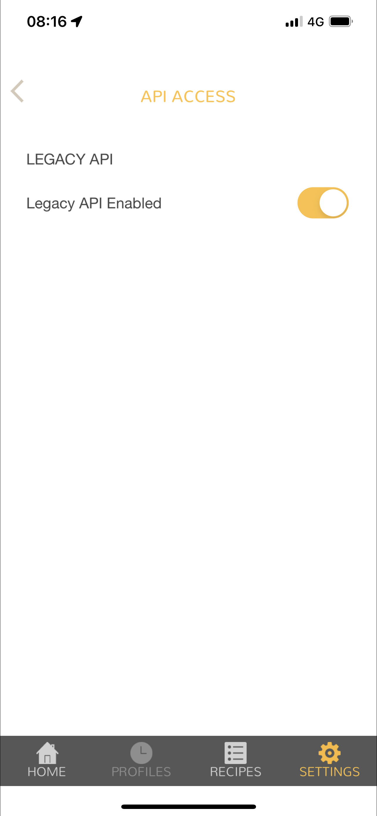

Hi all, while setting up a new IoT VLAN on my UniFi controller and migrating all my devices across to the new subnet, I ran into a confusing and persistent issue with getting the Neo Hub bridge device to communicate with the Heatmiser hub again. After days of tearing my hair out, I finally discovered that the Heatmiser hub has a (possibly new) Legacy API toggle in the hub settings. Now, I didn’t disable the legacy api, had no idea it was there or how it became disabled (maybe the hub updated when I power cycled it onto the new subnet?) but with it disabled it stops all communication between the bridge and the hub. Chris asked me to post in case this helps anyone with a similar issue.
Heatmiser have just released v3 of their api which basically requires WSS connections - the legacy local api is still supported but closes after 48 hours without use requiring manually reopening.
Are you thinking of updating to the WSS connection, @cjcharles ?
Interesting... I can't tell if that is v3 of their API for all hubs, or an API for v3 of their hub... If it's the latter then I won't be able to help as I have a V2 hub. I can't see anything related to any of this documentation in my app.

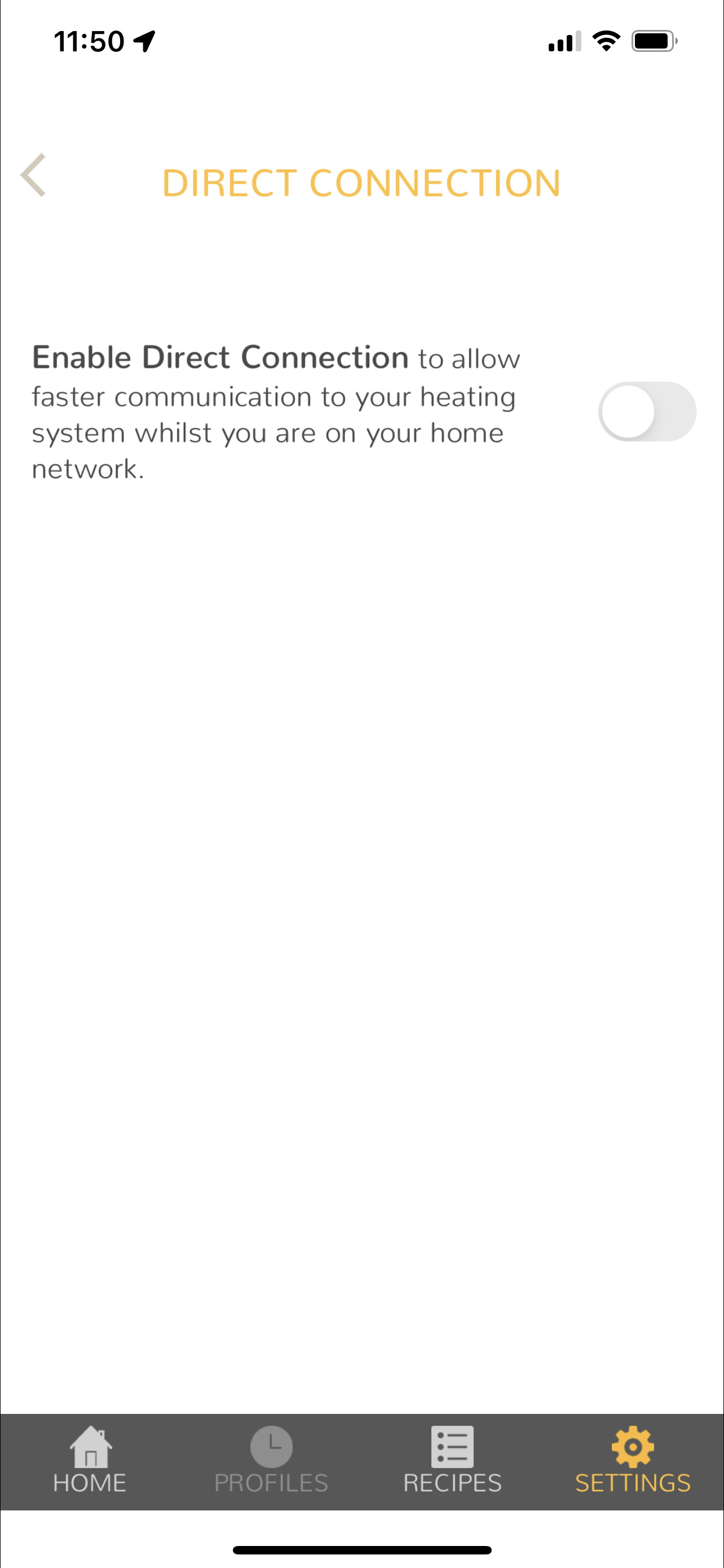

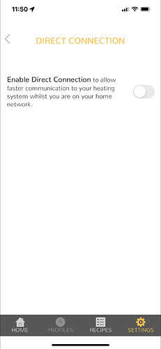

The app has updated again, now asking for direct connection to devices every time I open it, and the API screen has changed again (screenshots attached).
