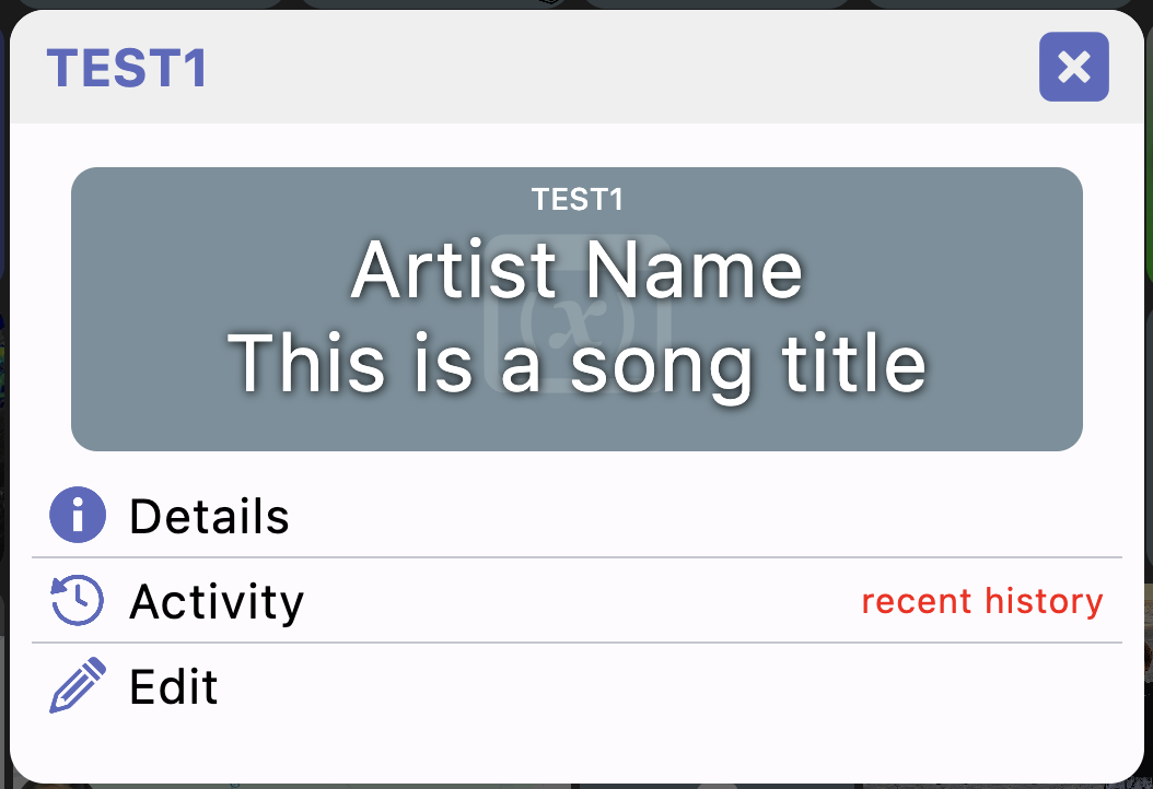

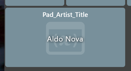

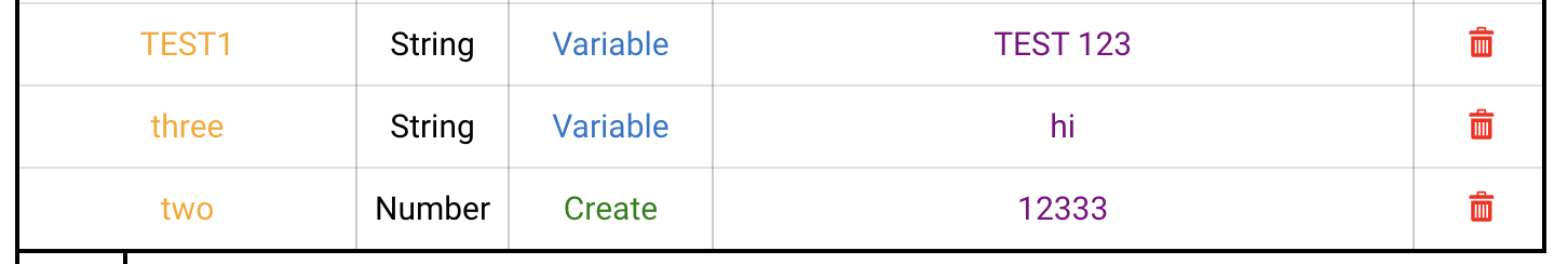

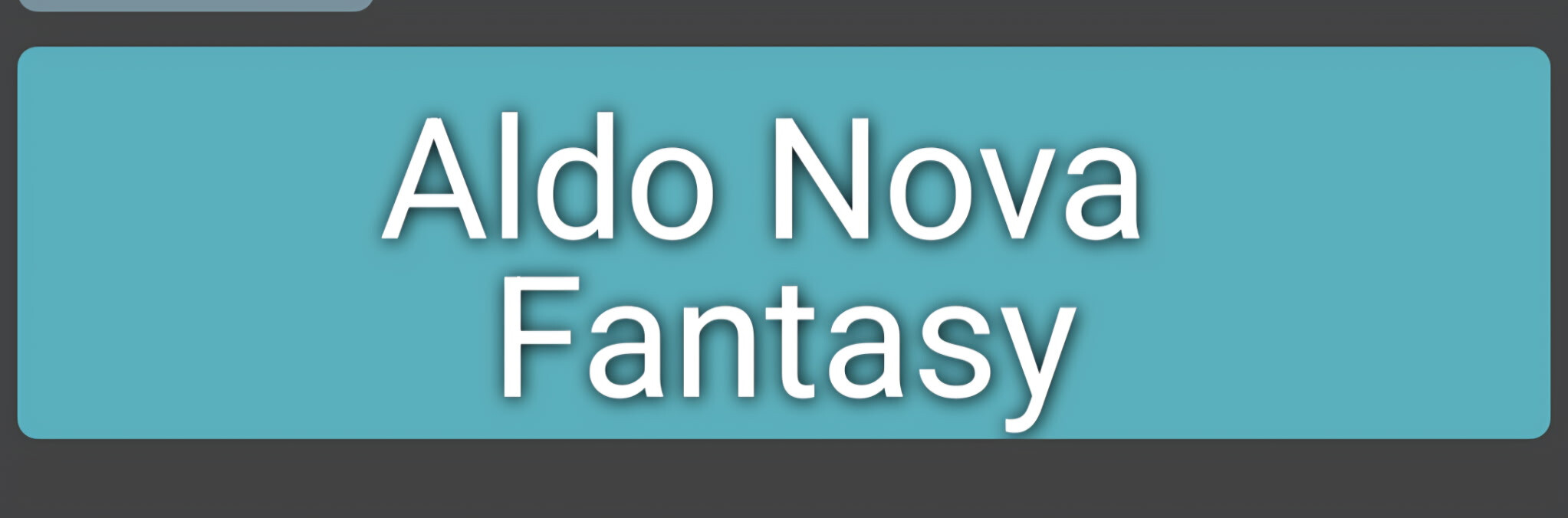

In the Windows version, I have noticed that the Variable Connector from Hubitat for a string is not handled correctly as it is in the Android version. Not sure what the problem is yet but I am working on it.
Windows version:
Android (Phone) version:

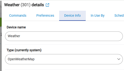

Looks like I found the culprit. I had a weather device and it was logging the following information in the log. When I removed it from Maker api, uninstalled/reinstalled, rediscovered my hub, it didn’t crash.
06-28-07:09:31 [I] 27 HD+LoginScreen: fetching devices..
06-28-07:09:32 [I] 29 HD+LoginScreen: logging in..
06-28-07:09:33 [E] UI HD+DeviceWeatherView: ForecastDayView: ERROR loading icon for Tue, url=, error: Unable to create a fetcher that supports:
06-28-07:09:33 [E] UI HD+DeviceWeatherView: ForecastDayView: ERROR loading icon for Today, url=, error: Unable to create a fetcher that supports:
06-28-07:09:33 [E] UI HD+DeviceWeatherView: ForecastDayView: ERROR loading icon for Mon, url=, error: Unable to create a fetcher that supports:
06-28-07:09:33 [E] UI HD+AppImage: ERROR: url=NA, error: Unable to create a fetcher that supports: NA
I’ll look into it. I don’t think I’ve done much testing with any of the Hubitat variable device types (number, string, date, boolean).
Let me know if there’s something I can try to reproduce this.. it’s just a regular string variable? Do you know if the device type is set to Custom or Variable String?
Awesome - thanks! Yeah that’ll help me fix it.
I did work on that weather tile.. I was trying to support another weather driver which just listed weather conditions (ie: “cloudy”) instead of giving a URL to a cloudy icon.
What weather app/device is this? The only one I’ve used is this one which works for me but maybe something’s missing.. I know there’s several options like forecast support.
Also, it should never crash regardless so I’ll make sure that’s fixed too
Thanks. I was using OpenWeatherMap.

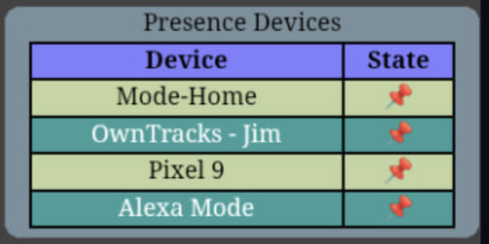

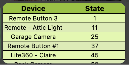

How does Tile Builder work regarding css? I know Hubitat has very strict limits on attribute sizes - 1024 - so a lot of tiles just have the attribute point back to the hub. For example my Mets tile (GameTime) has a schedule attribute that looks like this:
"schedule": "\u003Cdiv style='height:100%;width:100%'\u003E\u003Ciframe src='https://cloud.hubitat.com/api/SNIP/apps/639/gametime/639?access_token=SNIP&version=2178' style='height:100%;width:100%;border:none'\u003E\u003C/iframe\u003E\u003C/div\u003E",
The resulting page can be much larger (there’s still a limit for cloud endpoints I believe).. but, I’m assuming any css can be included in that.
Sorry if you’ve explained this before – I’m back from vacation and again realizing why this one is complicated!
Also 2 high-level notes on this one..
  1. HTML tile support is MUCH better on mobile (Android/iOS) than on desktop. The mobile platforms have a built-in ‘WebView’ widget which behaves like a mini browser. So even if the css was there I’m not sure it’ll look or work as well as mobile. If you had a Mac I’d ask you to take a look at the mobile version of the app in the Mac App Store to see if that looks better too.. I know there’s Android emulators for Windows but not sure how well they work.. probably not as well.
  2. Back when I was trying to handle HTML on desktop I considered writing a simple HTML to native parser.. the logic being that many of the ‘HTML’ tiles that people display on a dashboard aren’t really complex HTML at all.. just simple tables with some formatting. That really seems to be the case from the HTML tiles I see in your examples. The benefit of doing this is I’d basically just display it natively - no WebView needed. This would actually be huge since a WebView is a mini Chrome (Safari) browser and takes a TON of memory since it has to handle every type of HTML out there. This is why I have so few HTML tiles on my dashboards too.. displaying them natively is just faster and looks better IMO.
Anyway, I ultimately abandoned this idea since I knew no matter what I wrote it wouldn’t work for every HTML snippet and I didn’t want to try to re-create a browser. But, it sure seems like the HTML tiles in your examples could be handled. If you’re willing to send me the HTML for these tiles I can see if they could be displayed better using native parsing. Basically, what I’m looking for is:
  • what does the attribute look like? Is it a link like GameTime example above?
  • what does the resulting HTML from the link look like?
    • I’m not sure I can parse all of the css but the tables themselves look pretty simple.. is the css for text color, table background color, etc?
    • What do images look like (if any)? I do see that thumb tack image.. is it an actual image or just an emoji/unicode symbol?
Let me know.. I’m not discounting the whole external css file idea but to me that sounds so much more complex and niche use where the idea of supporting Tile Builder natively I’m guessing would be useful to many others too

Device type : variable string.
The problem seems to be in the formatting of the variable string. I have a carriage return in some of my text variables. In the Windows version, the string data after the CR is ignored. When the data is an Artist Title, the Artist and Title are separated by a CR and are never correctly displayed. The Title (of Artist CR Title) is ignored. Does this make sense?
