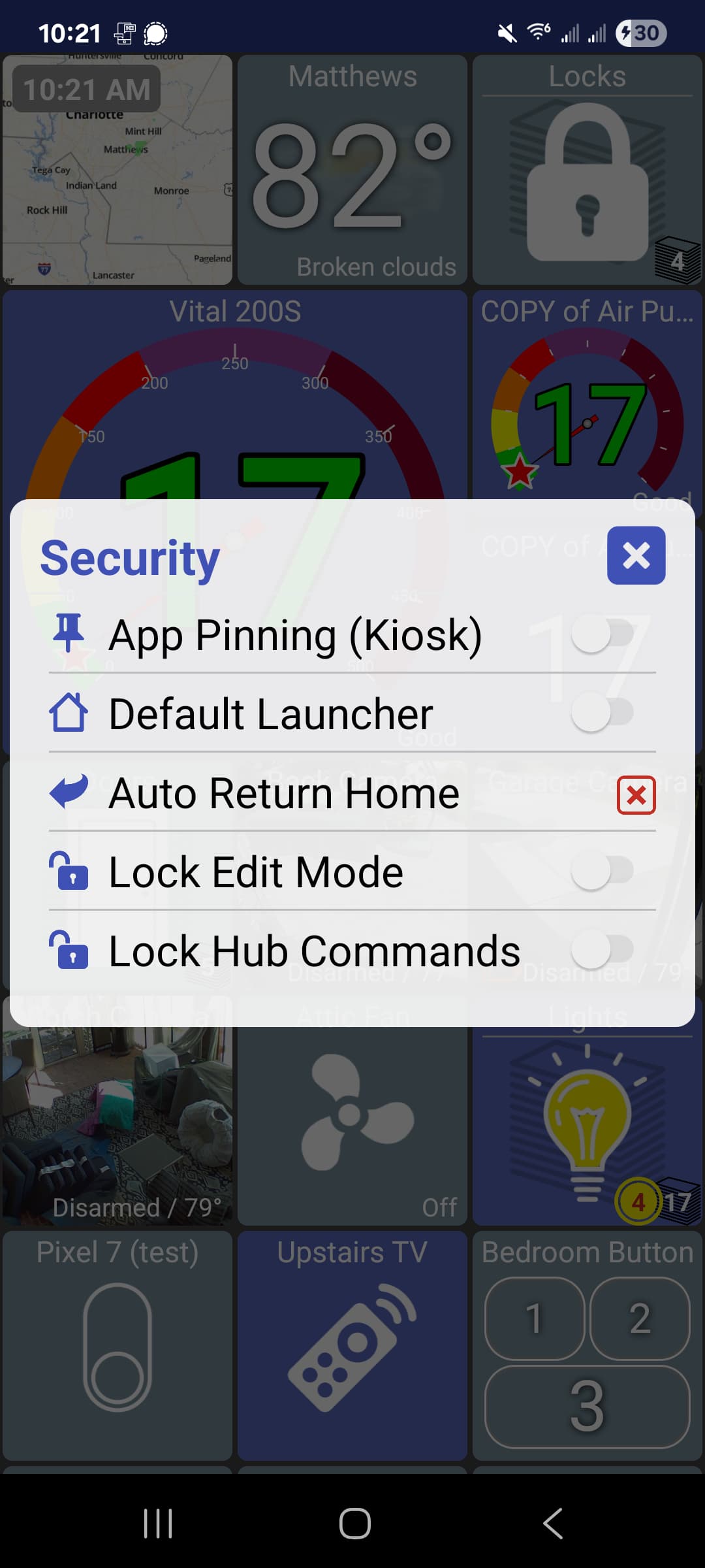

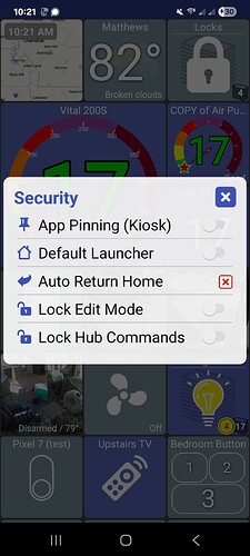

@jpage4500 & everyone else... Am I the only one having an issue where HD+ constantly auto "refreshes" itself when I'm viewing tiles on the main screen, and after the screen/tiles refresh, it auto scrolls to the top, forcing me to scroll back down to whatever tiles I was viewing before it refreshed. It happens approximately every 6 seconds... It seems to happen constantly after I open the app and scroll down to the bottom; I also see it frequently when I'm trying to edit the tile positions. I'm using a Pixel 9 Pro XL with Android 16 -- I was seeing this behavior with Android 15 too.
Thanks!
can you check the 'auto return home' setting and make sure it's disabled? That's what it does
It sounds like the app and driver aren't installed. Maybe there's some way to force re-check HPM or clear cache?
Yes, my Auto Return Home is disabled (has a red box with an "X" in it) and looks just like yours in the screenshot you shared.
