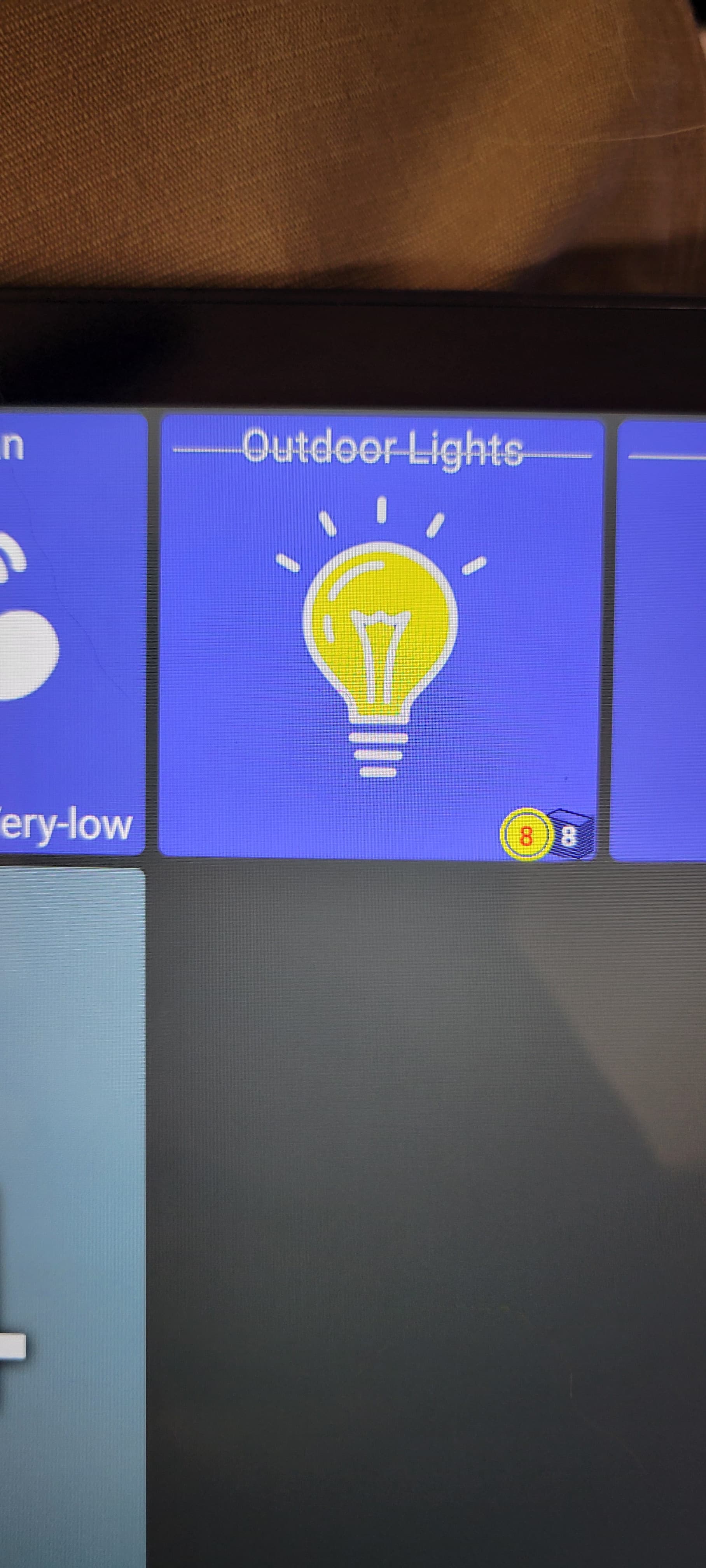

I have run into a minor issue with the tile formatting.
I've increased the size of the title and status and when I go into a folder and back out the line at the top is in it's old position, which with the text size increased is through the text.
The only thing that stops it is setting the text size back to default... I know it seems silly, but it makes the app unusable.

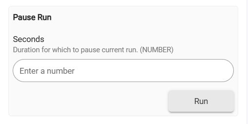

I'm using the Rachio Community app and wanted to add a feature to my dashboard that allows me to pause watering for a specific time period.
The device itself has this functionality
but I can't figure out how to incorporate it into the dashboard. Is this possible with the current version?
This might work @DGBQ but it'll depend on what the Rachio device driver has available.
  • In Settings create a Hub Variable of type number, create a connector for it and authorise it in makerapi to add it to your dashboard.
  • Create a rule that triggers on that variable changing. Its actions (if the device driver allows) would be to issue the pause run command, matching the value to the variable value.
You would just then tap the variable tile on your dashboard and enter a value in it to trigger the rule and send the command.
If you open rule machine, create a new rule, skip triggers and go straight to actions. Pick custom command and type actuator for your Rachio device and you can check in the drop down what commands it will support. That'll tell you if it's going to be possible.
Thanks, @johnwill1 , for the suggestion. While I don’t use Rule Machine, I do use WebCoRE, and I can access that attribute and populate it. Based on this, I should be able to create a Global Variable in WebCoRE (which is a Hub Variable). I just need to refresh my memory on setting up a connector—I should have some notes on that. Then I can authorise it in makerapi to add it to my dashboard.
Once the connector is in place, I can write a piston that triggers when the variable rises above 0. The piston will pass the Hub Variable to a task that pauses execution for the specified number of seconds. After the delay, it will reset the variable to 0 for the next use. I’m also considering changing the input value to minutes for easier configuration and converting it to seconds internally.

Installed the beta version, still having the issue with the title/underline :frowning:
I'll keep an eye on this post for future updates, but will have to try something else for a dashboard.
