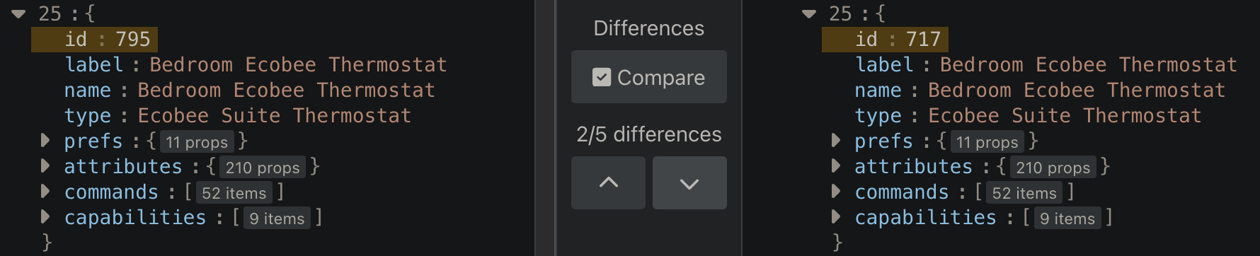

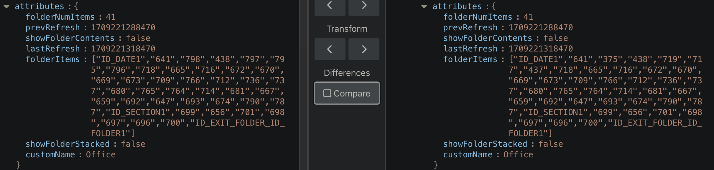

I have re-added those, but they were assigned new IDs by HE. Then I went to my dashboards' backup files and replaced the old (and now invalid) IDs by the new IDs. They were replaced in 2 places, the devices themselves and in the folderItems. All the rest remains identical.
The problem is that restoring a dashboard using the fixed file is not working as expected. The thermostats are not showing up inside the folder. Basically the dashboard looks the same after restoring. Nothing changes.
I'm inside the folder where they should show up, but they don't, still they are present in the root folder, the same way as they were before attempting any restore.
JSON files are ok, I've checked them with a JSON Lint.

first question -- what is that JSON editor/comparison tool you're using?
I would have thought just replacing any ID's that changed would be enough to fix this. Of course the IP and possibly Hub tokens if they changed too so you're connecting to the new hub and not the old one (if you have both still running).
Anyway, I can't think of why this wouldn't work.. I can see if I can reproduce it locally

Really strange issue. When I try to restore, the dashboard "blinks" for a moment, shows a dimmer level popup, and then remains as it was.
On a restore HD+ should clear everything (devices/saved prefs/etc) and then load it all from the file. I'm guessing the blink/flash is the transition from the old layout to the new one (even if they're basically the same).
Then, HD+ will connect to the Hub and get all devices. It should then check if any devices weren't returned from MakerAPI that the app has locally and will remove any that don't. That doesn't include any of the tiles you added locally.. but, if you have a device with id = "123" and MakerAPI doesn't return that device - it'll get removed from HD+ too.

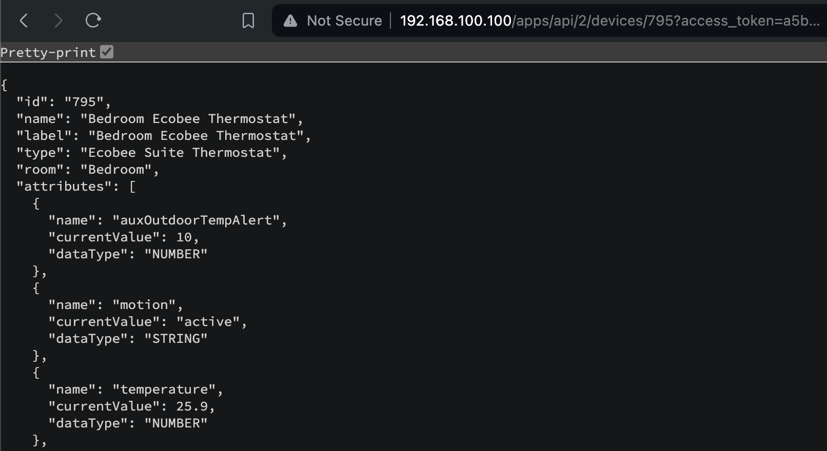

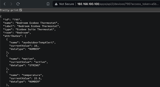

Is it possible the new devices (new ID's) aren't included in MakerAPI?
They are available via Maker API. Just to be 100% sure I have entered in the browser one test URL:
They are available in the "root" folder of HD+. They just refuse to show up inside folders :slight_smile:

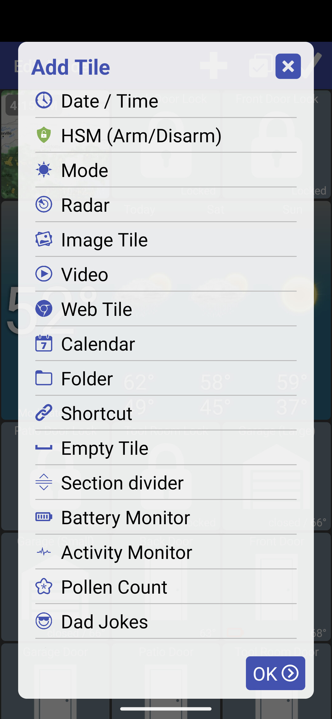

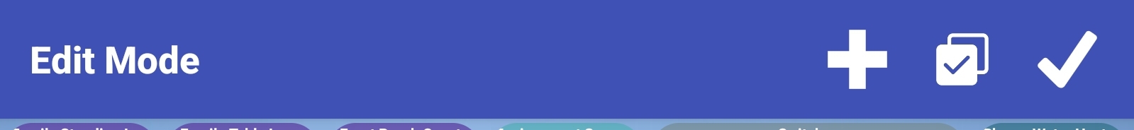

I think I'm doing something dumb, but I'm trying to add a device (battery monitor) and failing. Here's the help page I am following:
But when I go into EDIT mode, I only see the option to add a tile.
How do I add a device?
I tend to use the term device to mean an actual device, light, lock, door, etc. I've been using Tile to describe everything else that goes on a dashboard.

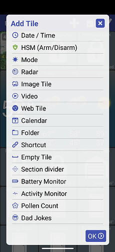

I also used to say "Add Device/Tile" in the app and now just show the "+" icon. But, that's the right place:

Thank you. When I click the + I get Add Tile like you show, but nothing between Section divider and Activity Monitor, i.e. no Battery Monitor. Do I need some certain device or permission to tell HD+ that it can use the battery monitor?
Sorry I didn't see this before. Battery Monitor should show up if there isn't already one on the dashboard. Is there one inside a folder already?

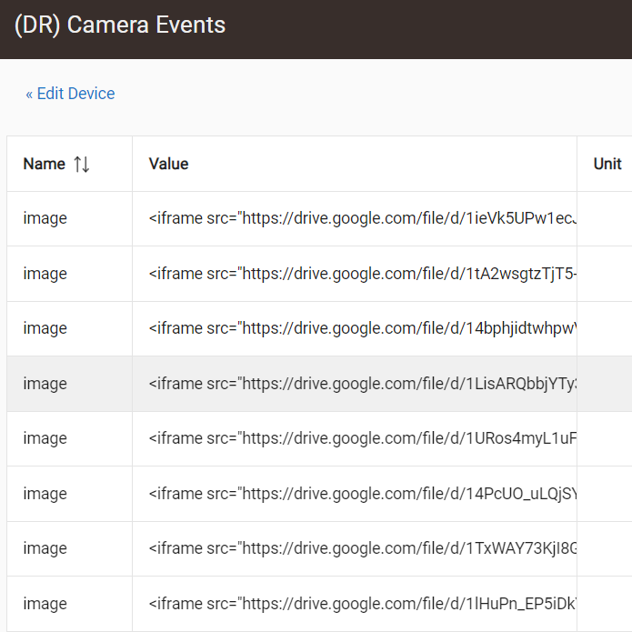

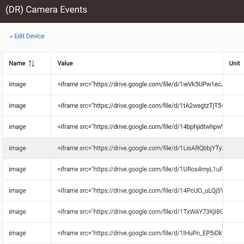

@jpage4500 has anything changed with the image ability's in the app? my nest door stopped showing in the app for some reason?
