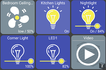

The slider itself drove me crazy when I originally had it on the tile for dimmer lights. Like you mentioned it was too easy to adjust when you were scrolling or clicking something else.

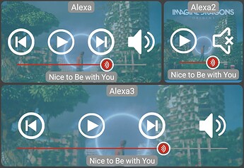

I definitely don't like the way the sound/speakers tiles look. That play button looks like a bug but I'm also not sure how the 'lock' icon is displayed in the background of that "FR Volume" tile either.

Your vertical slider made me realize that the simplest solution is to move the mute button to the left side of the horizontal slider. This means that an accidental hit of the volume sider while trying to mute doesn't suddenly blast sounds to painfully high levels. At this point I would throw out all my previous ideas and simply move the mute button to the left end of a horizontal slider. Having no overlap between the mute button & the volume control slider, as depicted on your vertical slider, is also a good idea.
Somehow horizontal feels more natural than vertical, but that feeling might simply be a reflection of being more comfortable with what I am used to.

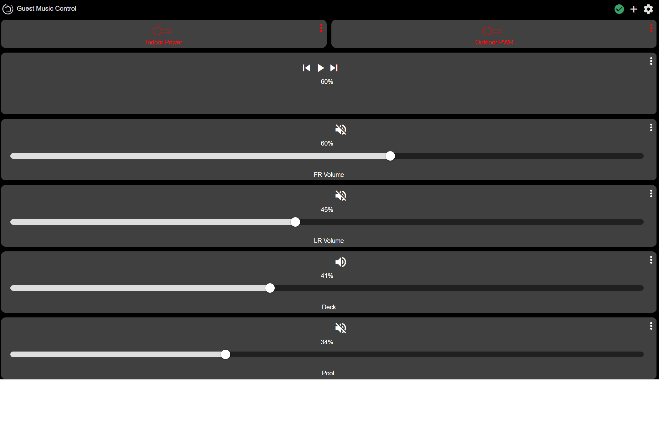

Control 4 and the Hubitat dashboard both implement horizontal sliders similar to what you have in HD+. Originally the Hubitat dashboard did not respond to hits to the mute button, but now it does. It looks like someone may have fixed this. A screenshot is below of what it looks like.
I've fully de-installed the Control 4 system that came with the house -- Control 4 is really for those that want someone else to do all the setup. I prefer DIY. In any event, their volume sliders were similar to the horizontal slider HD+ has today. I seem to recall that it had a similar issue with "fat fingering", but not certain.

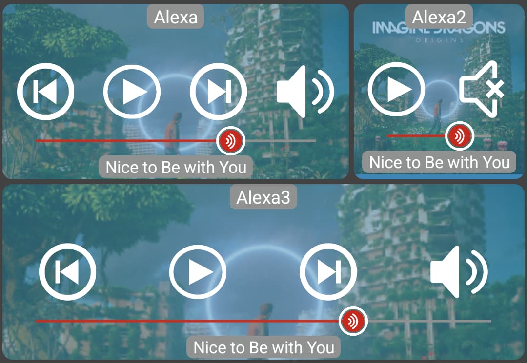

Here's what I've got so far - let me know what you think. The only way you can adjust the volume is by dragging the little icon - so accidental touches on the bar won't do anything.
The only other change which you can't see here is the song title will display up to 2 lines if necessary.
I really like it! Your decision to have only play+mute for the smallest tile is also an excellent idea!
For some reason I am thinking it would a bit more balanced if you moved the next, back, play & mute icons upwards a bit in the tile, basically centering them in the Y-direction between the bottom of the device-name text and the volume slider, but it's hard to know until you actually experience it.
The smallest tile has some text partially hidden under the "Alexa2" device name. I think it reads "IMAGINATIONS". Would be good to eliminate that, as it messes up the visuals on that tile.
Does the text scroll when this happens, or do you allocate more space to the text?
In any event, I look forward to trying this out -- it really looks great!
Marc
yeah, right now the controls are vertically centered in the tile; i'll see if I can get them centered between the slider and name
That's not text it's just part of the background album art (imagine dragons); I don't know if any devices actually support album art though (trackImage attribute)
it'll wrap to 2 lines

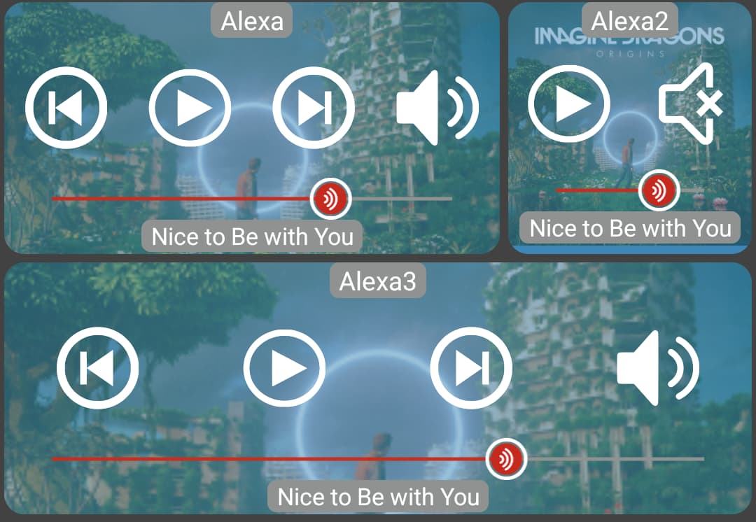

version 1.0.2172 (beta)
  • music player UI improvements
  • seekbar improvements (used for dimmer and other sliders)
Most of this was discussed above but to recap I changed the sliders/seekbars used in the app:
  • the 'thumb' icon must be dragged to change - can't just click anywhere to jump around
  • a little larger and more clear thumb icon
The only other changes are to the the music/speaker tiles. I have a follow-up change I want to make which is to make the title and status text look like the other tiles.. I originally designed this tile to have an album art image displayed but I don't think any devices make use of it so I probably don't need these anymore.. but wanted to get this version out first
