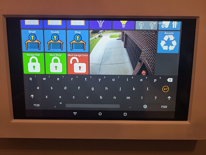

I have been seeing this often lately. Went back to a backup from early this year and this happened again today. The text input screen comes up without interaction. Thoughts?

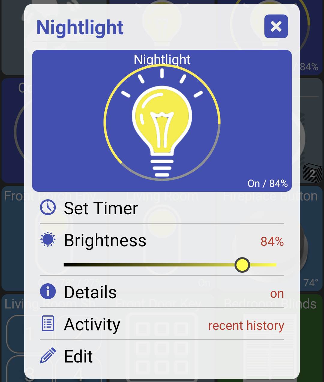

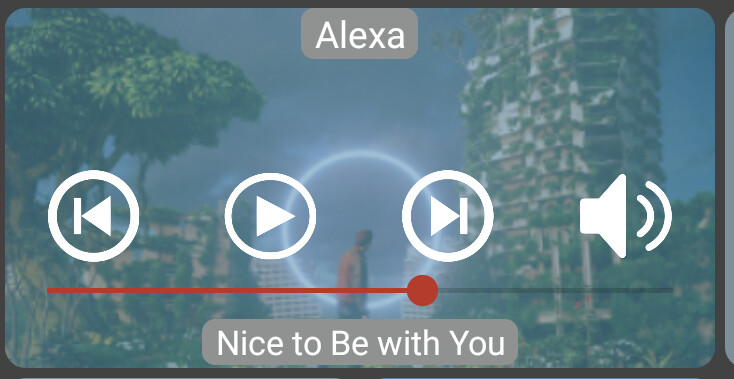

I haven't tested this device type much so I'm sure there's room for improvement. I went back and looked at it (screenshots below). Typically I've tried not to have more than 1 'action' on a tile -- certainly a small 1x1 tile. Also those sliders are too easy to accidentally touch (which is why I removed them on dimmer/lights at least by default)
My gut reaction would be to remove the volume slider and the buttons on the 1x1 tile. When you click on it I could either show a dialog with additional options or just send a command like mute or play/pause. The volume slider could still be there but in the dialog like on dimmer lights.
But, since I don't really use this device type I'm interested in how you or anyone else who uses it thinks it would work/look best? I want to keep it consistent but there's probably lots of different ways it could work

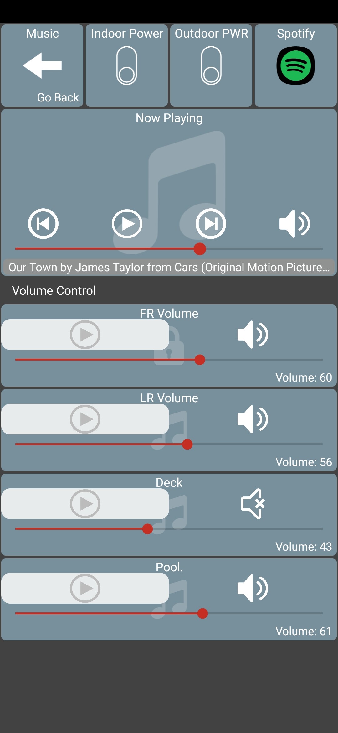

The screenshot below shows my music control dashboard. I have 4 different zones controlled by 2 different AV receivers. The "Now Playing" is a "Music Player" tile for my Sonos Port.
The 4 AVR "speaker" tiles do not do anything when I hit the "play" button and it doesn't have the skip buttons, The only functional buttons are volume and mute.
Having access to both the volume and mute control right on the tile was one of the key reasons I re-wrote my dashboards using HD+ vs. Hubitat's built-in dashboards. I'd really prefer you didn't change it to operate like a dimmer and require the opening of a dialogue box to adjust it. The ability to control the volume & mute without losing context is a fantastic experience.
An ideal outcome for my use-case would be finding some way to reduce the risk that hitting the mute button suddenly jumps the volume way up. A couple of ideas:
If the volume level change is large and lands it at a setting that is close to where the mute icon is, ignore the request. Maybe make this a selectable option in the settings.
Redesign the tile so that the volume control does not extend all the way to the right edge of the tile. Instead, have it end at about the 75% point in the X-direction and use the last 25% for the mute control.
I actual have 2 suggestions, which if done together, I think really address the usability issue I am experiencing:
Make the mute, play and skip icons smaller and put some vertical distance between them and the volume control button.
Have the volume control slider only respond if you start by putting your finger on the "red dot" and drag it to your desired new volume. Don't respond at all to simply tapping a random spot on the volume line.

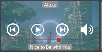

Finally, take a look at "Now Playing" tile on the new screenshot below. The HD+ device type is "music player" and in Hubitat it is a Sonos Port playing Spotify music.
I think there is the potential to make that tile more usable by moving the control icons and volume slider up, vertically, thus leaving more space for the text.
