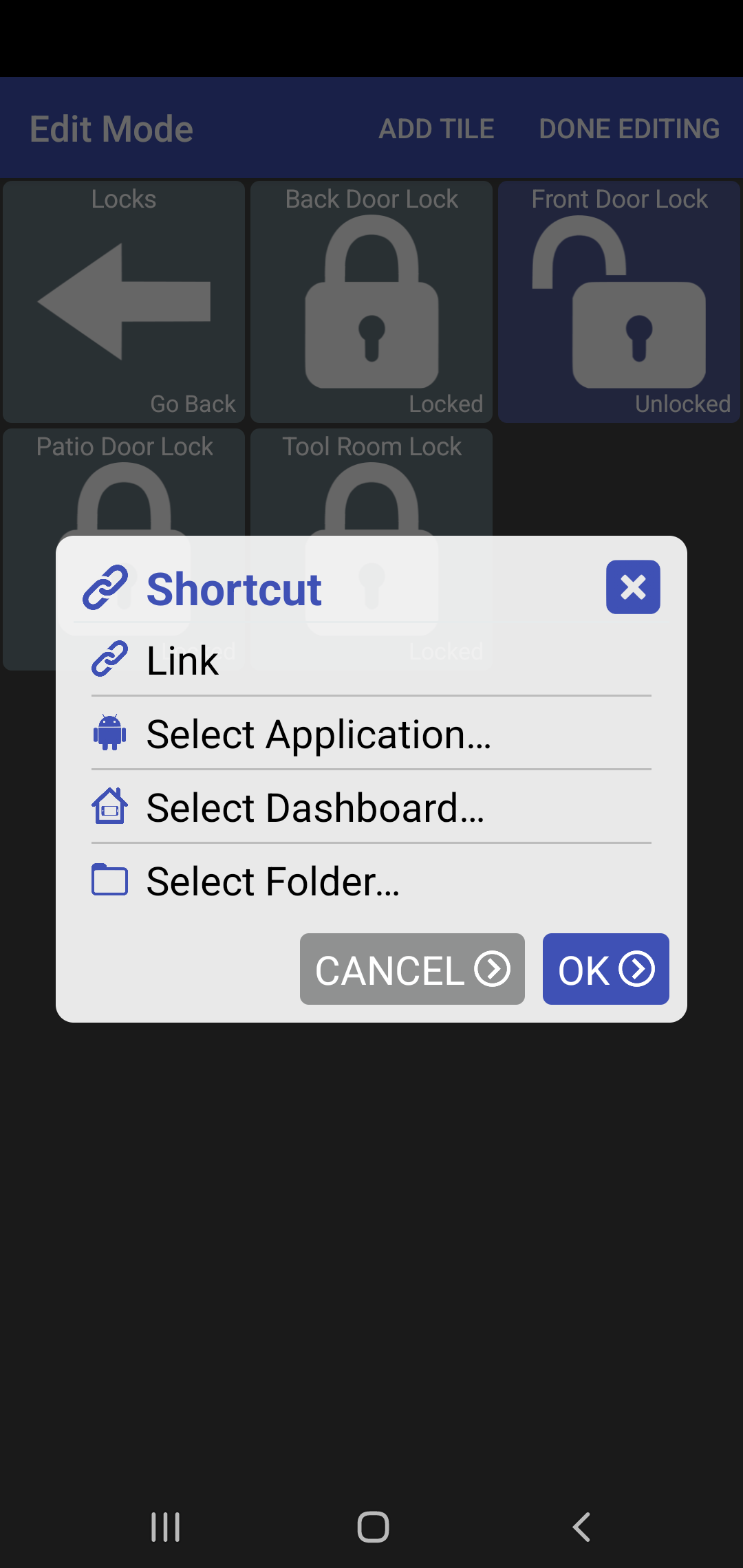

I have a unique dashboard configuration that has several layered folders. It is much easier to return to a default folder with a shortcut than to page back through my folders.
Thank you for the reply. That has given me a great idea using a set of folder shortcuts on the top of the dashboard as well as in each folder. Using the shortcuts should make a "tab" like structure. This us very interesting.
