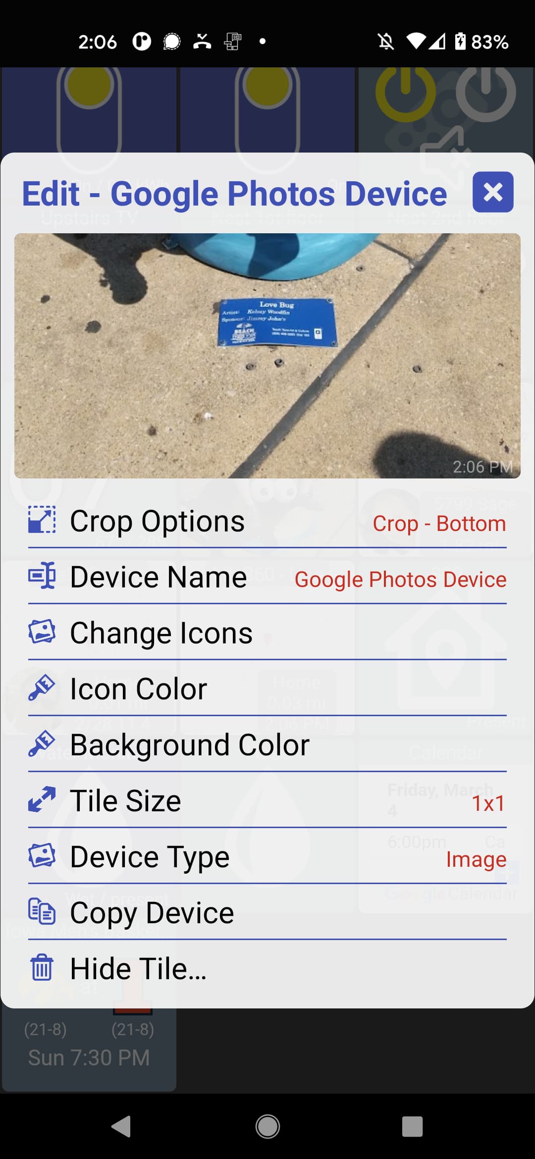

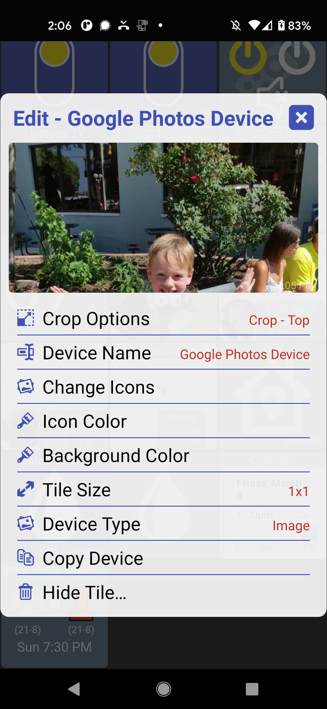

Can you help me reproduce this? You're trying to set a tile icon to fill the entire tile, right? What device type is the tile you're testing?
For the below screenshot I set the tile icon for one of my devices and changed the cropping to "fill tile / no crop". That should use the entire tile size - but because of the 'no crop' option that means the image dimensions should be roughly the same as the tile (meaning - square image for a square tile).
That's why this image "cards.png" (from an above post) looks different depending on the tile size.
I don't doubt there's a bug somewhere.. I remember when testing setting button images seeing some weird behavior where the cropping would change when I scrolled in and out of view..

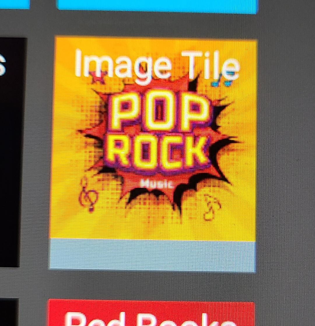

@jpage4500, I appreciate your attention to this. I know this is not a top priority. I have tried many tile types. All of them seem to work the same, cropped images/icons. I would prefer to use the "Image Tile". I have also tried several dimensions/resolutions of images. Most of the time, the image fills the tile as I desire in the "edit" popup menu. But when I close that menu, the bottom of the image in the tile is cropped. Rarely it is not cropped. But when I move that image anywhere, especially on a line with an "Empty Tile", it immediately gets cropped again. Most of my tile images work perfectly on my HD8. I am now working on an HD10 and that may be an issue. I am using a tile size of 1X1. Even images that work perfectly on the HD8 get cropped at the bottom on the HD10. I'm willing to test anything that you would like.
On an older HD10...
On my new HD10

These two tiles are different sizes. I created them exactly the same way. But I moved the lower tile to a folder, which immediately changed it's size and cropped it as you see it. I moved it back to the original location and it remained changed.

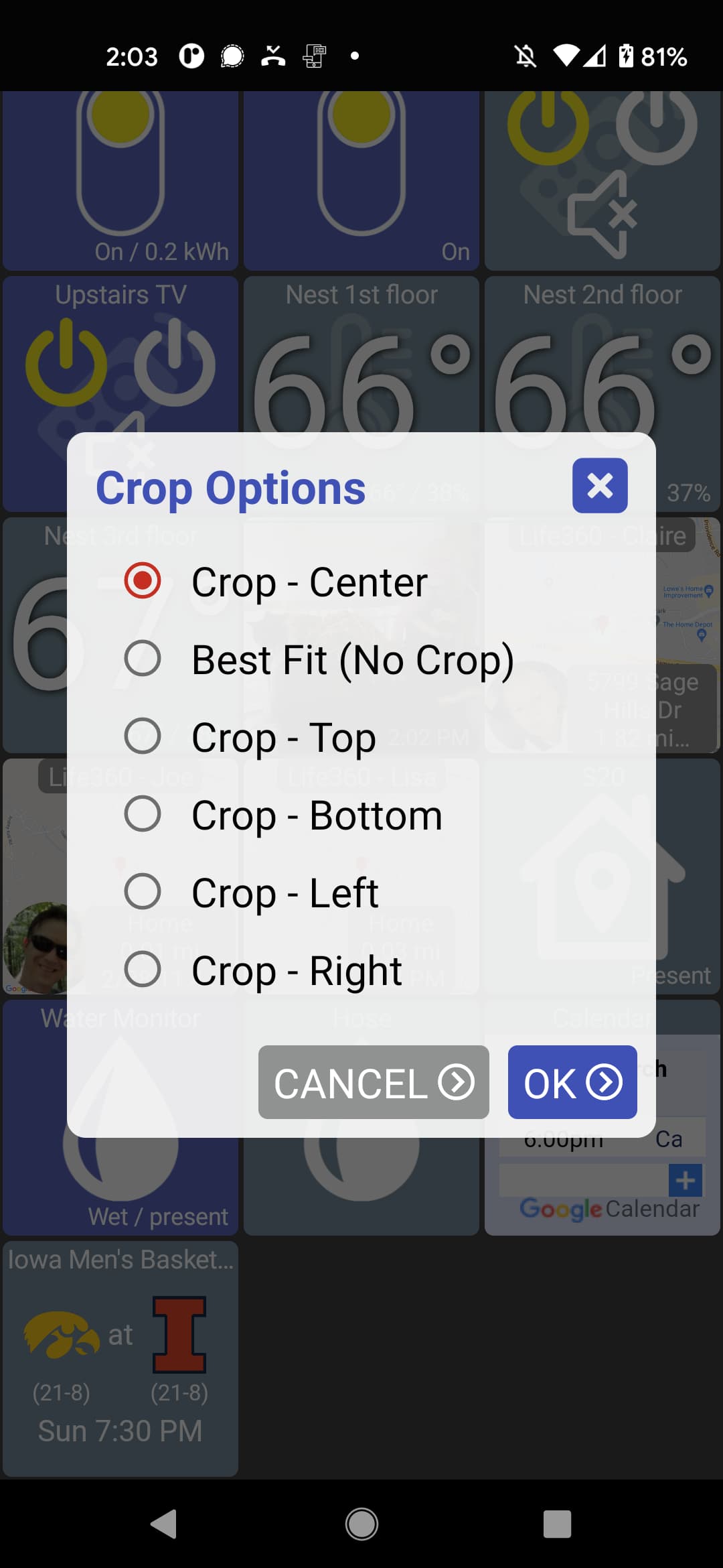

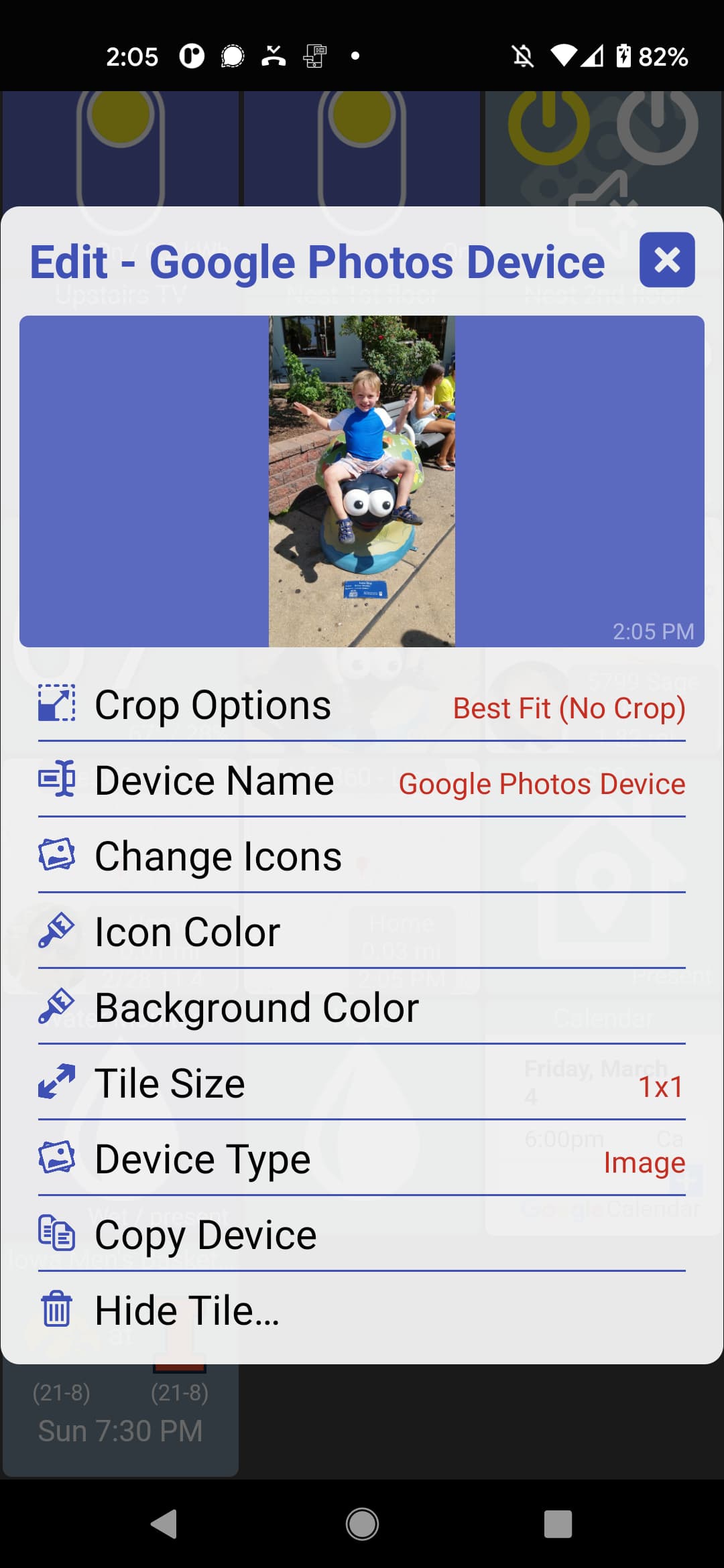

I see.. yes, I think it was the image tile that I was having cropping issues with recently as well. I think the app is caching the image and it's not always obeying the 'crop' options when they're changed. I'll investigate!
I'm curious though.. is this tile supposed to do something when clicked or just for displaying the image? I was thinking this was some virtual device or button that did an action when clicked (ie: played some music station)
I actually didn't realize you could change the 'icon' for an image tile.. that wasn't intended. I think I added the ability to set the tile icon for a video tile and image tiles must have been added by accident.
Anyway, somewhat related but I figured I'd share the cropping options for image tiles here like I did for other device type icons since they're different. I attached some examples below.. note that the examples are showing a 2x1 (wide) tile and would look different on a 1x1 tile but this shows the cropping a little better since the picture is tall and the tile is wide (aspect)
left: [no crop]
right: [crop - center]
left: [crop - top]
right: [crop - bottom]
Yes, I have been using the cropping options to see if I can get the entire tile covered. I sometimes get the changes as expected. But again, if I move the tile, it resorts to the larger tile with the cropped bottom.
Yes, previously, I have been using custom icon images for devices (virtual switches/buttons/etc). But more recently, and with this use case, I am using just an image tile as I just want a permanent image displayed.
Odd....I just created a test device (virtual switch) (the bottom right tile in the first image) and changed the icon image. The tile became the bigger size and cropped at the bottom as before. When I moved that tile up and next to the other similar tile, the tile became smaller and the image filled the tile. I moved it back to the lower right, and it expanded again.
