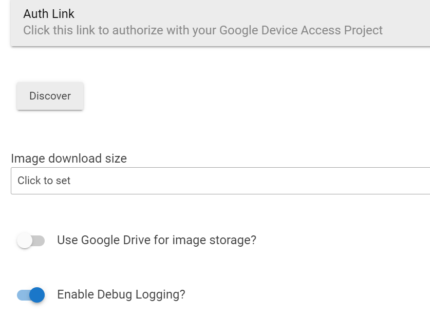

Has anyone else had issues when trying to discover their Nest devices (after the authorization step was completed)? I'm trying to troubleshoot but I'm not sure where the problem is considering there's no feedback or logs entries after clicking the discover button, other than seeing a single "Discovery started" entry. It appears that the authorization was completed successfully.

@curtman3 my first suggestion would be to click through the Auth Link again - there may be permissions that you need to allow for the new doorbell device. Beyond that, please enable debug logs for the App - this will log the raw JSON for each event received from Google, and I can further inspect what may be going wrong.
@minnegopher likewise for you, enabling debug logs for the App will help in troubleshooting. After "Discovery started", we should see "Processing data for ..." logs for each device.

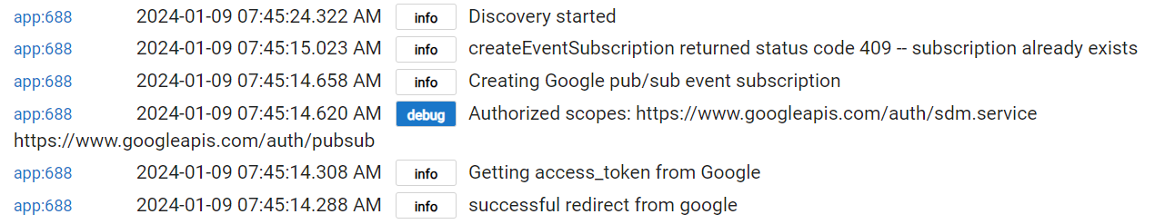

@dkilgore90 Thanks for the help! Not sure if I'm doing something wrong but I'm not getting very useful troubleshooting logs (at least from my perspective). Here's what I get after clicking the Auth Link and then the Discover buttons. Again, the Auth Link sends me to the Google page where I can see my "Home" and can select my two Nest thermostats.
[no further log entries after "Discovery started".]
So, it seems that I'm blowing through handleDeviceList(resp, data) without getting any devices. I didn't see any log messages in the code to capture my issue, so I added a log.warn("$respCode") to confirm that I wasn't getting a respError. The log gave me a "200" which I believe indicates the httpGet is STATUS OK, so it didn't go into the error IF.
Next, I added a log.warn("$respJson") at line 429, to see what is being grabbed by handleDeviceList() since it doesn't seem to be running processTraits(dev, it) as I don't get any log entries including "Process data for $...", as you had mentioned. The $respJson var comes back as "[:]". Therefore, it seems that device.type, device.id, and device.label are null. So, processTraits(dev, it) never runs. Is this the issue? If so, how can I troubleshoot further to get devices into the parser?

@minnegopher your comment that the device list respJson was an empty map jarred my memory a bit... Are these legacy Nest thermostats (gen3 or other model from before the Google branding)? There was an issue that popped up a couple years ago where some thermostats stopped reporting and were no longer discovered in the API -- got lost somewhere in Google's universe. The workaround at the time was to "Reset Works with Nest", though with that program sunset I can't even find that option in my Nest thermostat anymore... If you don't have anything critical set up on Google's side, maybe go the drastic route to reset/remove from your account, then re-add? It sounds drastic, but assuming all permissions have been set during Auth to share the device, I'm running out of ideas ![]()

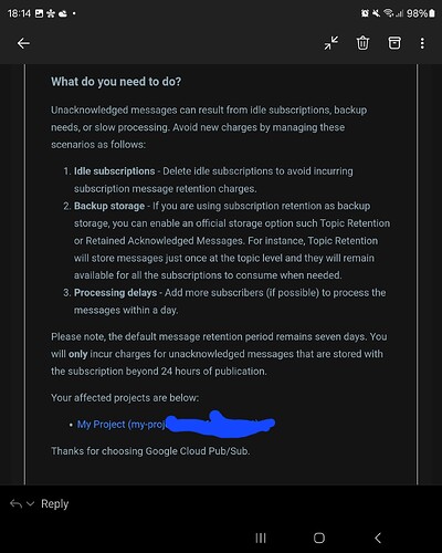

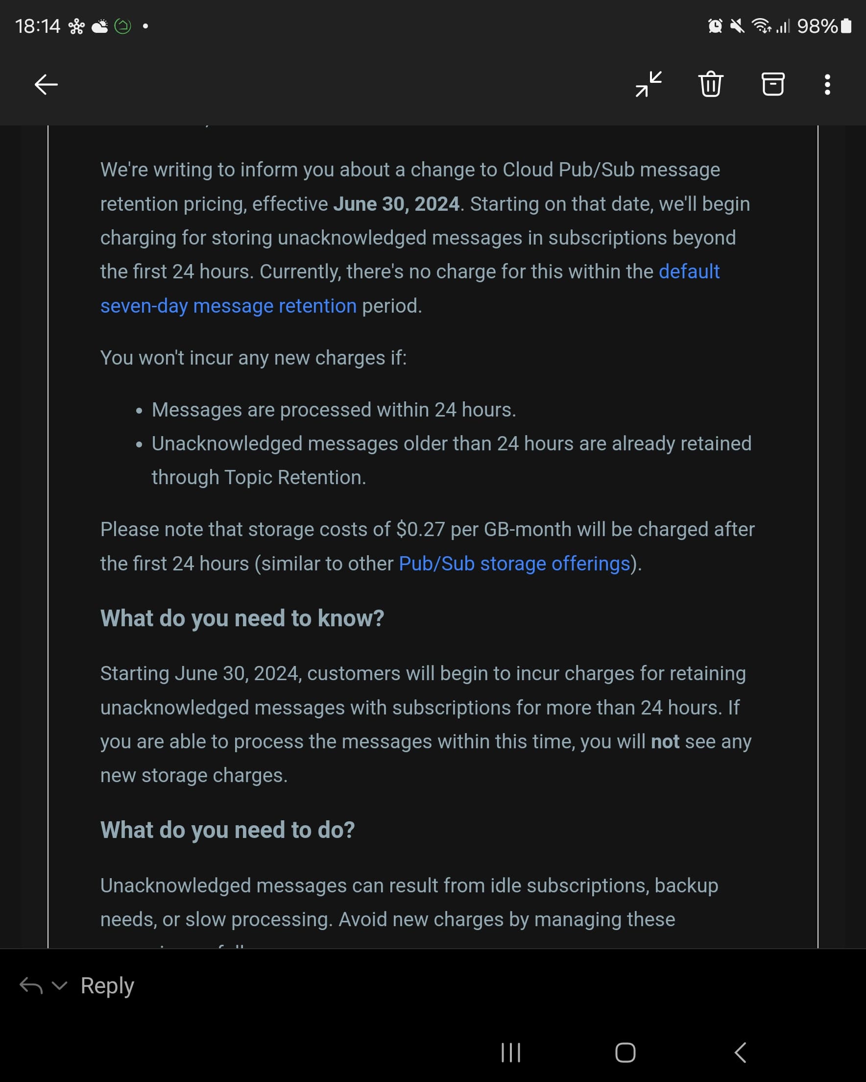

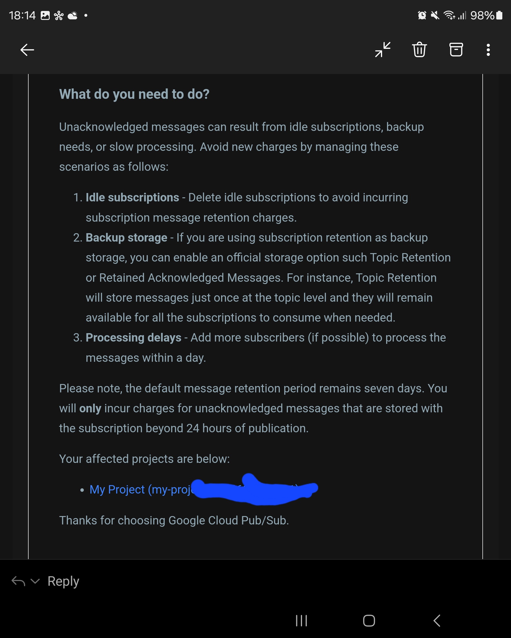

Had this email from Google today.
Can someone confirm if I am likely to incur any costs? I'm hitting the 3 cameras I have quite heavily with live dashboard feeds on Home Assistant as well as more typical use via Hubitat.

I saw the same email, and have checked the settings we are using. For the past 4 years, the event subscription request has explicitly set the messageRetentionDuration to 600 seconds (10 minutes) -- and any long-standing installs which were upgraded from before this was set should have been migrated. Therefore we should not run afoul of this rule with the Hubitat integration (I can't speak to what might be configured on the HomeAssistant side).
I'll double-check if there is anything we can/need to do to detect, audit, and possibly auto-delete idle/stale subscriptions, but those would likely only exist if you have manually tinkered with the API.
