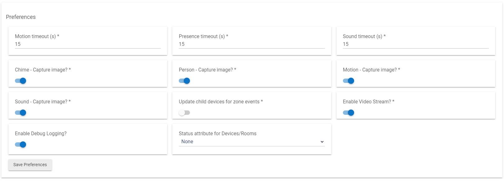

Can you confirm that the new preferences toggle is enabled on the Parent device?
If so, please enable debug logs for the App, and post/message me with events that you expect should update the zones. We should see a zones array in the Google event for the devices.
Note: This is an undocumented feature of the API, and seems to only work for Google-branded devices (legacy Nest excluded).

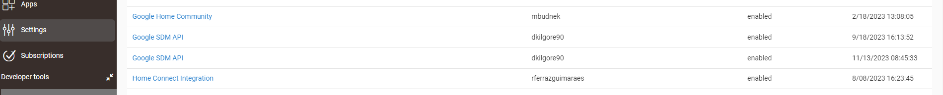

Hi there
I've just noticed that I have two sets of Applications Installed in "Apps code"
One is version 1.0.8 and the other is 1.1.0 if I try to remove the earlier version it says
Do you know of a way to correct this? I'm assuming its the root cause is possible from this and I have installed the newer drivers but the App actually running on the hub is still the older version?
Regarding your questions.....
That option is ticked for both devices - I have removed the child device for the Security Camera to see if it is automatically re created upon an event (your instructions above indicate it would?).

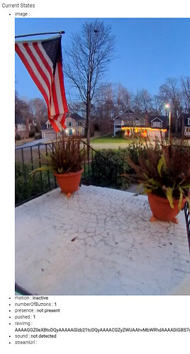

Logs from the Doorbell Parent Device are below
dev:9032023-11-14 14:54:30.928debugDoorbell: updating state -- videoFormat: WEB_RTC
dev:9032023-11-14 14:54:30.917debugDoorbell: updating state -- imgHeight: 1200
dev:9032023-11-14 14:54:30.867debugDoorbell: updating state -- imgWidth: 1920
dev:9032023-11-14 14:54:30.856debugDoorbell: updating state -- captureType: clip
dev:9032023-11-14 14:54:30.845debugDoorbell: updating state -- room: Home
dev:9032023-11-14 12:27:53.496debugDoorbell: updating state -- videoFormat: WEB_RTC
dev:9032023-11-14 12:27:53.485debugDoorbell: updating state -- imgHeight: 1200
dev:9032023-11-14 12:27:53.474debugDoorbell: updating state -- imgWidth: 1920
dev:9032023-11-14 12:27:53.464debugDoorbell: updating state -- captureType: clip
dev:9032023-11-14 12:27:53.453debugDoorbell: updating state -- room: Home
dev:9032023-11-14 12:27:51.927debugDoorbell: Sound -- not detected
dev:9032023-11-14 12:27:51.892debugDoorbell: Motion -- inactive
dev:9032023-11-14 12:27:51.859debugDoorbell: Person -- not present
dev:9032023-11-14 12:27:40.117debugDoorbell: after remove - current active threads:[]
dev:9032023-11-14 12:27:40.115debugDoorbell: b1329ba5-841e-4a56-b6b3-e74c769132de ended -- marking events inactive: [person]
dev:9032023-11-14 12:27:40.111debugDoorbell: Person -- not present
dev:9032023-11-14 12:27:21.295debugDoorbell: after append - current active threads:[b1329ba5-841e-4a56-b6b3-e74c769132de]
dev:9032023-11-14 12:27:21.293debugDoorbell: person event is active in thread: b1329ba5-841e-4a56-b6b3-e74c769132de
dev:9032023-11-14 12:27:21.289debugDoorbell: Person -- present
dev:9032023-11-14 12:08:34.809debugDoorbell: updating state -- videoFormat: WEB_RTC
dev:9032023-11-14 12:08:34.799debugDoorbell: updating state -- imgHeight: 1200
dev:9032023-11-14 12:08:34.789debugDoorbell: updating state -- imgWidth: 1920
dev:9032023-11-14 12:08:34.779debugDoorbell: updating state -- captureType: clip
dev:9032023-11-14 12:08:34.768debugDoorbell: updating state -- room: Home
dev:9032023-11-14 12:08:33.420debugDoorbell: Sound -- not detected
dev:9032023-11-14 12:08:33.385debugDoorbell: Motion -- inactive
dev:9032023-11-14 12:08:33.353debugDoorbell: Person -- not present
dev:9032023-11-14 12:08:28.082debugDoorbell: after remove - current active threads:[]
dev:9032023-11-14 12:08:28.080debugDoorbell: 91ec42b6-9ca1-418f-8ac2-1dbd5dba975d ended -- marking events inactive: [person]
dev:9032023-11-14 12:08:28.077debugDoorbell: Person -- not present
dev:9032023-11-14 12:08:07.946debugDoorbell: after append - current active threads:[91ec42b6-9ca1-418f-8ac2-1dbd5dba975d]
dev:9032023-11-14 12:08:07.944debugDoorbell: person event is active in thread: 91ec42b6-9ca1-418f-8ac2-1dbd5dba975d
dev:9032023-11-14 12:08:07.942debugDoorbell: Person -- present
dev:9032023-11-14 12:08:02.963debugDoorbell: after append - current active threads:[91ec42b6-9ca1-418f-8ac2-1dbd5dba975d]
dev:9032023-11-14 12:08:02.961debugDoorbell: person event is active in thread: 91ec42b6-9ca1-418f-8ac2-1dbd5dba975d
dev:9032023-11-14 12:08:02.958debugDoorbell: Person -- present
dev:9032023-11-14 12:08:02.946debugDoorbell: Doorbell/chime pressed
dev:9032023-11-14 12:04:28.927debugDoorbell: updating state -- videoFormat: WEB_RTC
dev:9032023-11-14 12:04:28.916debugDoorbell: updating state -- imgHeight: 1200
dev:9032023-11-14 12:04:28.904debugDoorbell: updating state -- imgWidth: 1920
dev:9032023-11-14 12:04:28.894debugDoorbell: updating state -- captureType: clip
dev:9032023-11-14 12:04:28.883debugDoorbell: updating state -- room: Home
dev:9032023-11-14 12:04:27.099debugDoorbell: Sound -- not detected
dev:9032023-11-14 12:04:27.067debugDoorbell: Motion -- inactive
dev:9032023-11-14 12:04:27.025debugDoorbell: Person -- not present
dev:9032023-11-14 12:04:16.150debugDoorbell: updating state -- videoFormat: WEB_RTC
dev:9032023-11-14 12:04:16.140debugDoorbell: updating state -- imgHeight: 1200
dev:9032023-11-14 12:04:16.130debugDoorbell: updating state -- imgWidth: 1920
dev:9032023-11-14 12:04:16.119debugDoorbell: updating state -- captureType: clip
dev:9032023-11-14 12:04:16.109debugDoorbell: updating state -- room: Home
dev:9032023-11-14 12:04:14.332debugDoorbell: Sound -- not detected
dev:9032023-11-14 12:04:14.298debugDoorbell: Motion -- inactive
dev:9032023-11-14 12:04:14.254debugDoorbell: Person -- not present
dev:9032023-11-14 12:04:10.805debugDoorbell: after remove - current active threads:[]
dev:9032023-11-14 12:04:10.803debugDoorbell: ab5e3cb7-12d1-455a-be35-7396902c1cd6 ended -- marking events inactive: null
dev:9032023-11-14 12:04:10.800debugDoorbell: Person -- not present
dev:9032023-11-14 12:04:09.673debugDoorbell: updating state -- videoFormat: WEB_RTC
dev:9032023-11-14 12:04:09.662debugDoorbell: updating state -- imgHeight: 1200
dev:9032023-11-14 12:04:09.651debugDoorbell: updating state -- imgWidth: 1920
dev:9032023-11-14 12:04:09.640debugDoorbell: updating state -- captureType: clip
dev:9032023-11-14 12:04:09.624debugDoorbell: updating state -- room: Home
dev:9032023-11-14 12:04:07.663debugDoorbell: Sound -- not detected
dev:9032023-11-14 12:04:07.626debugDoorbell: Motion -- inactive

Yes, your logs look good - we can see the zone data in the event from Google. I think you've isolated it, running the older App code, which does not pass the zone data to the Driver for processing.
Probably the duplicate was the effect of HPM, perhaps you could try a "repair" in there. Or under Apps Code, delete the newer (not in use) App definition, and edit the 1.0.8 version - paste in the newer raw code and Save
That definitely seems to have progressed things.
The HPM repair didnt change anything but a copy and paste of the code from the new to the old and then a hub reboot has had an affect.
The Security Camera now has a child device and the logs tie up to when I walk outside, which is good.
