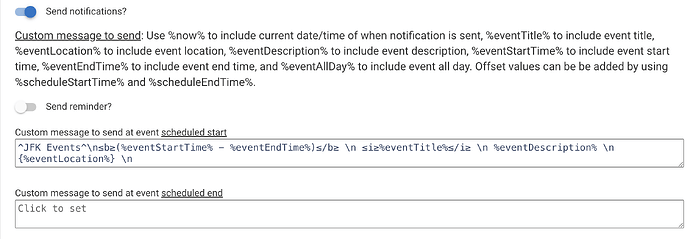

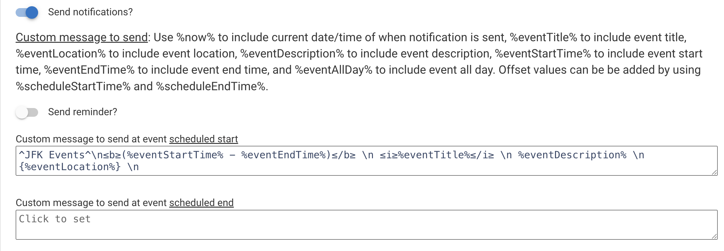

There are two (and an untested third) ways to do this:

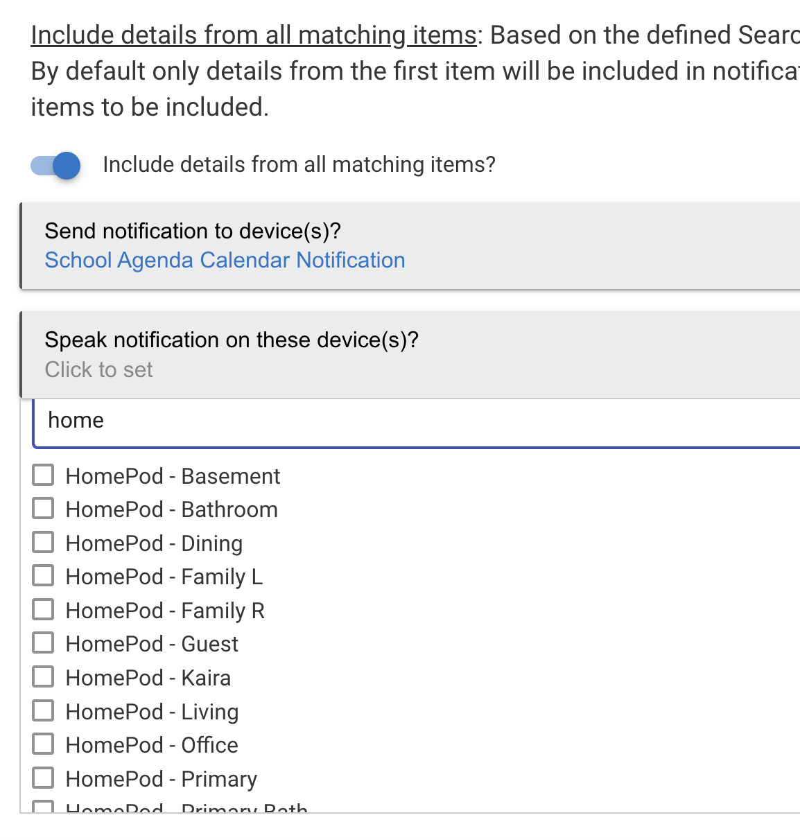

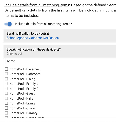

  1. after turning on "Include details from all matching items?", format the notification for listenability under "Custom message to send..." This calendar search triggers once a day and sends me all events for the next 72 hours.
Then have the notification sent directly to the Sonos under "Speak notification on these device(s)?". I don't have a Sonos, so I'm showing a list of HomePods.
  1. If you need to further manipulate the notification, send the notification to Notification Tile (driver) by thebearmay. The device seen above (School Agenda Calendar Notification) uses a personally modified version of that driver to save only ONE message (which may include multiple calendar events) and preserve/add/modify HTML formatting in my messages. The notification gets saved in as an attribute in that notification device. I have a rule to trigger when that attribute changes and then fire a message to relevant pushover devices. In your case, you should be able to use WebCore to pull the list of events.

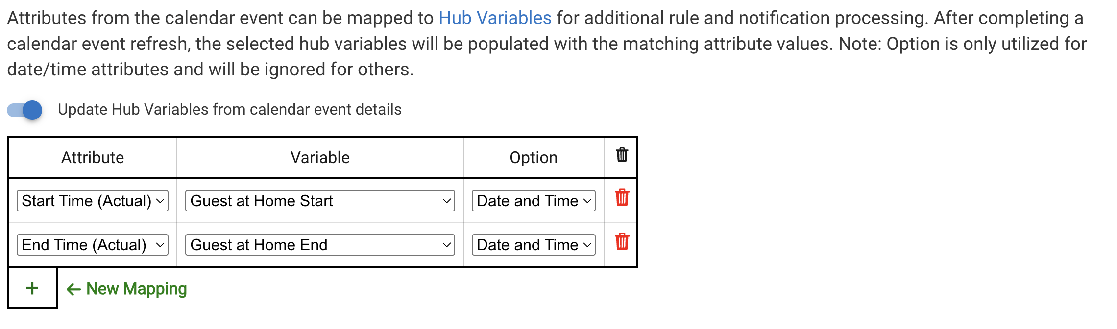

  2. save information directly into hub variables. However, I don't know how it would work with the available variable options and multiple events.

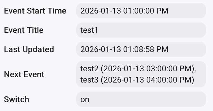

Now in front of my computer allowing me to include screenshots. This setting, within the child switch section, should meet your needs:

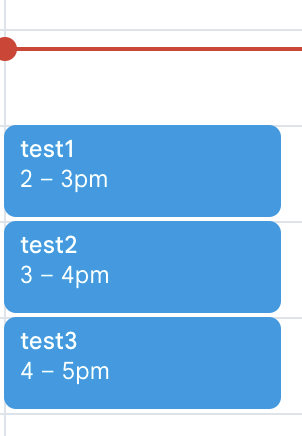

I setup a few test events in my calendar:

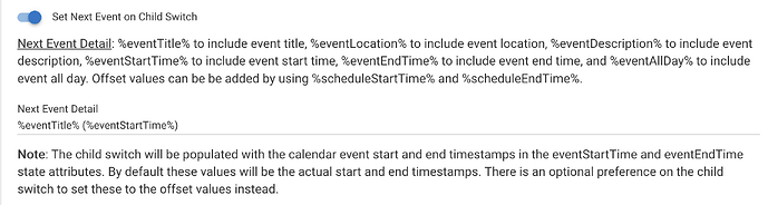

Within the child switch the first event populates within the state variables but the other events found show up within the nextEvent variable based on how you set it up within the search trigger:
As @neerav.modi mentions a notification device can be a TTS device such as Sonos. So you wouldn't need the webcore piston to invoke this as you can use the schedule settings within the search trigger to run this as your preferred times. A few community members use this app for things like trash notifications the eventing before collection.

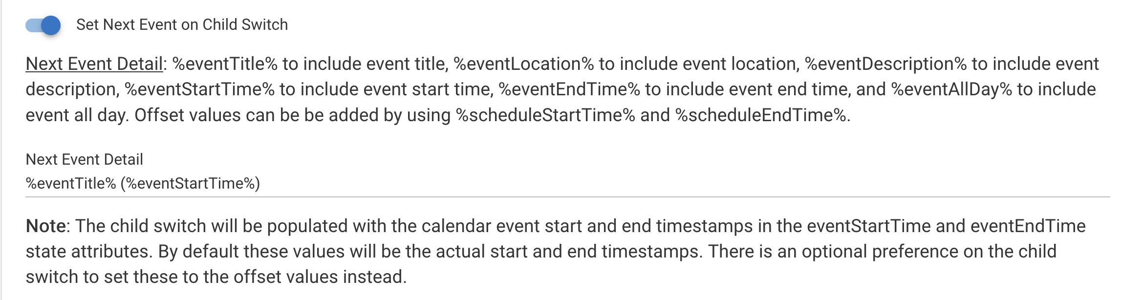

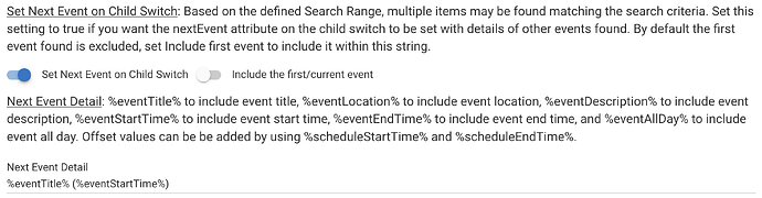

What are your thoughts on the Next Event functionality where you can specify the event variables to include? I could enhance that with an additional setting to include the first/current event too and again you would specify the variables to include to make that concatenated string.
"That sounds like a perfect solution! Including the first/current event into a consolidated string and allowing me to choose the variables (like time and title) would be a game changer using TTS.
If you could provide a single attribute that contains all events from the current search results in one formatted string, it would make the webCoRE logic incredibly simple. Thank you so much for considering this enhancement!"
Thanks for your help with this and all your hard work.

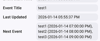

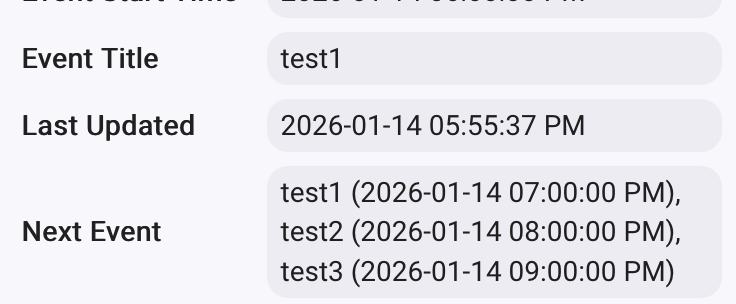

That was pretty easy coding wise. New setting:
Results in child switch:
Heading out to dinner but I should get it posted to Github and HPM by EOD tomorrow.
