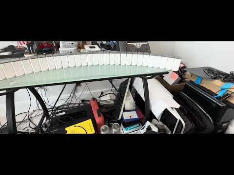

Well this app has been fantastic. For those who want an idea of what can be done here is my use case.
I have clients whom own unmanned facilities that allow customers to reserve 24/7. The issue was all the technology in the space is on 24/7 to accommodate this causing issues like $6k projectors to die prematurely etc. So what I am building for them is a hubitat controller --> Gcal search app --> monitor a calendar and powers on the equipment 5 min before their start time and power off 5 min after end of time. To get the data into the calendar I have scripts that parse the emails and format the calendar event properly for hubitat to interpret. Its working fantastically ! I have added a fun little video of me messing around with a bunch of plugs for an order I just finished for your entertainment :slight_smile:
Thank you for all to contributed to this app !
