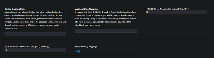

Can you explain how to use the Group Member settings? I can't find any documentation on it.

The config for my Zooz switches explains it pretty well. Make sure to use the "device network ID" when setting these up.
