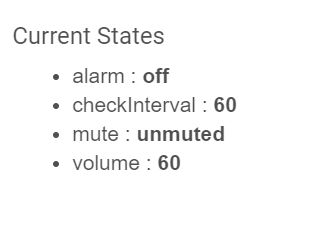

The issue is its not showing up in the device. See screen shot attached. Doesn't look like the javascript is running on the fire 8 hd.

Tablet 1 :
Tap SS8 Q Bathh attribute
Tablet 2:
Tab A - King Bath attribute
I try click on Configure, Ping, Save Preference ...on page Tablet 2 but Battery Level, Motion ... not show up.

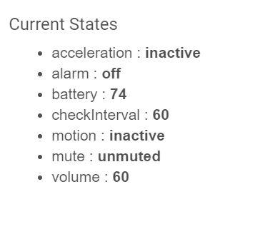

OK, I find out : Exit Fully, reboot tablet, turn On Fully, hit Ping, Confiure. Current States on Tablet 2 now :
Tab A - King Bath attribute 2
Thanks a lot for this great driver.

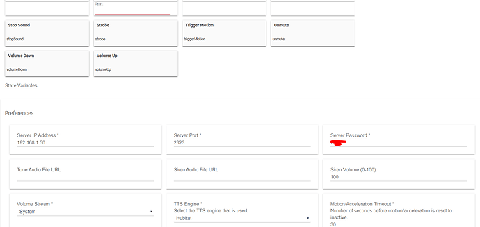

Please check on both your tablet, phone and Devices page on HE : Server Password .

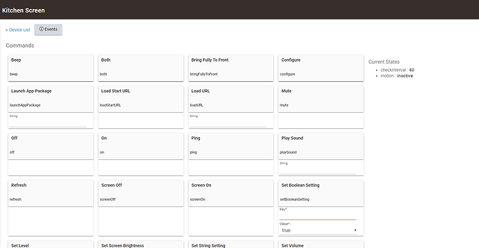

OK I have set this aside for the last few months, but I am back trying to get this to work. I have updated the code and am still having the problems mentioned above from my February post. I have checked and double checked all my FKB and FKBC setting numerous times. No Luck.
Can anyone who has this running on a Fire tablet HD8 help me here. Might there be some settings in the Tablet settings themselves, outside of FKB or FKBC that i should be checking which might interfere with this functionality?
LJ
EDIT: Here are the logs after hitting the Configure button on the FKBC device screen. It looks like some of the communication may be successful, but the logs aren't entirely clear on that, at least to my untrained eye

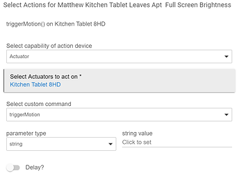

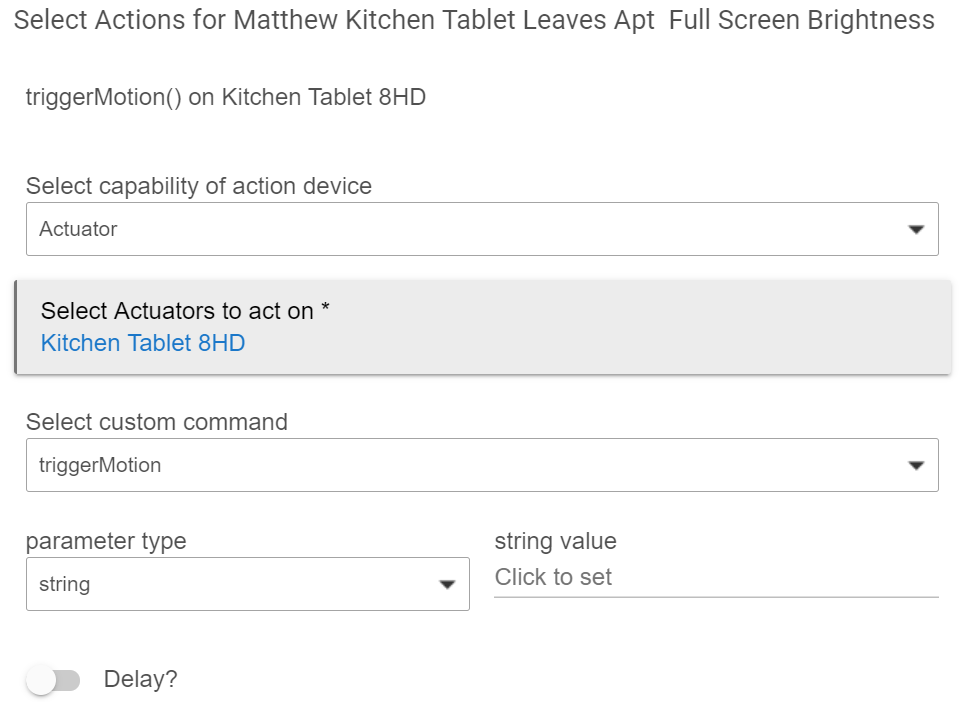

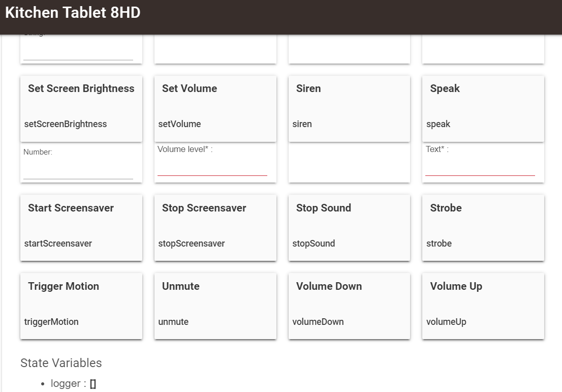

Trying to set up a motionTrigger command and can't seem to make it work. Any one know what Parameter Type it is looking for to make it run in Rule Machine?
All I get is this no matter what I use for parameter type or even if I leave it blank.
I want the screen to turn on when my rule changes. I have the tablet set up to blank the screen after a certain time of no motion. It works fine if I click the Trigger Motion button in the Tablets Fully Kiosk Browser Controller Driver.
