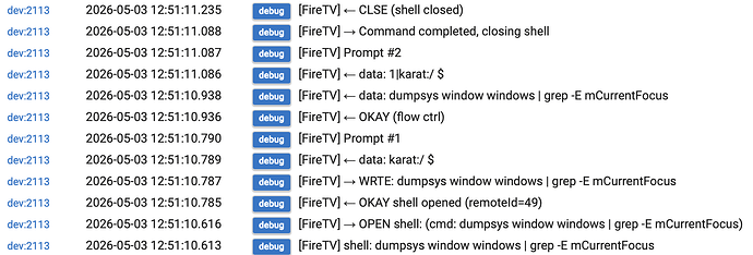

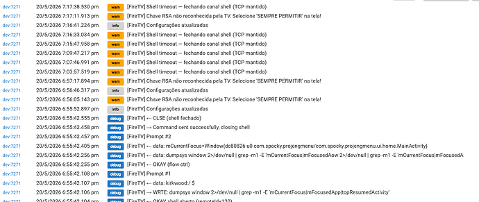

Not sure if you are also getting the intermittent prompts to re-authorise allow USB debugging (even after selecting always allow) ?
Logs
As this is working on Android TV - probably best to change title to reflect this :grinning:

I was already testing this version.
Unfortunately, the repeated prompts still persist.

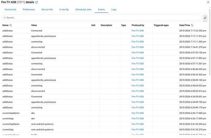

Logs
Hi @iEnam - I did an update to try prevent the popups.
Code in github
Let me know.

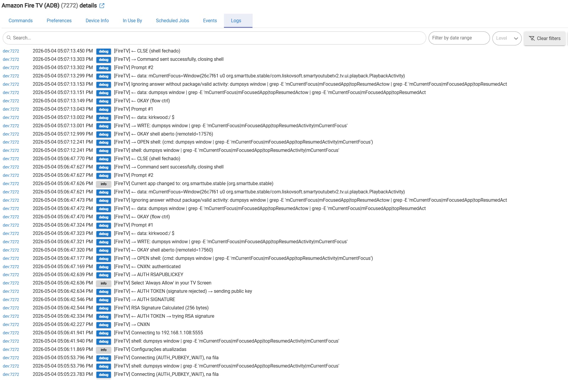

Thanks for the update - this is working much better now, so far it has not failed, apart from the two exceptions below :slight_smile:
During this quick test, I've noticed a few issues relating to adb and other button functions:
  1. Saving preferences resets ADB authentication
  2. Reboot also resets ADB authentication - not sure if this can be fixed?
  3. Seems to be keeping authentication with Internet blocked, will need to test longer.
  4. English language text needs further improving
  5. Launch Prime Video and YouTube not opening for me (Google TV Streamer); Netflix and Disney Plus working.
