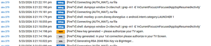

Hello, Thanks for you work on this! Unfortunately, I am unable to get it working. I've enabled adb debugging (and installing unknown apps). I've entered the correct IP for my Fire TV 4k (1st gen) into the device. However, I'm never asked to allow connections when I click on a command (and no commands work). I've tried clicking on Generate New Key, but still am not asked to allow. I'm running a C8Pro, latest firmware. I'm using v1.4 of your driver. Logs from my last attempt to generate a new key are:
Thanks!

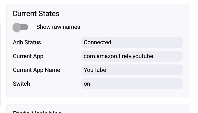

I just published an updated version which fixes the ADB Handshake, and also shows the current app playing.
You can get it in the link from my github repo.
