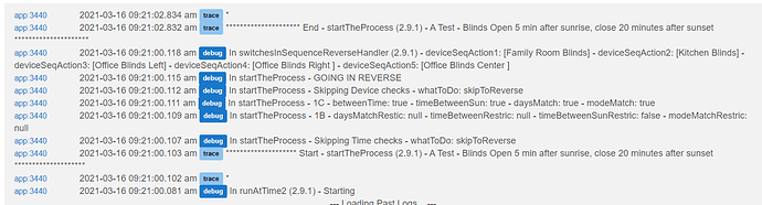

And interestingly, the cog just ran the sunset part and closed all my blinds at about 9:20 AM. So something about detecting sunset/sunrise appears to be off...

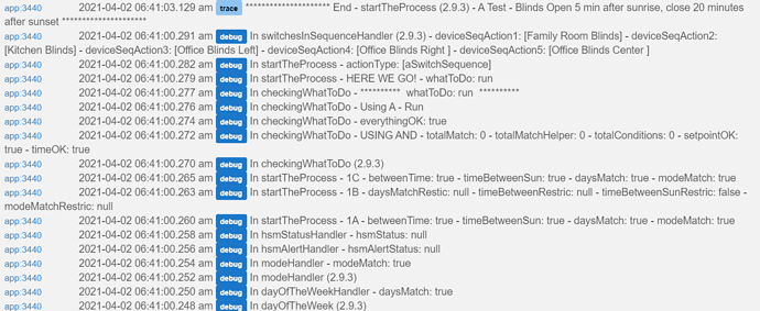

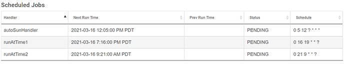

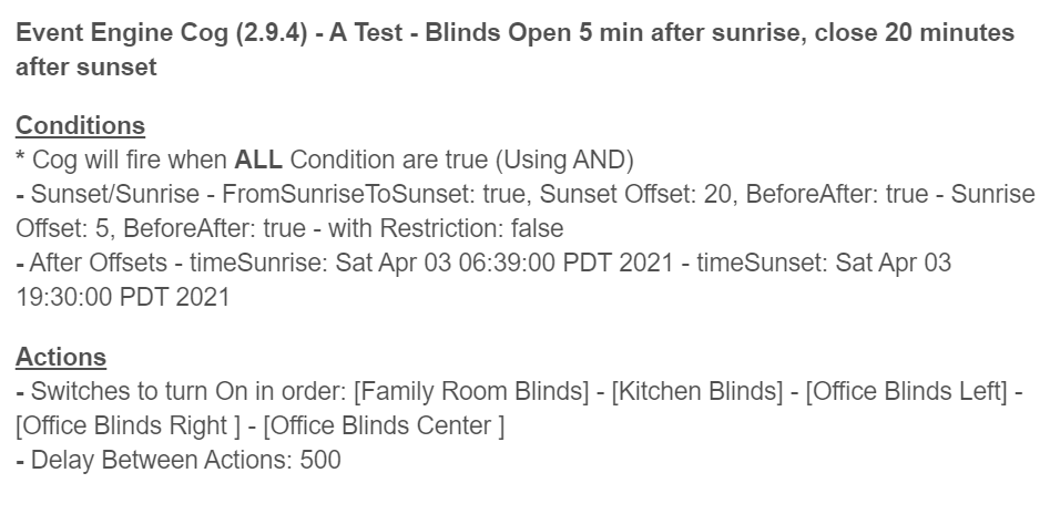

@bptworld - Just a heads-up, my Sunset-Sunrise automation still wasn't working when tested with 2.92. Seems like EE can't figure out the Sunrise/Sunset time accurately.
No worries, no hurry, realize you're busy, but wanted to provide feedback on the current version. Take it eaey.
Thanks for the update. I've re-enabled the cog and it's set to run tomorrow AM, five minutes after sunrise. I'll be up just a bit later than that to check on things.
2.9.3 actually seems to have worked just fine for the Sunrise (open/on) part of the cog. All five blinds were open when I got up (they are set for 5m after sunrise)! Yay.

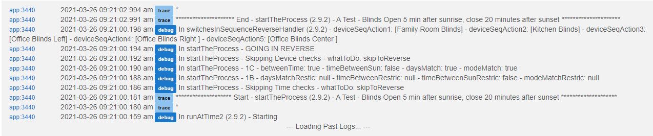

W/2.94 the cog didn't run at 5 min after sunrise this AM. There isn't anything in the logs from EE at that time this AM when the cog should have run (5 min after sunrise).

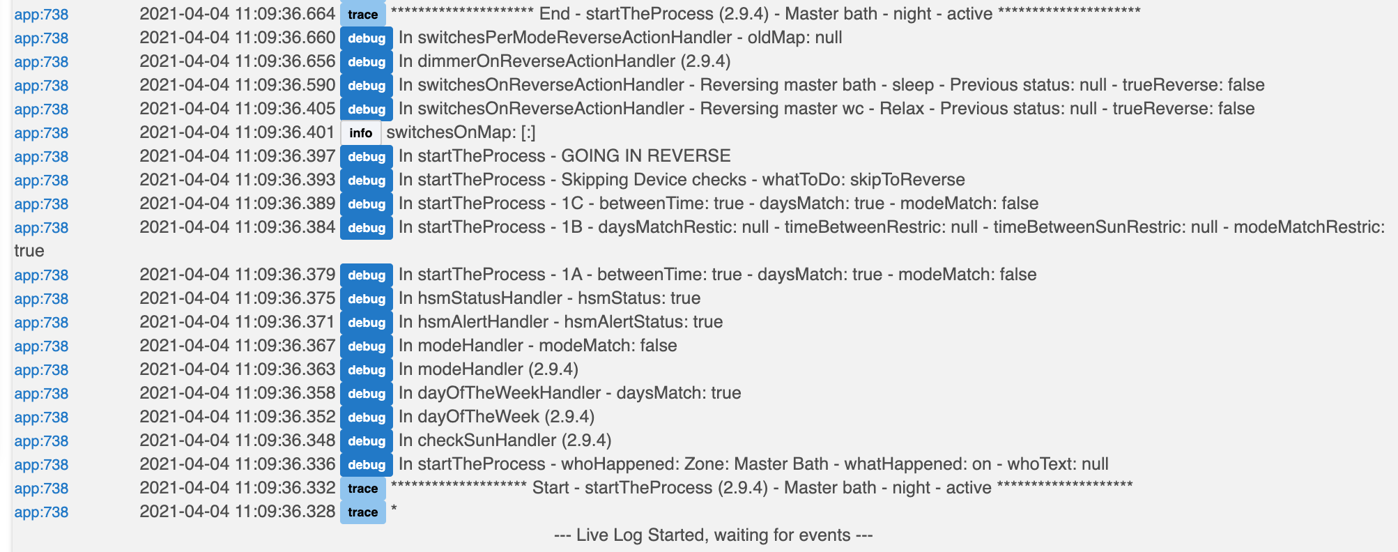

This one has a mode restriction, and is reversing when the mode restriction doesn't match.
Result for my setup is the cog that matches the current mode turns my lights on and then this one that is setup for a different mode reverses and immediately turns the lights back off.
I have basically motion activated lights (slightly more complex than that, but the same basic idea) where activity turns on a virtual switch and then I want different Hue scenes to turn on depending on the mode. I have this setup with separate cogs for each mode that turns on the desired scene.
What I expect: If mode (as restriction) doesn't match current, don't do anything.

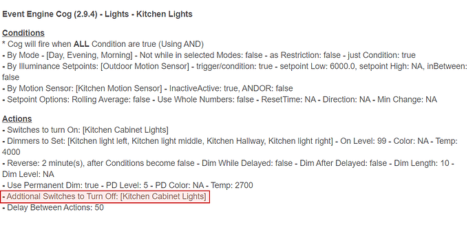

Not sure if I have the same, but a similar one. I have a cog that should turn off an additional switch when it reverses, but this is no longer happening. It worked fine until suddenly. The only thing I have done is to add some other cogs, but disabled them again as I thought perhaps they played a part in this behaviour.
I am running version 2.9.4.

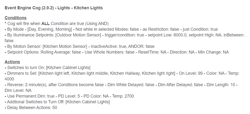

To test out this theory, I re-installed 2.9.3 and that works a charm, so some issue was introduced in 2.9.4.
This is my Cog (The Off option was not working in 2.9.4).
@bptworld - rolled back to 2.9.3 a couple nights ago, and woke up to all five blinds open as expected the last two mornings. Last night (the first evening w/the closing controlled by the cog) all but one blind closed. So 2.9.3 seems to be mostly working for me, assuming that the one blind not closing could have been a mesh issue. So 2.9.4 did not work for me, but 2.9.3 seems to be good. Thanks!
Update: At close time tonight four of the five blinds closed. Seems like the blind is getting "sleepy" as when I went to its device page it was slow to respond to an open command and require two clicks on the Open button for it to open. Once "worken up" it was normally responsive...
Update 2: All five blinds opened this AM.
Update 3: (Aren't you all on pins and needles!?) All five blinds closed in order.

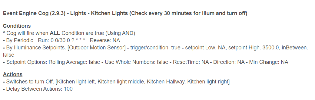

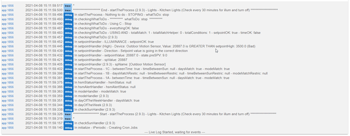

Here is another issue I am facing. Not sure if it is a bug or stupidity. I am trying to read Illumination every 30 minutes, and if higher than 3500 lumens, I would like to turn off some lights. This does not work. It is entirely plausible that I am doing it incorrectly, but not sure what to fix then ?
I've actually never used the periodic feature, so not really familiar w/that. As long as you've confirmed your periodic statement is correct, what you're doing looks OK to me.
